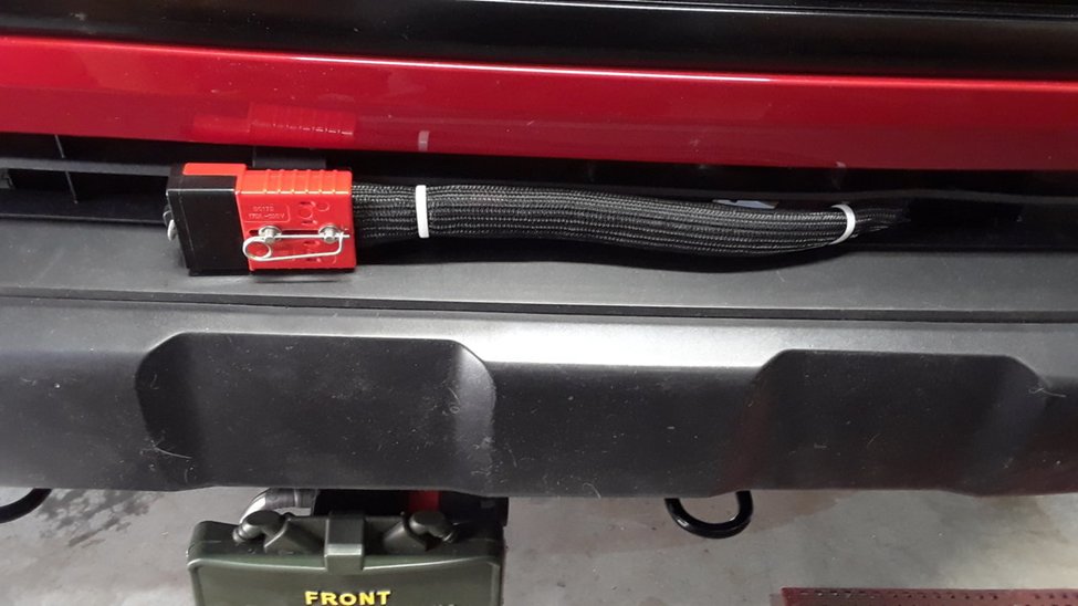

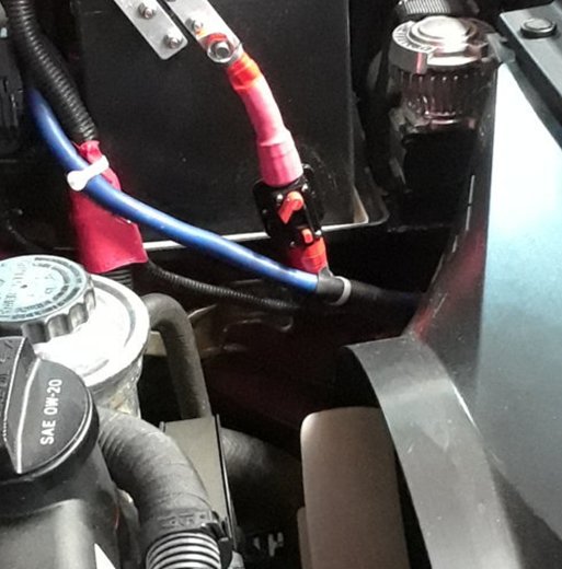

    Nice.
    I did similar.
    Be sure to add some type of disconnect to the cables under the hood. Just so some asshole doesn't decide to short across the connectors and ruin your battery.

    That's an interesting point I didn't consider. I mean, it kinda defeats the point of having it if I still have to pop the hood. I wish that wasn't a reality of the current state of society

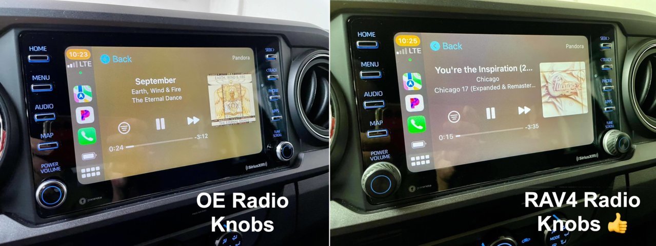

    BIG mod today! Swapped out the little Taco radio knobs for the beefy RAV4 Prime radio knobs (PN 90010-23059). ;) Just have to pop out the small bit of plastic on the back of the RAV4 knob and they slip right on. Easy peasy. Most of the time was taken up fishing out one of the old knobs that fell between the center console and the driver's seat. :annoyed: :rofl:

    I agree totally.
    I keep it disconnected around city/public areas;
    But then when heading out into the wild - I connect it and have it ready to go without having to pop the hood again.
