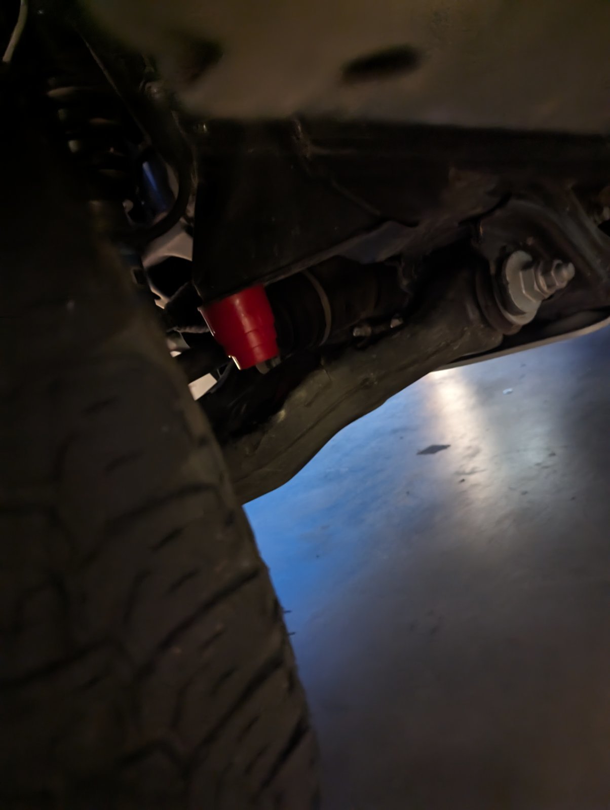

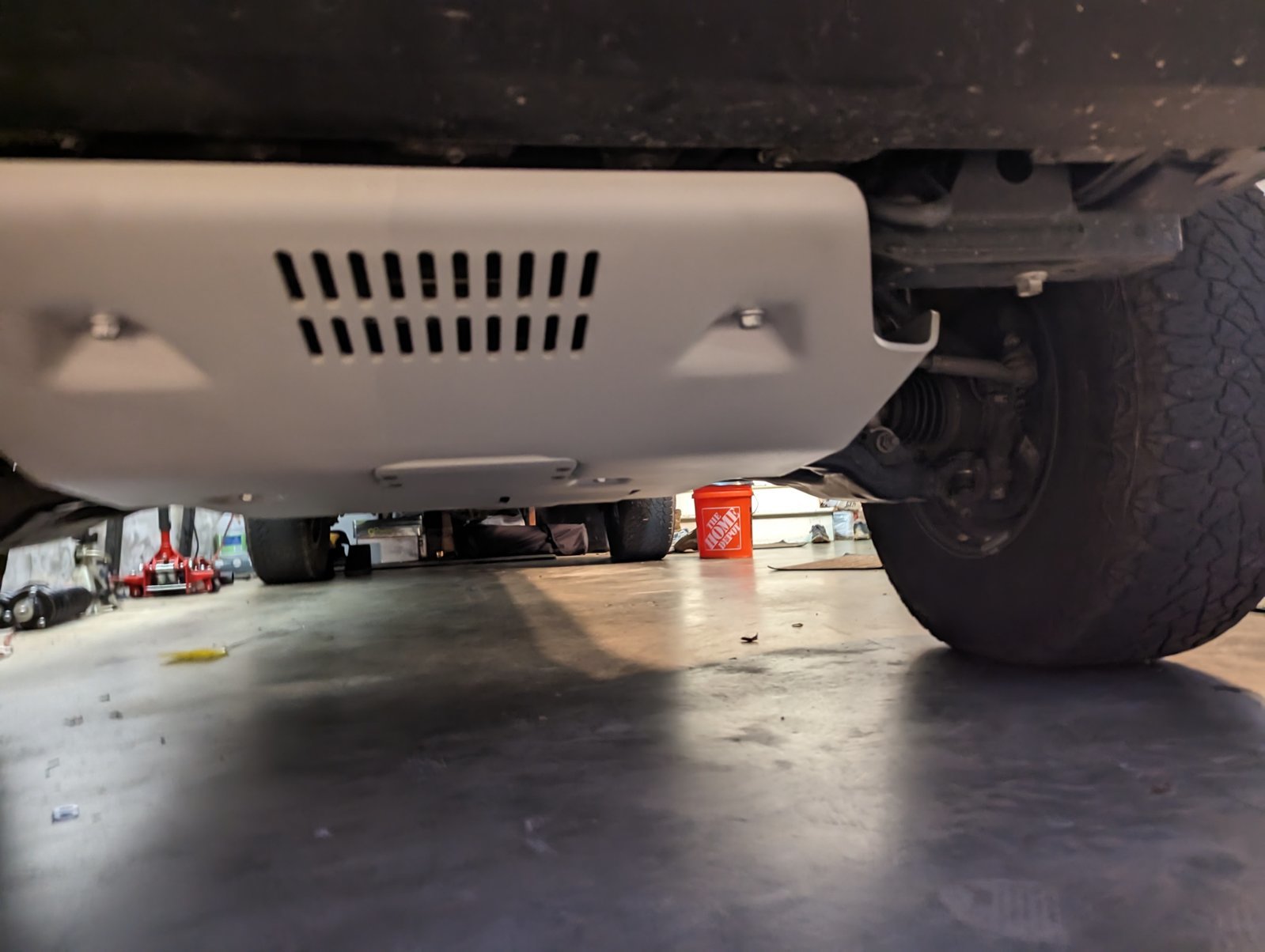

    Added the Amazon skid plate. I can understand why people have issues installing. Bolt order is important but for the price and protection it fits the bill.
    Replaced front bump stops with poly bushings

    I'd heard the bolts were laid out wrong. Once those are fixed, how is it? Did everything line up correctly?

    i dont know if that was the issue the instructions werent clear on the bolt locations. the way it worked out Middle are the longest bolts and spacer, the rest are easy to guess. The middle pair of bolts are in holes that are not elongated once i used those as a guide the perimeter (front and back) all worked out. i tried the perimeter first which are elongated but found it impossible to get the middle bolts to thread. The bolts also suck, the oem bolts you take out have a narrower nose that helps you line up the threads and these dont.

    I guess the two most important follow up questions are 1. how long did it take to install and 2. would you do it again? I want to order it and install it at my first oil change but have been hesitant because of some reviews.

    1. it took me 2 hours + and that was switching bolts and spacers mixing and matching. Pre threading the bolts in the holes (this made it alot easier when it came time to tighten them down. 2. Yes, now that i understand how to do it i think i can have it done in 45 minutes. Its pretty thick and compared to the stock one is alot beefier. My wife bought it for me for my birthday yesterday.

    message me if you have any questions. as long as you start with the middle holes, then the rear and finally the front. then snug them all down

    I may take you up on that. I just ordered it. There are several reviews that say to swap the front and middle bolts/spacers and that fixes most of the issues. So I have my fingers crossed that makes this not too difficult or require any fab'ing. There is a sale currently on it so I paid $161.55 for it (plus tax).

    oh also the bolt sizes are wrong i think i ended up with 10/15mm the instructions said 12/17mm

    Would it be best to replace the bolts with SS from the hardware store or use what comes in the kit? I've seen some say they ordered the OEM bolt kit which is like 60 bucks!

    i think running them in the holes before fixes the feeling that you might be cross threading and makes it go smoother (atleast it did for me) You can choose to buy the hardware but i dont think its necessary.
