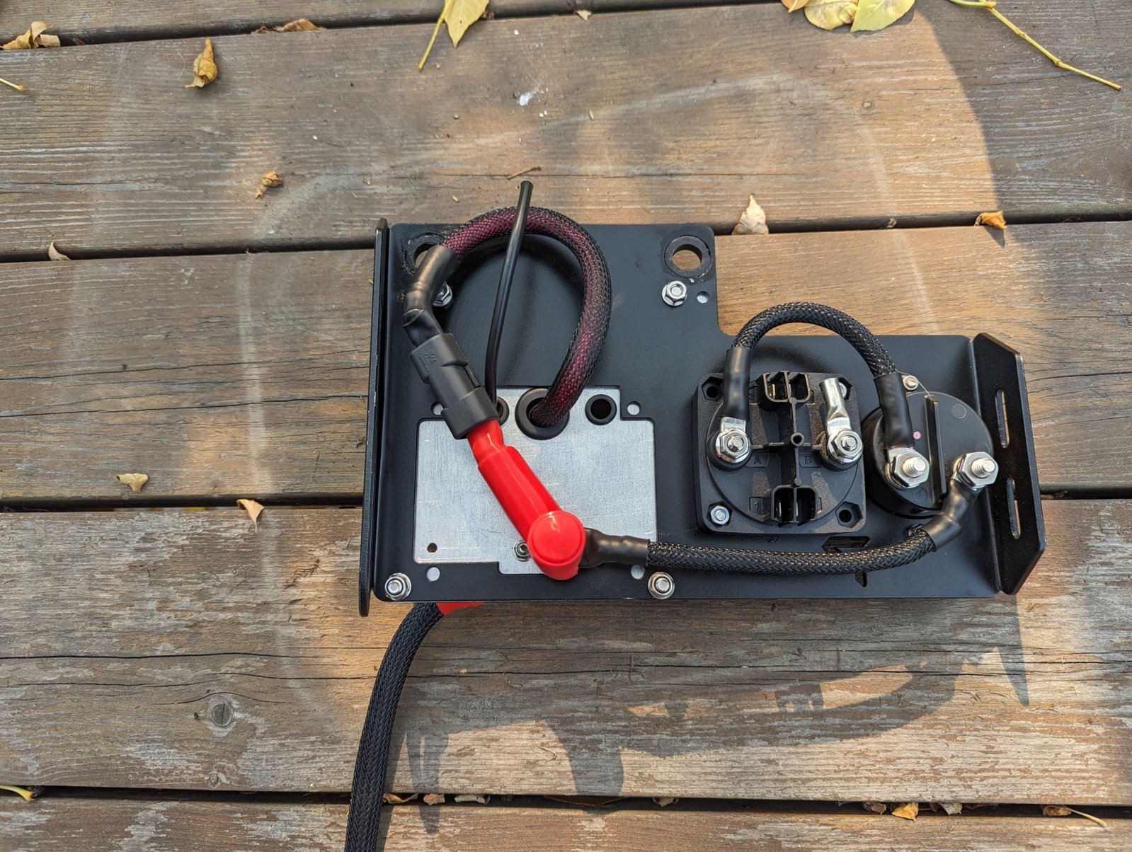

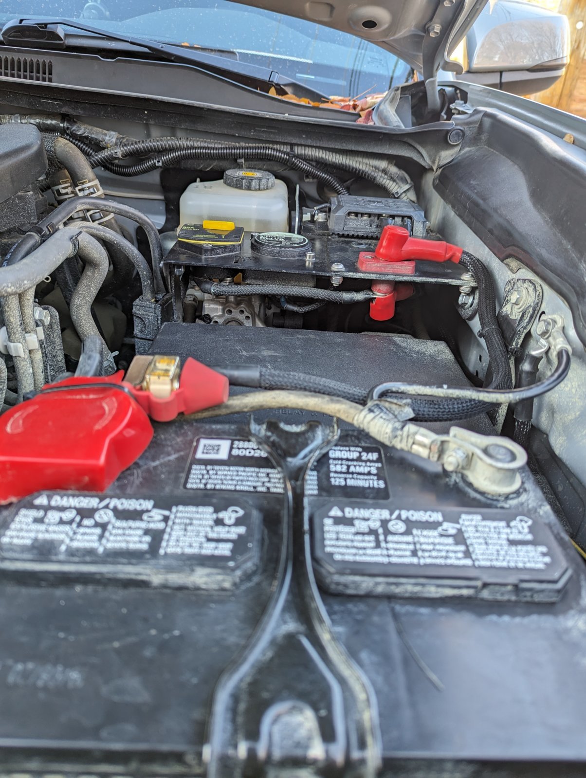

    Got all this bullshit squared up and installed and running. Wanted to do this project/install exactly how I wanted and wasn't going to cut corners with what I had on hand. Took awhile figuring out exactly what I needed in certain situations for materials, but pretty happy with how clean it turned out.
    Garmin power switch - Bluetooth to in dash display with android auto or off my phone. Phone connectivity will be great for shutting of scene lights once in bed in the RTT.
    Bluesea 50amp breaker runs through the Bluesea low voltage disconnect then back to an auxiliary fuse block in the rear cubby that's been sealed up. That will get finished this weekend! Will be glad to get this saga finished. A lot of work to hook up 3 devices @ this point, but will be so nice and future proof for as long as I own the vehicle.

    That's a professional install that I'm only mildly envious of. I can appreciate someone who takes their time to figure out what they want, both now and in the future, and does the job the properly. Let us know how well the Garmin PowerSwitch works. Depending on what way I go with the truck, either the PowerSwitch or a Switch-Pros will be on the to-do list much, much later in the future.

    Thanks man, it's appreciated. Not many people can appreciate an install that is supposed to go unnoticed and look like it's supposed to be there.
    As for the choice between switches it was really easy when Garmin announced it would be compatible with Android auto and the fact that I picked the Garmin up for $400 Canadian moose nickles on sale. Switch pro comes in around a $1000 around here is never on sale.

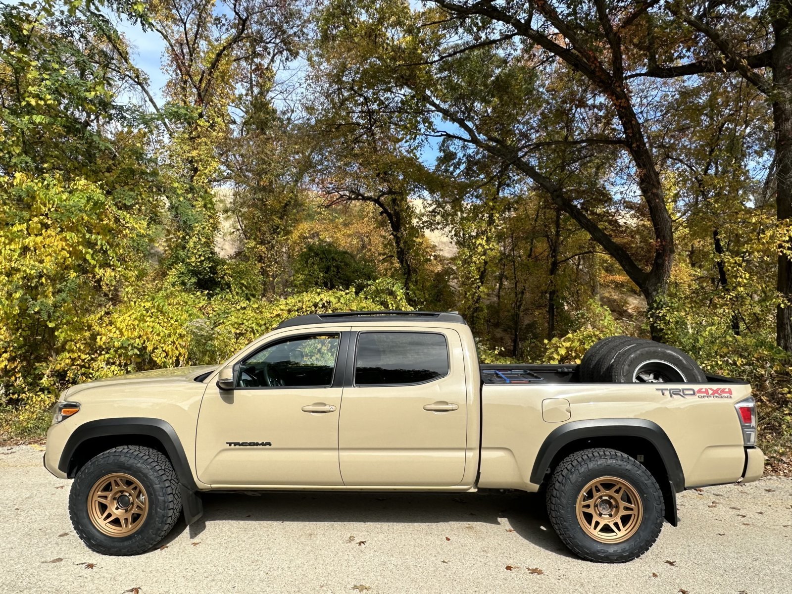

    In an effort to decrease MPG on my commute and be accepted by the locals at the mall I got some Falken Wildpeak MT pizza cutters from @Discount Tire
    First set of MT's ever, these things are loud and my MPG is trash I will never run MT again lmao

    Go back to discount tire and tell them you’re unhappy. They’ll make it right.

    Agreed. Couldn't get the Wildpeaks balanced on ours and Discount Tire swapped them with Toyo A/T III no questions asked. Very happy with them. Discount Tire rocks! :thumbsup:

    I made a rash decision to get MTs rather than wait and get 17 inch wheels and then AT pizza cutters so I'll live with my choices for now rather than abuse the service like folks are prone to do these days. Besides they look cool and that matters most according to Rule #1 lol

    Save up and buy the 17s and a reasonable highway tire. Keep the MTs on 16s and make room in the garage.

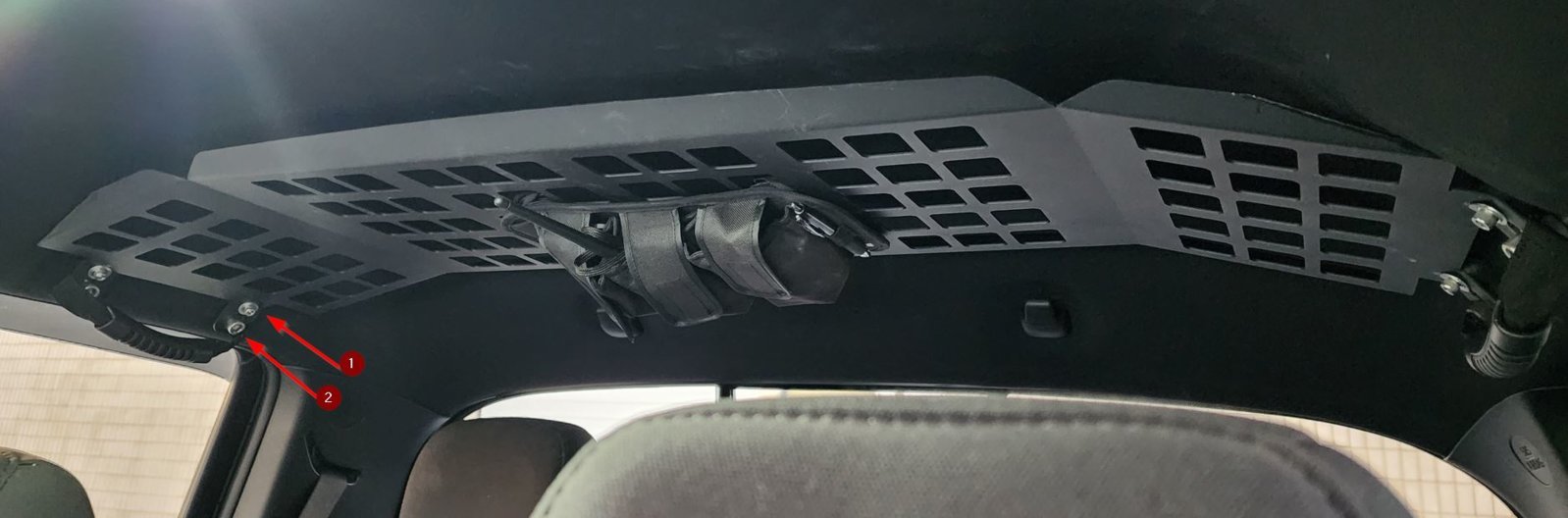

    I spent a little time and modified a 2nd gen OverHead Molle panel to work in my Double Cab. Used some rivnuts in the spots where the grab handles used to be in the back seat.
    Came out really well i think. I did have to change from standard round rivnuts to the "x-style" because the round ones didnt hold well in the rectangular slot where the handles used to be.
    #1 goes into the RivNut and #2 i added so i could attach the new grab handles.

    @Maddog-51 thank you for your business?.............. We do appreciate your support. The mud terrains definitely make the Taco look more rugged and off road capable. :thumbsup:

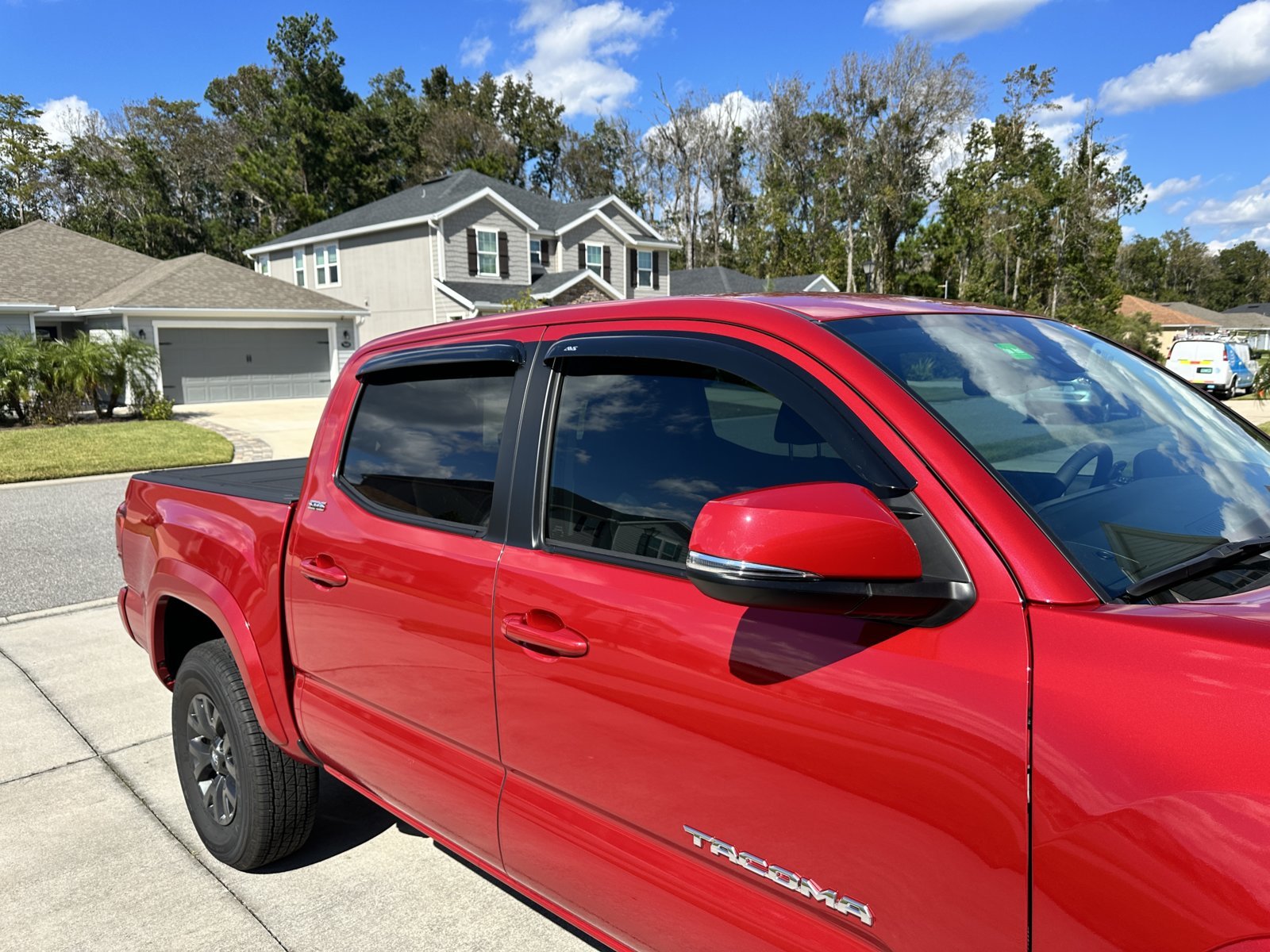

    1st mod… Installed window vents…

    Good choice on the mLVD! That is some excellent boat tech that I decided to install on my rig as well. Clean install. My compliments. I feel you on the "a lot of work to get three devices hooked up" comment. When I installed my front bumper and winch the longest part of the install was the wiring.
