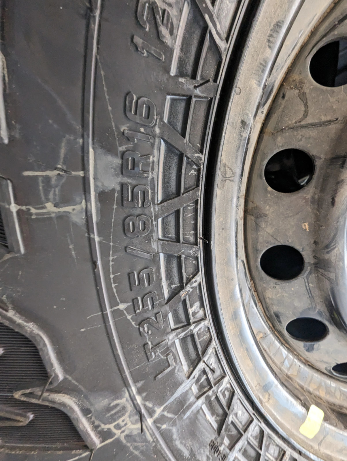

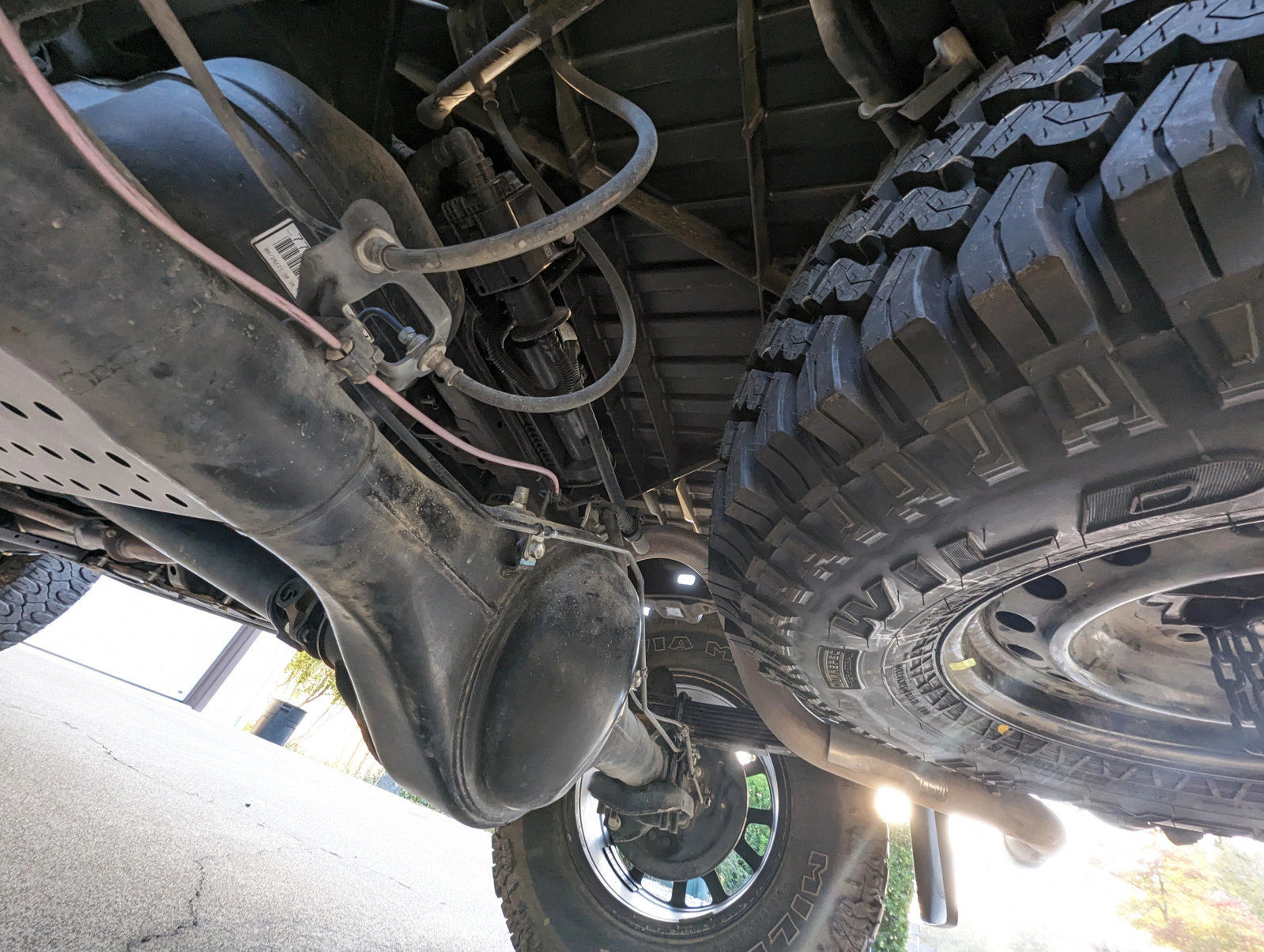

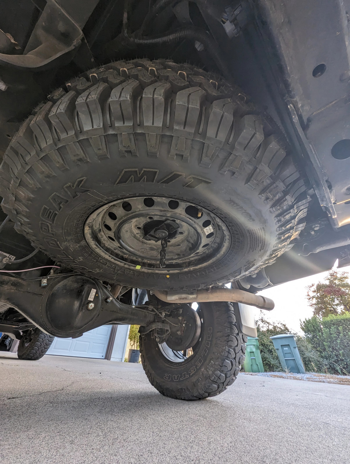

    PXL_20231101_000910499.jpgPXL_20231101_000927150.jpg PXL_20231101_000942832.jpg
    Thx to this forum I was able to get a 33" spare with little effort the other day. Chose the pizza cutter size to hopefully eliminate rubbing on control arms if I need it on the front. I moved the tire hanger to the rear a couple inches to make room for the larger tire. I didn't bend the alignment tabs, figured it would keep tire away from the diff. Like a glove!

    Was moving the tire hanger a big process?

    It really wasn't. The hanger requires 4 holes for mounting. You drill 2 new holes rearward and use the two rear most holes that are already there. Make sure you have ratcheting wrenches I think it's a 10mm or 12mm because it's pretty tight between bed and mount. Also don't accidentally drill through your bed, maybe place something above to protect bed while your drilling.

    Just for reference - the two holes to the L of the first image with clear coat near them are your new mounting points and the second is the relocated hoist in place (unused holes to the R of the image now).
