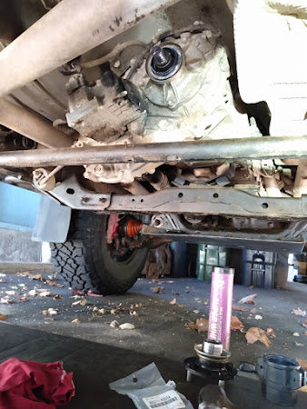

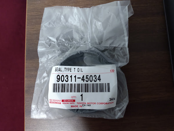

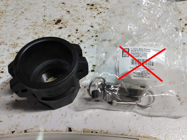

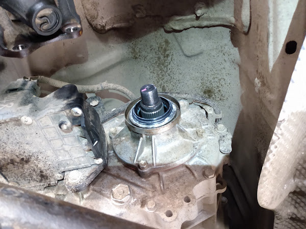

    Noticed my transfer case leaking at the rear output shaft at just 29k miles. I had to replace the extension housing shaft seal.
    Compared to earlier Tacomas, both the output shaft and companion flange are larger on the turd gen's VF2CM transfer case. That leaves a smaller gap around the output shaft for the seal puller. I also had to hunt for a seal driver. The standard-size steel and PVC pipes mentioned in YouTube videos for earlier trucks are too small for this application.
    The seal driver is a 1-1/2" NPTF "Poly Cam-Lock Coupler", made from a tough fiberglass-reinforced plastic similar to the oil filter cap. The unthreaded end happens to fit the seal. The coupler's billet cam arms are easily driven out with a punch.
    Transfer Extension Housing Seal P/N 90311-45034
    Transfer Output Rear Shaft O-Ring P/N 90301-31003
    Transfer Output Rear Companion Flange Nut P/N 90179-24011
    Seal driver Powerfist P/N 8154304

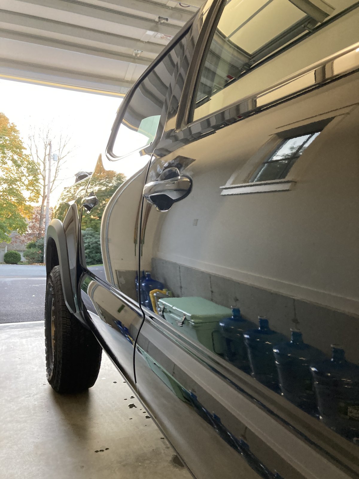

    I’ve used Rejex on my boat since I bought it new in 2014 - love that stuff!!

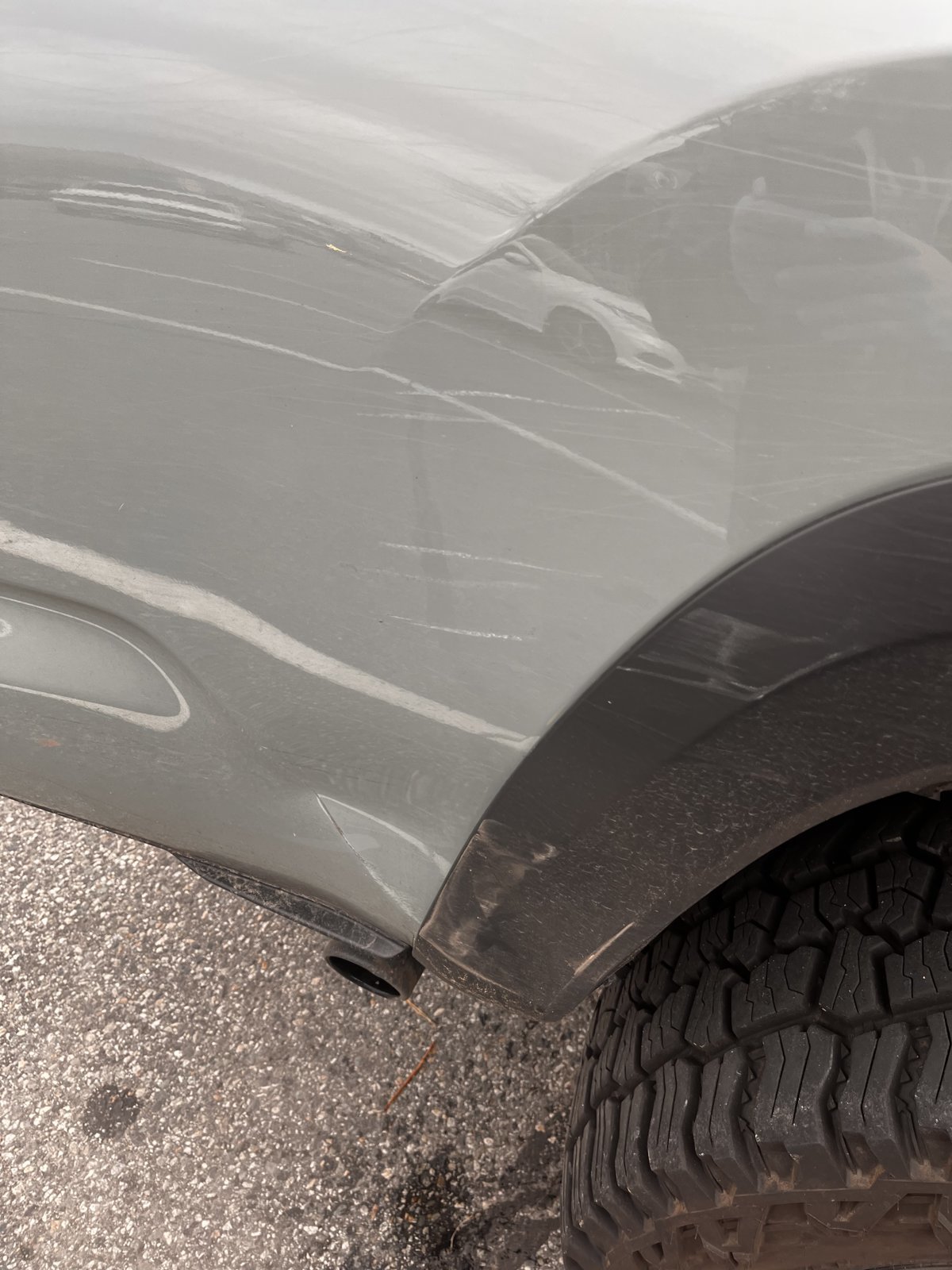

    Did the exact same damn thing lol Only difference is I was defeated by an F150. So frustrated with myself for trusting that camera

    Put it on your windows and it’s like ludicrous speed in a light rain without wipers. Put it on your wheels and the brake dust falls off with some water pressure . It can withstand ridiculous heat too. I put it on a pair of rubber gloves, like lotion, and massage it into my exhaust pipes keep things from rusting so quickly.
