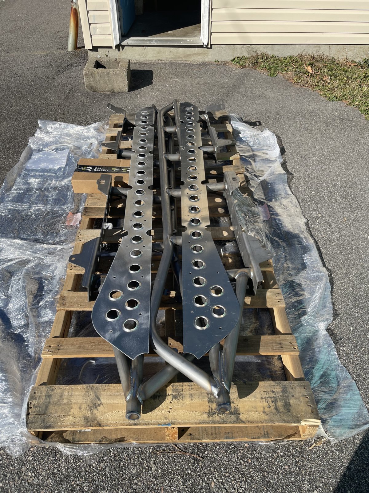

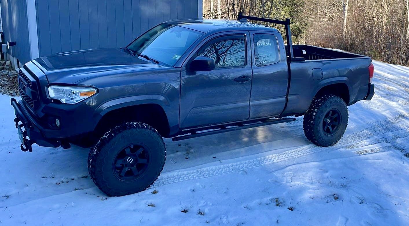

    IMG_3717.jpg Yesterday, I leveled up the front with a 3/4 spacer and some shock adjustment. Followed by an alignment.
    Today, I’ll finish up the fluid film on the front chassis and reinstall the skid plate.

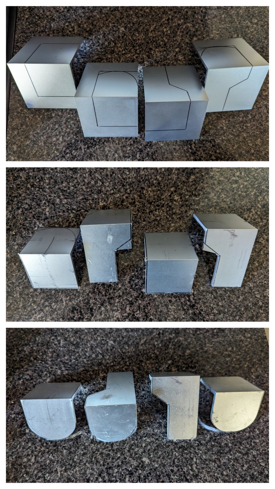

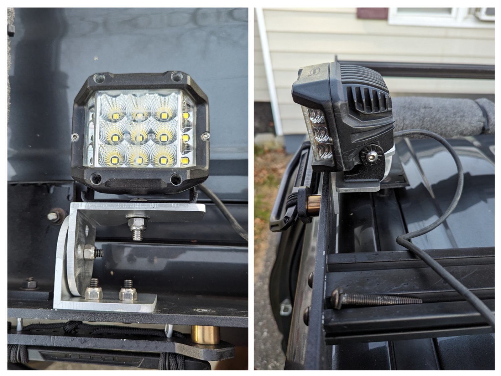

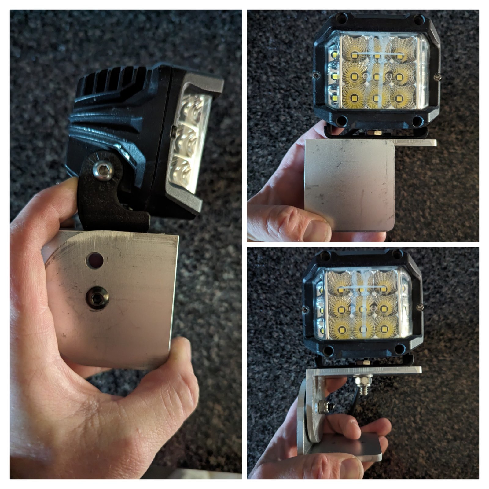

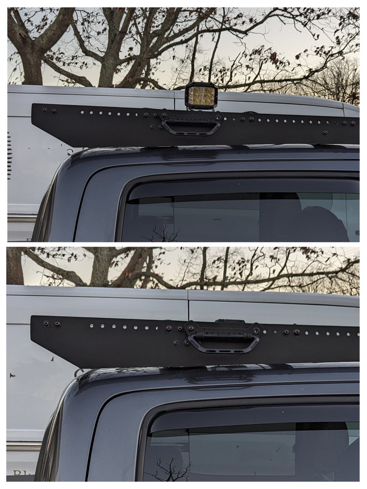

    Got 2 free led lights from my uncle. Wanted to mount them on my roof rack with a swivel bracket. Only brackets I saw that I liked were $100 each. So I made my own. Bought a 4 pack of 3 1/2 x 3 1/2 x 5mm aluminum angle bracket off Amazon. Just need to paint them up this weekend and wire them in.
    20231215_164016-COLLAGE.jpg 20231215_164719-COLLAGE.jpg 20231215_164755-COLLAGE.jpg 20231215_165036-COLLAGE.jpg 20231215_165013-COLLAGE.jpg
