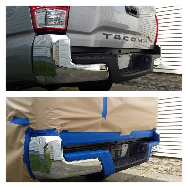

    Getting ready to plasti dip my rear bumper end caps ... i just don't care for the chrome and will be using the black plasti dip. First time ever using it. I cleaned end caps good and have everything taped off ect.
    .... here i go

    I would tape off the rest of the rear of the truck. You will get overspray on it if not.

    I'm doing that right now, you have an estimate of how long it'll take?

    I did .. taped the entire back off :thumbsup: 4 coats on so far, going to do 1 or 2 more then i will post results. I think it's going to look good and better than the chrome

    1 hour for me.

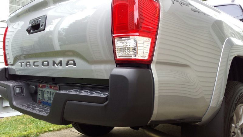

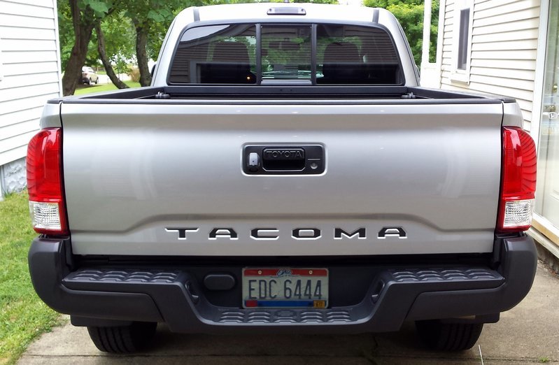

    Finished plasti dipping my rear bumper end caps and got rid of the chrome ... was a very easy job, took some time to cover and tape everything off. I did 6 coats waiting 20-minutes between each coat ( used almost a full can ) ... I like the look alot better and it was a cheap mod, i almost spent $160 a while back on a set of new black bumper end caps .. this saved me about $150 and looks good
