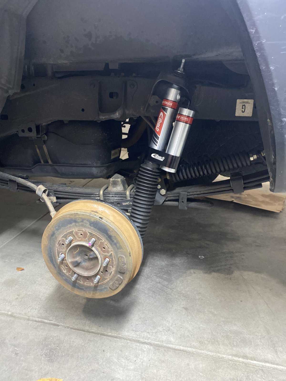

    I'm at just under 75k miles so figured it was time to replace the stock shocks/struts. Originally thought I would level it off but with the 3 settings on the front 5100s it would have made the front about 1/2" higher than the back...not a fan of that, especially if I end up hauling stuff. At least this way I have new shocks for ride improvement and have the flexibility of adjusting them in the future if I decide to go larger than 265's (and raise the back). I was under the false impression that all TRD models had Billstein shocks but not necessarily so on the sport model. Mine were Hitachi's.

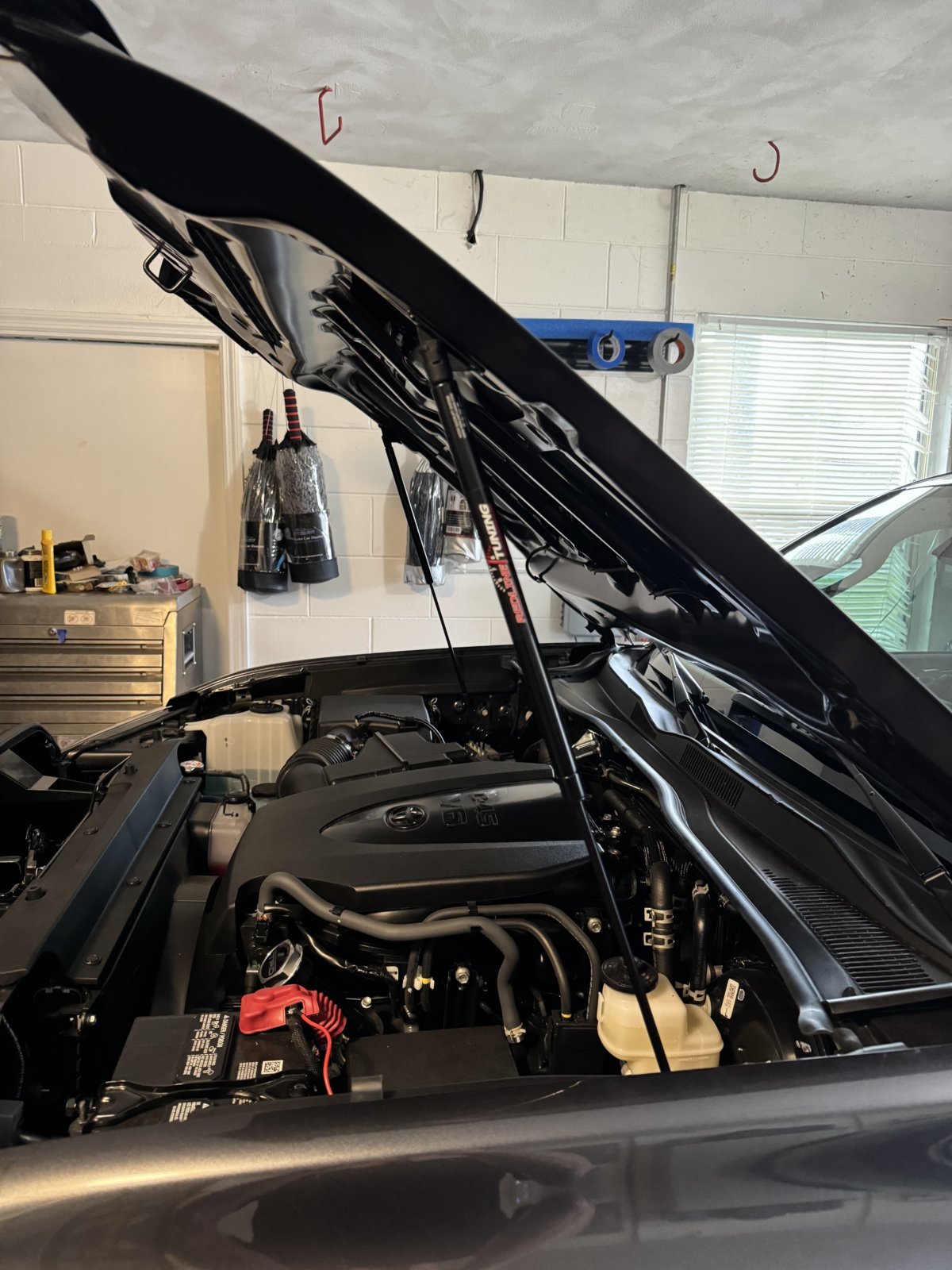

    Just got it
    Installed RedLine Max Lift hood struts. Helps having a good rivet gun and drilling smaller pilot holes was a good thing also. Was scary drilling into my 2 month old Taco, but I am glad I did, now that I am done!

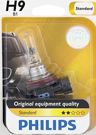

    Switched out the Philips H11s for some Philips H9s in my low beams, replaced the old high beam H9s, and replaced the old H11 fogs.
    Received the German made ones instead of China too. That was a big plus for me when it comes to halogen lamps.
    The 400hr lifetime rating is big for me as I drive about 100miles a day for my commute to work.
    OH! And some new wipers ;). Ready for the snow to fall!
