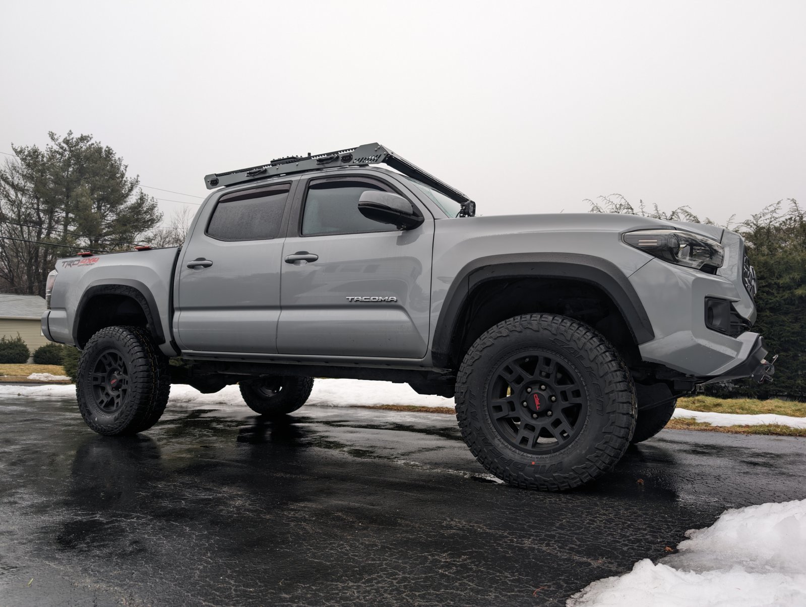

    That’s an awesome rig!! From everything I read about both tires, that will be a big upgrade in wet weather and snow.
    Also, PSA in case anyone doesn’t know: The Wildpeak AT4W’s are available.

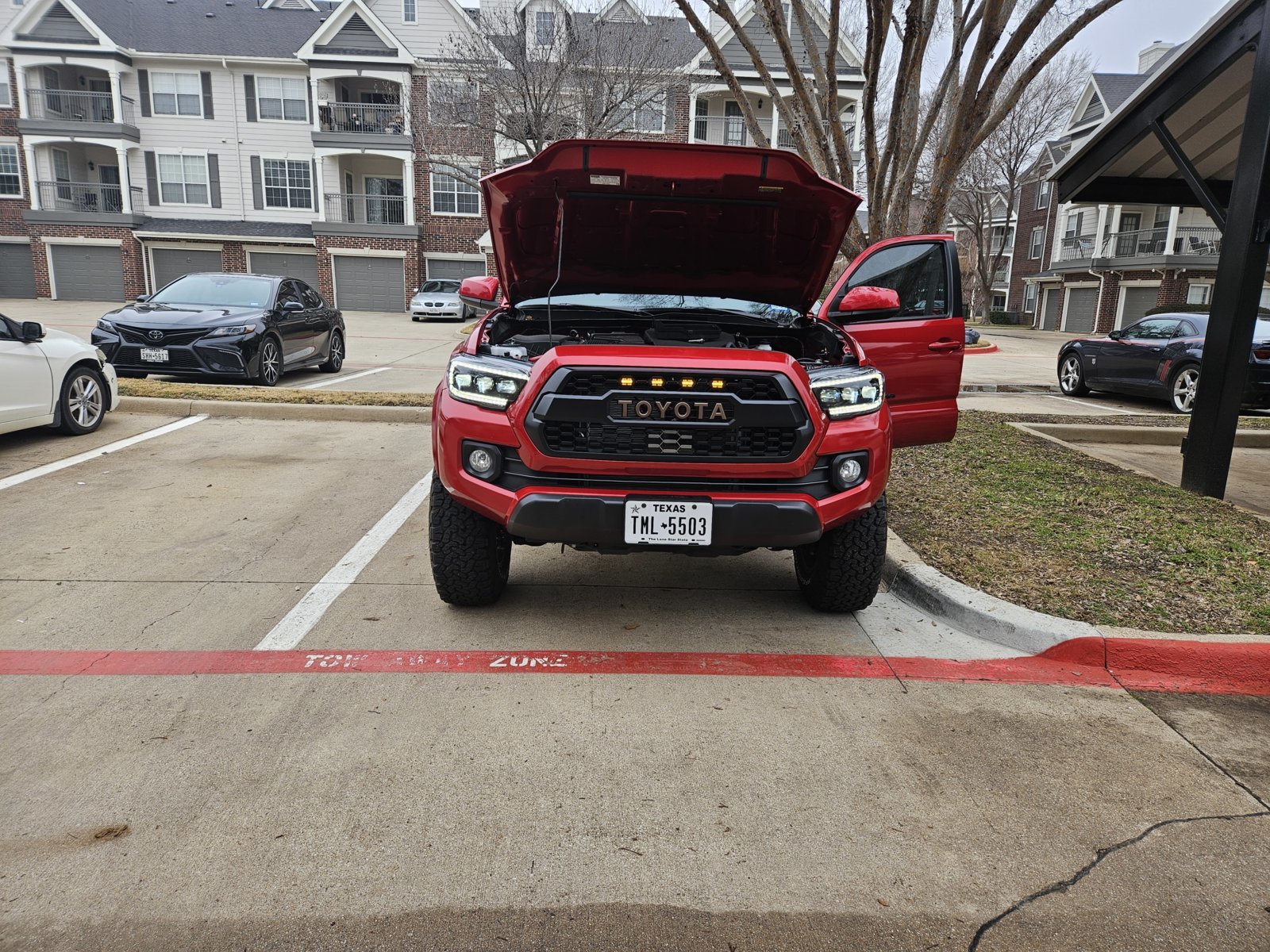

    Looks better. My brother did that with his Tacoma too. I’m thinking about debadging mine for a cleaner look.

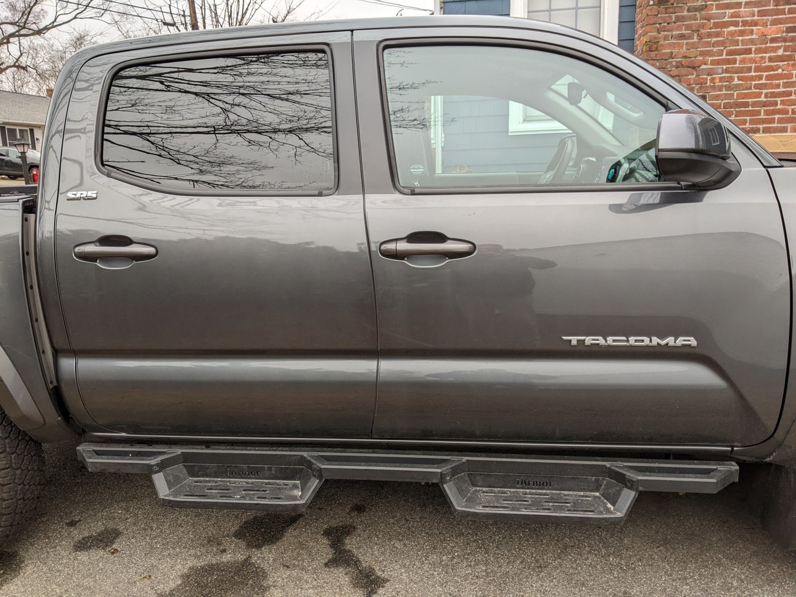

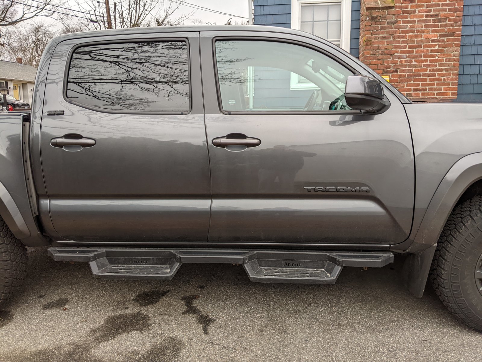

    Can I ask what running boards/sliders you have?

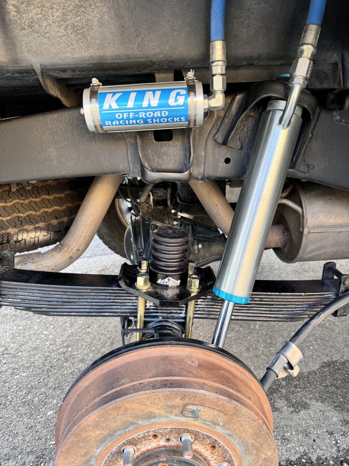

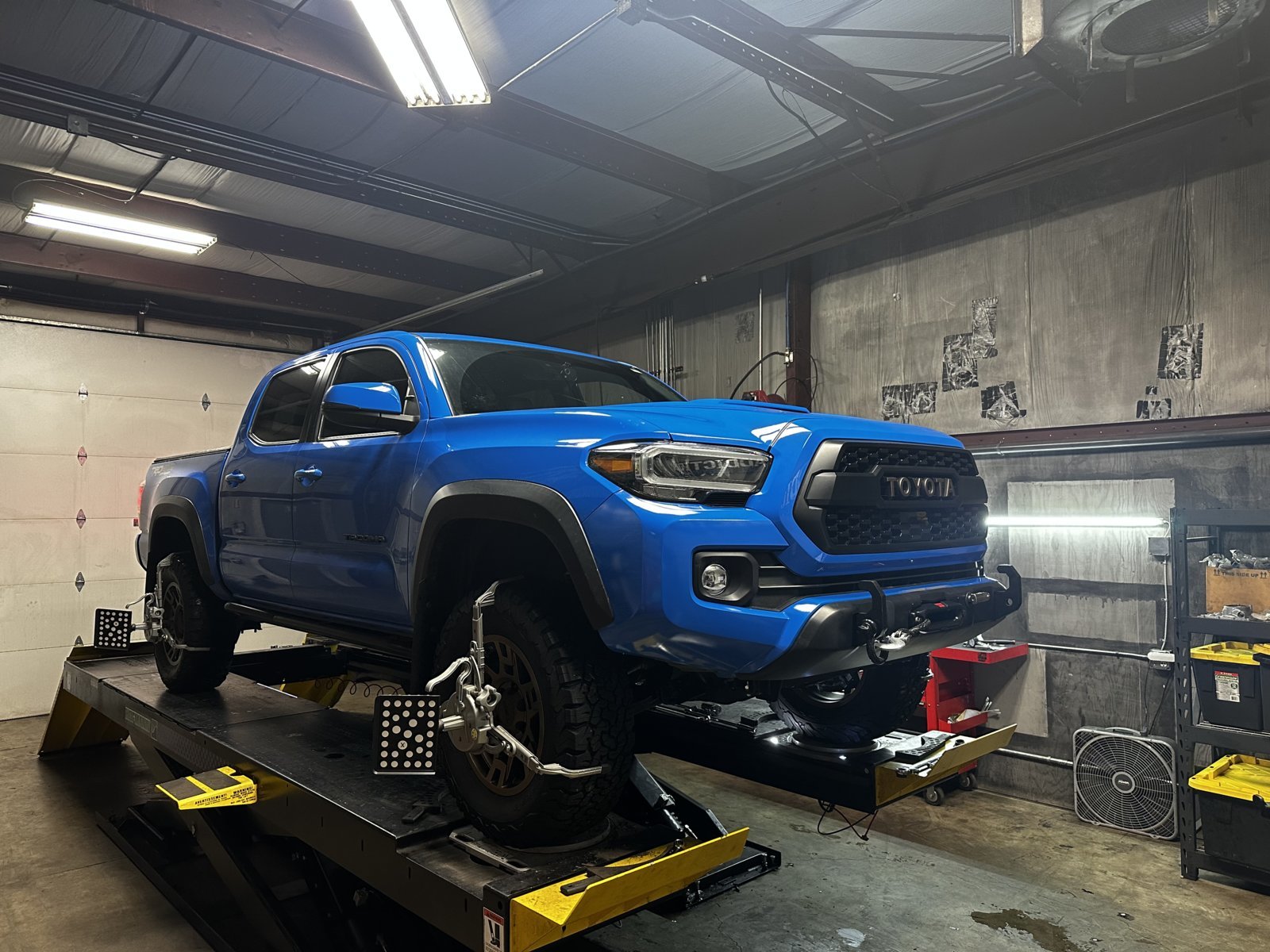

    All finished up and realigned after adjusting the coilovers.

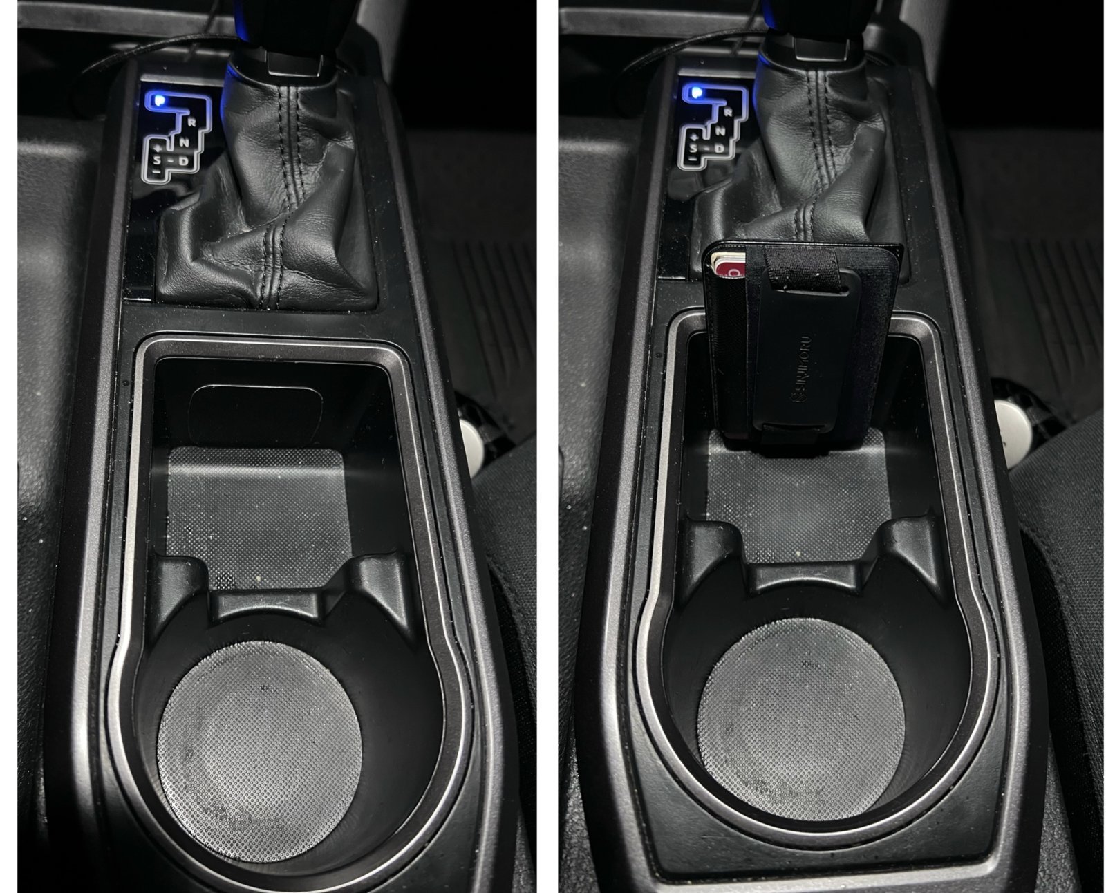

    Slapped a spare metal plate that came with a phone mount into the square cavity and now my magsafe wallet stays out of the way.

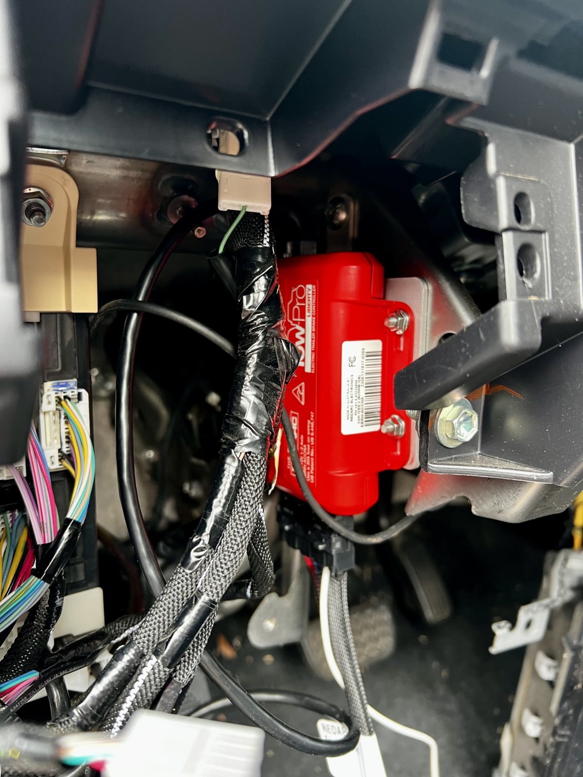

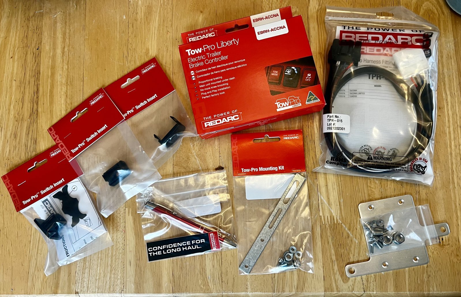

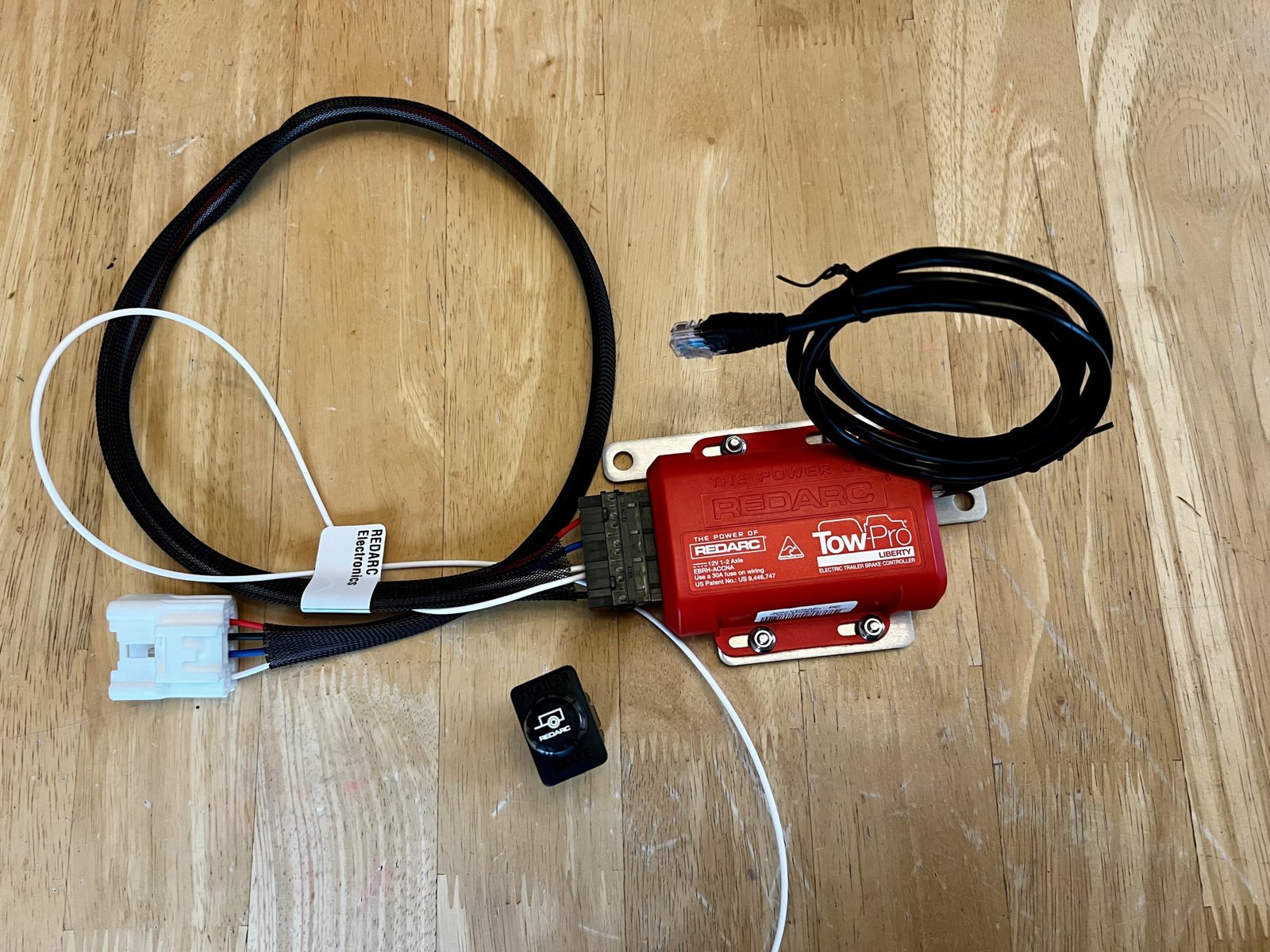

    2. 12v Towing Controller, Red-D-Arc. Painless install. Amazed Toyota left this out yet installed transmission cooler. Misled by Toyota advertising and descriptions of heavy tow capacity.

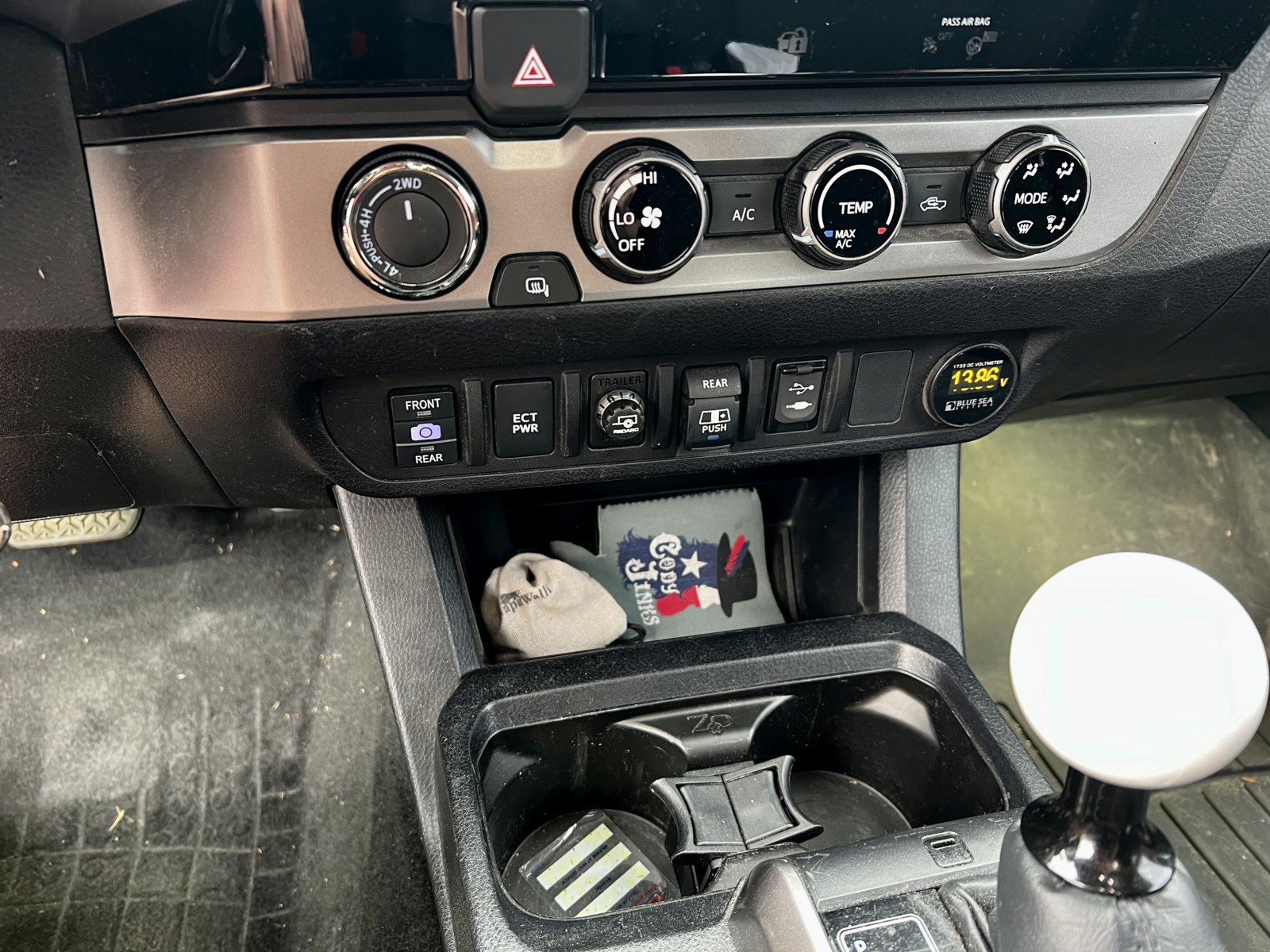

    Thanks @WaitingOnMyR1T, I ditched the Qi charger today. I'd ordered the part (58810-04010-CO) as part of the Black Friday sales and finally put it in.
    Non Qi on the left, Qi on the right
    Pull the center console top (first couple of minutes of the video below)
    https://youtu.be/qxdZdo__4l8
    Then remove the screws (circled in red, they're 8mm hex or you can use a Phillips head) and unplug the Qi (green square)
    There are clip assemblies (circled in red) that require the console box to be pulled back.
    Which requires the two bolts (10 mm hex) be removed from the bottom of the box
    Reassemble and you get this.

    man i would much rather have a pocket for my sunglasses down there.. so theres a void space if we already have the charger there? wonder if i could sell my charger for anything.

    I wonder what you would pay for your charger. That amount, minus shipping, is probably what you could sell it for. It's probably negative.
