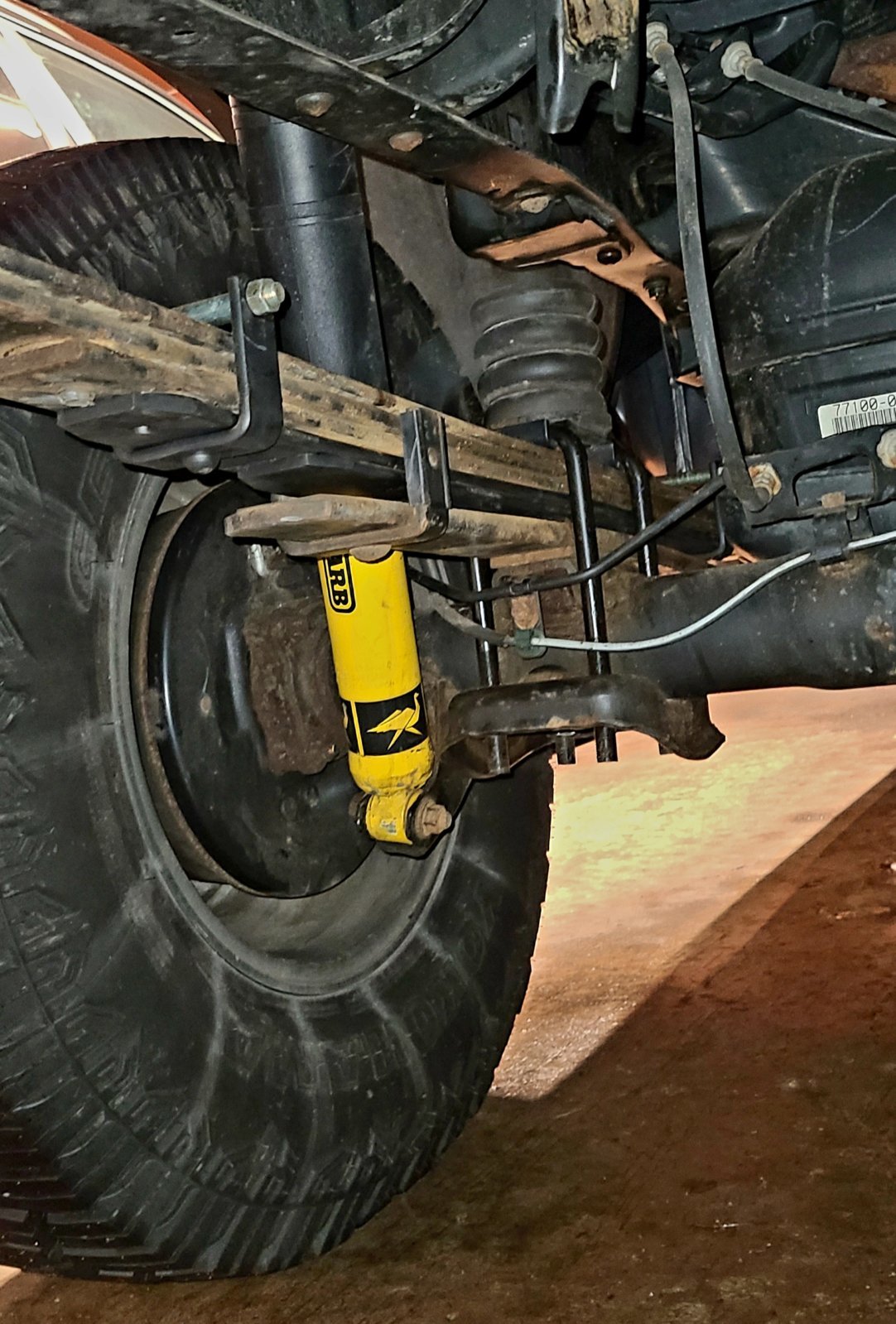

    I'm a YouTube mechanic, this was by far the most involved work that I've done. Day 1 was the front end, day 2 the back. Everything went relatively smoothly I guess you could say. I was hopping between 3 YouTube videos and the Tacoma World torque spec thread the whole time.
    -8400 miles on the tacoma
    -Did it all solo
    -No issues pulling the needle bearing on the CV axle, puller fit fine.
    -No issue removing the drain / fill plugs on the differential
    -Had challenges unseating both tie rods and the studs spun when reassembling (thankfully there was a tacoma world topic on the challenge)
    -Had challenges reconnecting the sway bar, since I'm a noob, both sides were below the tie rods when I reassembled them, so there was a lot trying to get the bar where it should be and at that point i was tired. I ended up having to disconnect one of the tierods
    -Because of the above, I did have some grease push out of one tie rod bushing and both sway bar bushings. But that is a future me problem if they lost too much.
    -The drain plug of the diff had some sludge on it. Went with 75W-90 because I don't desire to get into the gear oil debate
    -My Milwaukee Impact decided to lose all torque at the end of the first day so the entire second day was done with hand tools. I can barely move today I'm so sore.
    The rear brake lines are a bit tighter than I care them to be and the u-bolts for the leaf springs were a bit shorter than I would of liked. Because of that, I'll probably do the u-bolt flip and extend the rear brake lines at some point. Drove the truck around a parking lot across from the house during the snowstorm didn't hear any thing off or feel any vibrations. Alignment is scheduled for tomorrow. Certainly can feel the difference in ride. It will be interested when the rock solid suspension hits some bumps.
