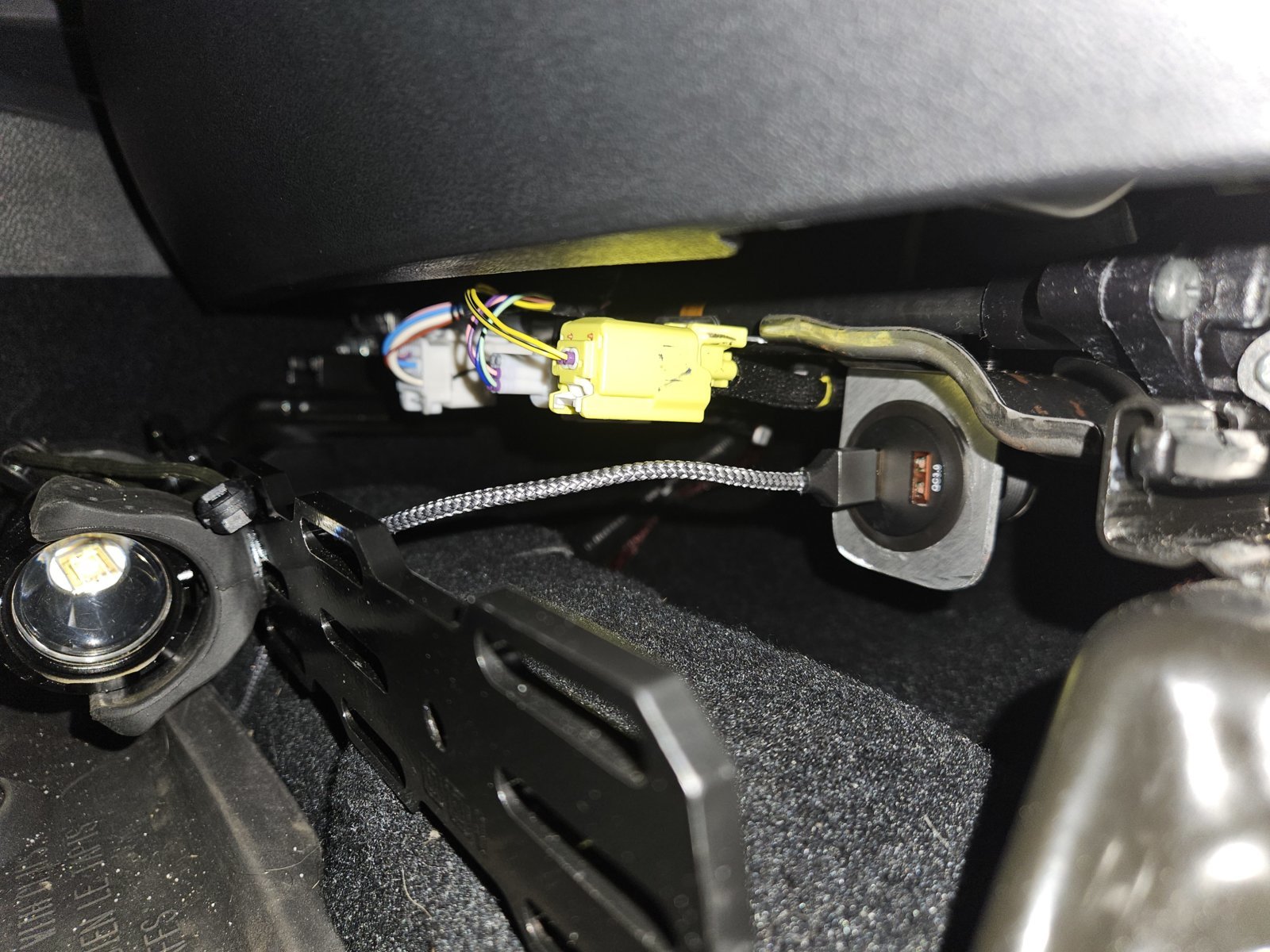

    Added a pair of USB ports under the driver seat using an add-a-fuse to the existing USB spot in the fuse box. Home made bracket.
    While under there, I took the opportunity to vacuum out the dropped fries.

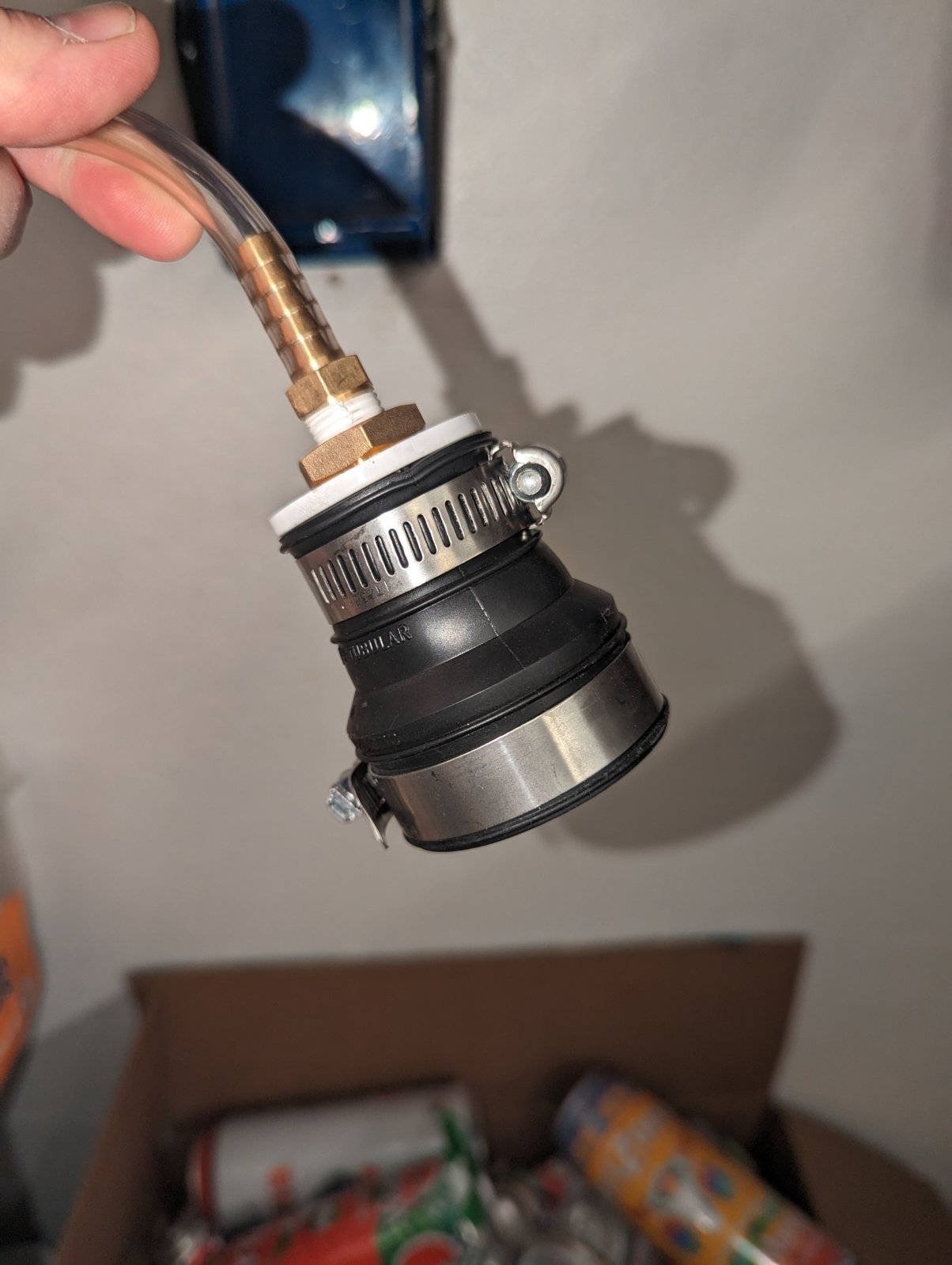

    wrestled a ridiculously long time with the shield over the clutch slave on my 2018 to do the relatively simple job of fluid flushing the clutch lines... was inspired to make my own power bleeder adapter from plumbing parts - though i take no credit, I believe I saw it here first. Adapter worked flawlessly with the motive power bleeder.... Brakes tomorrow?PXL_20240310_000024784.jpg

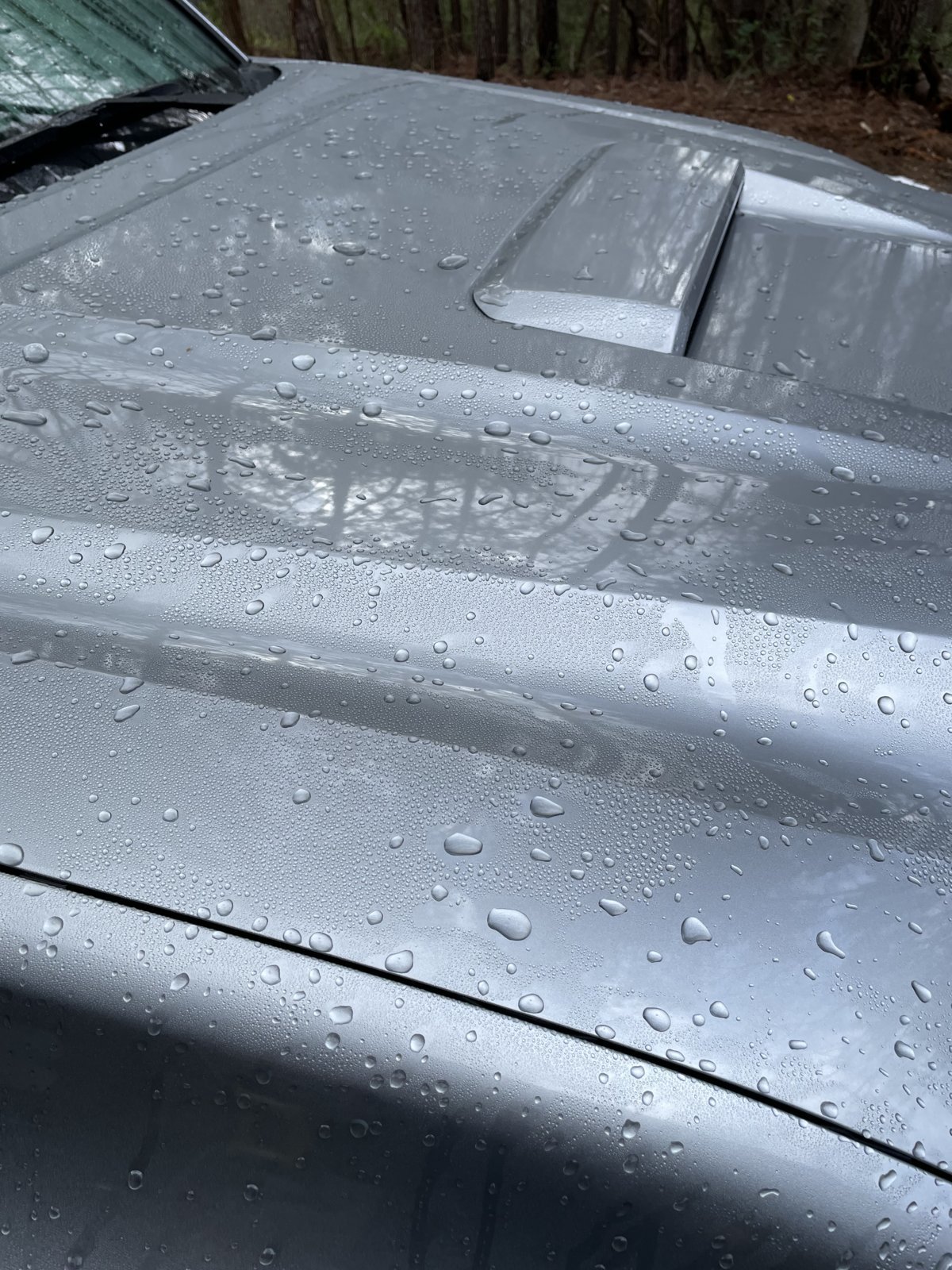

    This was after a wash today, turtle wax graphene ceramic coating applied in October and has been through several washes as well as driven every day. Beads aren’t as tight as they were but I’m pretty happy with durability considering ease of application. I went ahead and put a fresh coat on today.

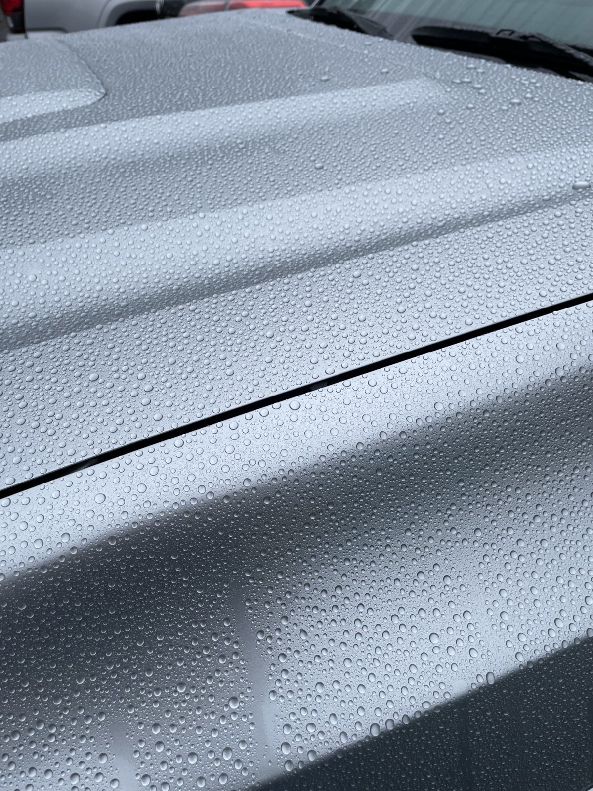

    This was a couple of weeks after application.
