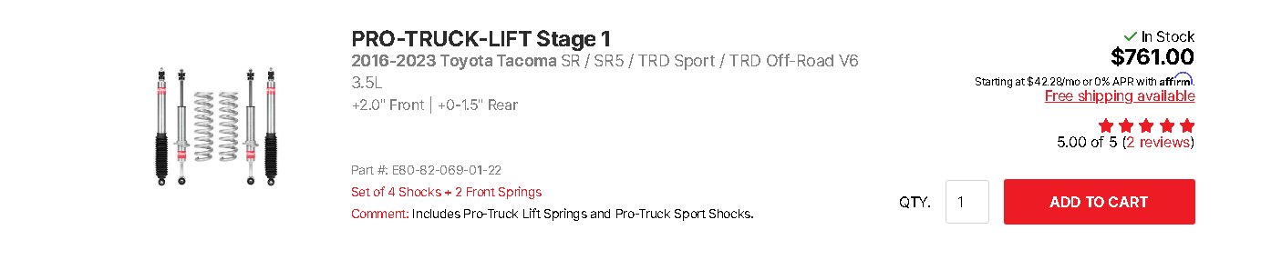

    No personal experience with the Eibach lift, but I do not it's a well regarded budget option. I imagine it would handle similar to the TRD lift. Just remember though, that doing the TRD lift through a dealership would mean you get the Toyota warranty and backing. If you did this lift with a friend on your own and any issues arose, you'd have to diagnose and fix on your own or take to an independent shop and pay them to fix it. If this is the Eibach Stage 1 I'm thinking of, I believe it gives 2.5-3inch in the front... I honestly wouldn't go over 2 inches in the front though unless you account for upgraded UCAs. Once you go over 2 inches up front, you starting putting the factory UCAs outside of their intended range which can lead to issues with wear and tear and alignment. With the TRD kit, all you need is what they are selling you.
    Another plus of the TRD lift that I didn't mention earlier is that any Toyota Dealership Service Department should be able to align your truck since this is a dealer installed option. If you go aftermarket, you would be stuck going to an independent shop and trusting their expertise. Although there are a lot of good shops that know these trucks well. I don't think you can go wrong either way though. I was concerned about doing it myself as well because I'm still paying off a brand new truck. But I found a deal I couldn't pass up and have experience doing suspension work.
    Not necessarily trying to convince you on one or the other, even though I sound biased. Just some things to think about. Lots of good forums on these topics though so I'll stop rambling in this one.
