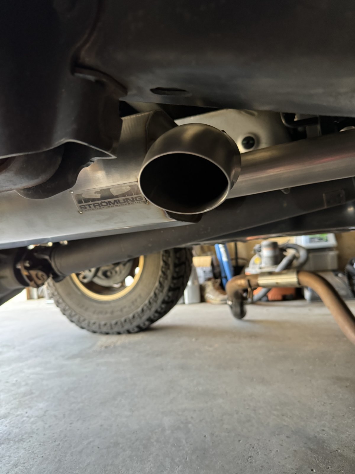

    It has been a little while since I've been on here, but I found my way back, and I wanted to share my feedback on the Stromung "tucker" exhaust that I recently installed on my Tacoma. So far, I'm enjoying it. It's not obnoxiously loud. Has a nice deep tone that's not overbearing, and I like the fact that I get extra clearance. I plan on putting my 33" spare under the truck, and I won't have to worry about the tire getting too close to the heat shield. It's made of stainless steel, so hopefully it lasts a while.
    The flange bolts were rusted to hell. They were so bad that it looked like they were welded on, so I purchased new ones since I knew I was going to destroy the originals while getting them off. I also purchased an OEM gasket that is designed for aftermarket exhausts. Apparently, Toyota sells two gaskets - one for the OEM exhaust and one for aftermarket. All the videos I watched said you can use the original hangers, but that didn't work for me. The tailpipe rubbed on the frame, so I purchased longer hangers.
    Parts links:
    Flange bolts – https://www.amazon.com/dp/B0181H22YK?ref=ppx_pop_mob_ap_share
    Gasket – https://www.amazon.com/dp/B00FWPF7ZG?ref=ppx_pop_mob_ap_share
    Longer hangers – https://www.amazon.com/dp/B07XQ93KMP?ref=ppx_pop_mob_ap_share

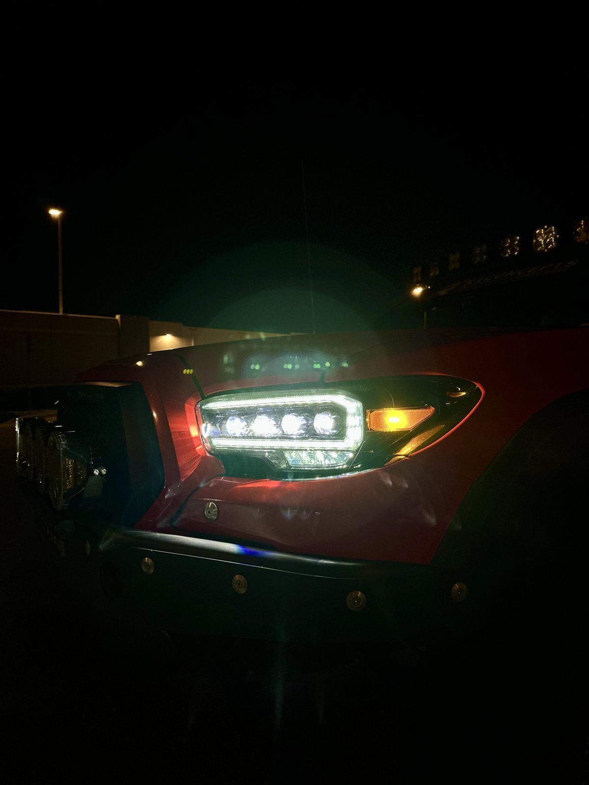

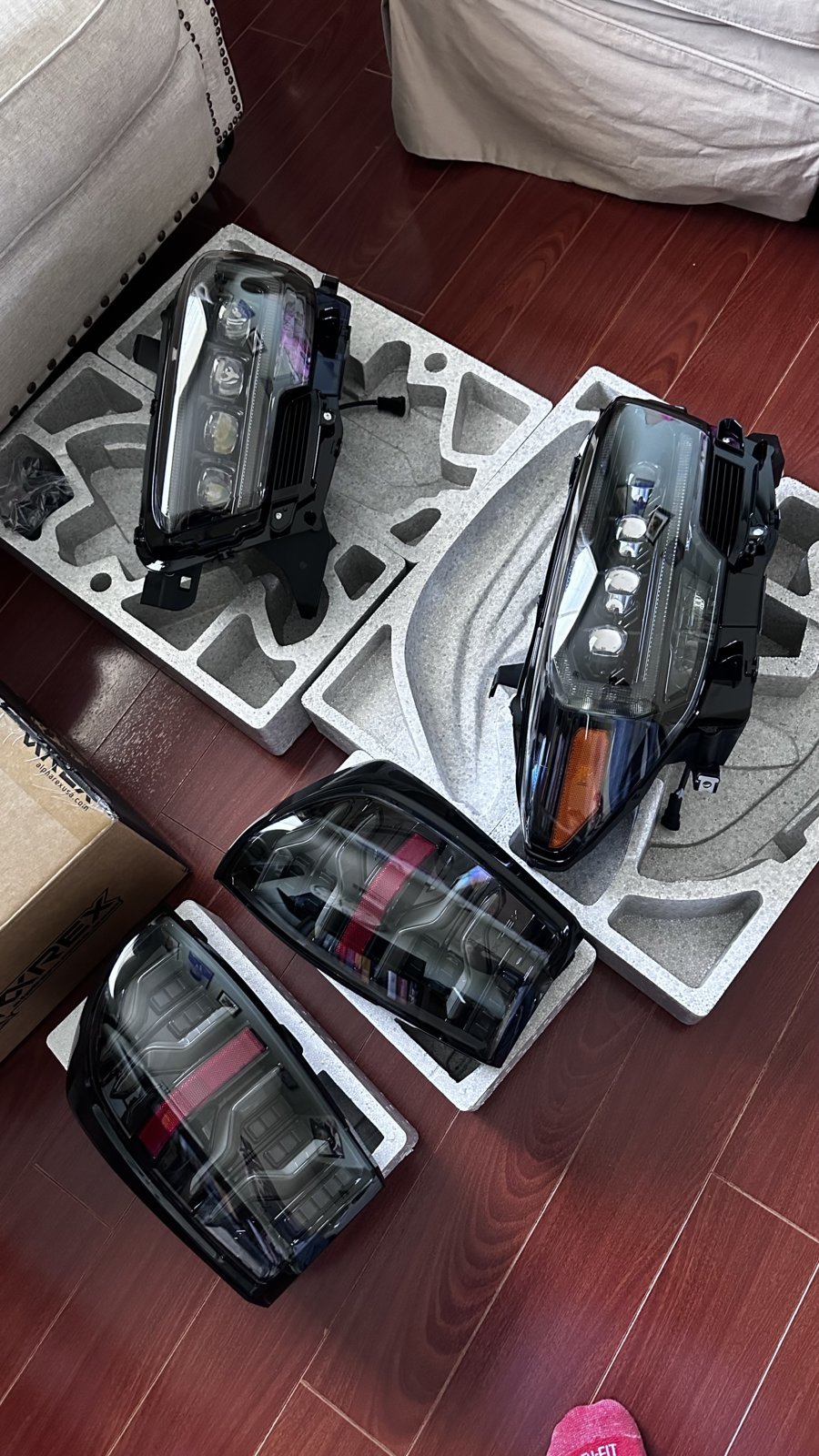

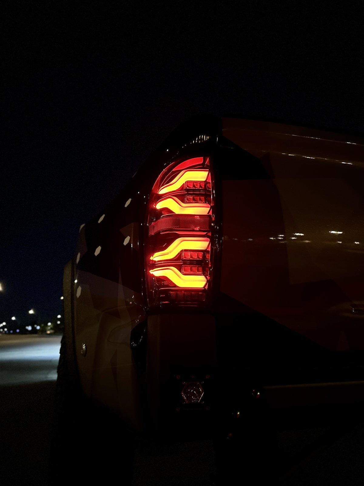

    Installed these alpharex nova series headlight with the luxx tails both in alpha blackIMG_1421.jpg IMG_1422.jpg IMG_1380.jpg

    Sweet set up

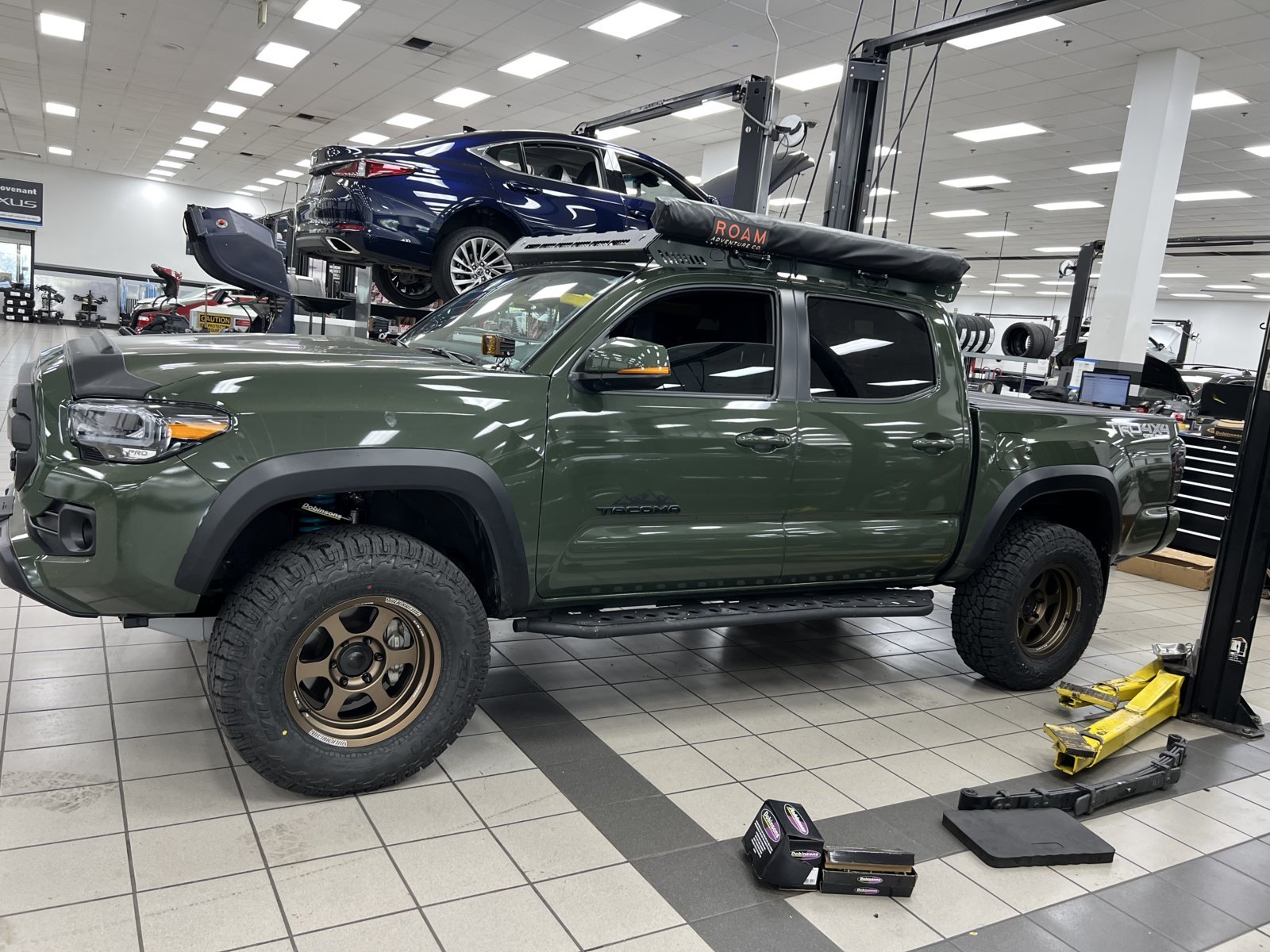

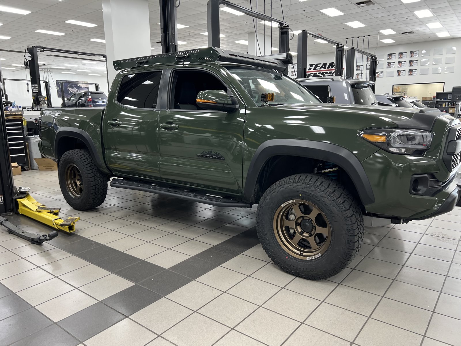

    Yesterday, but got her lifted, 3d printed ECGS install tool, ECGS bushing install and aligned this morning.
    Lift + post lift pic
    3d printed install tool + bushing installed
    Alignment numbers
