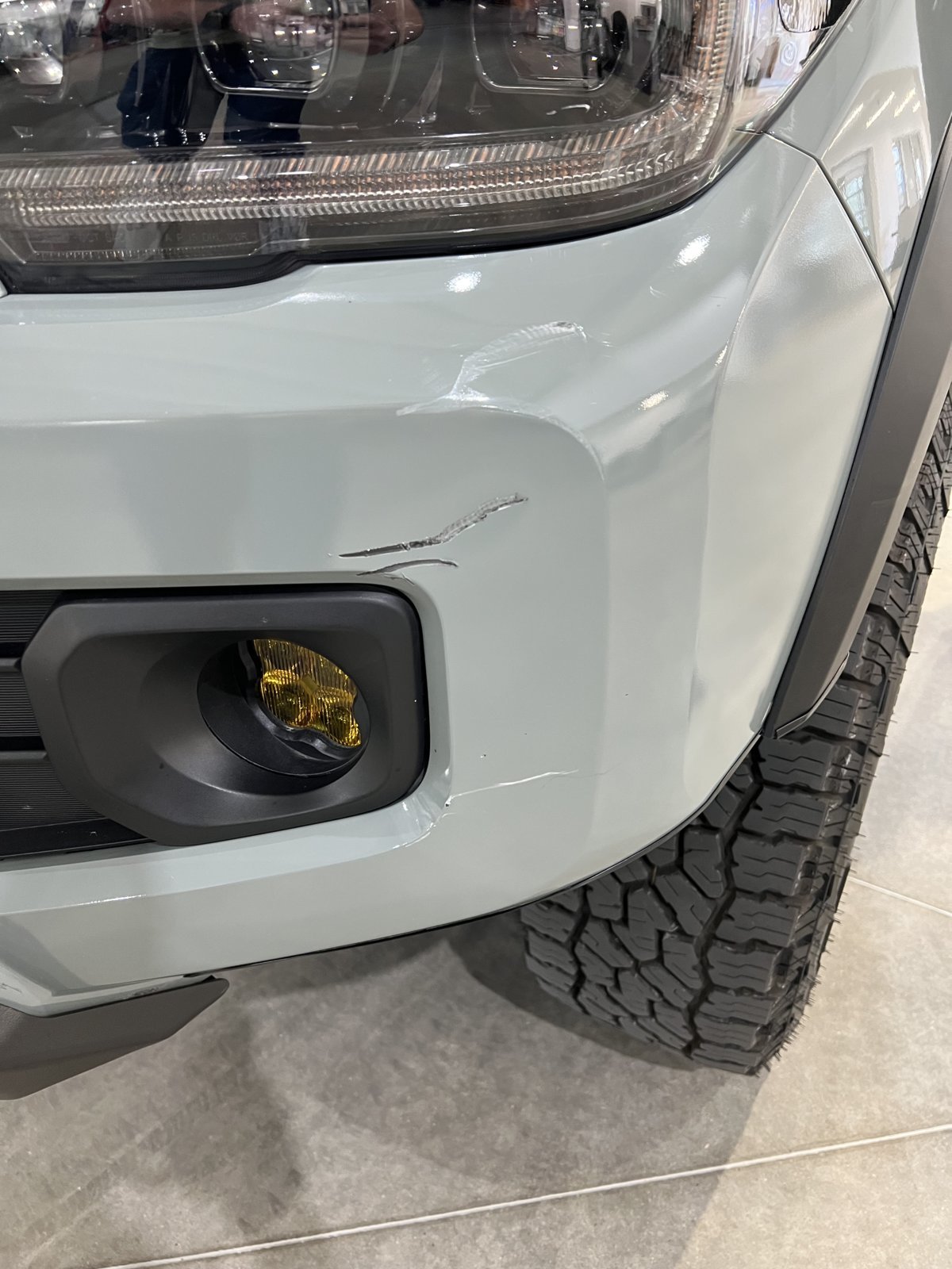

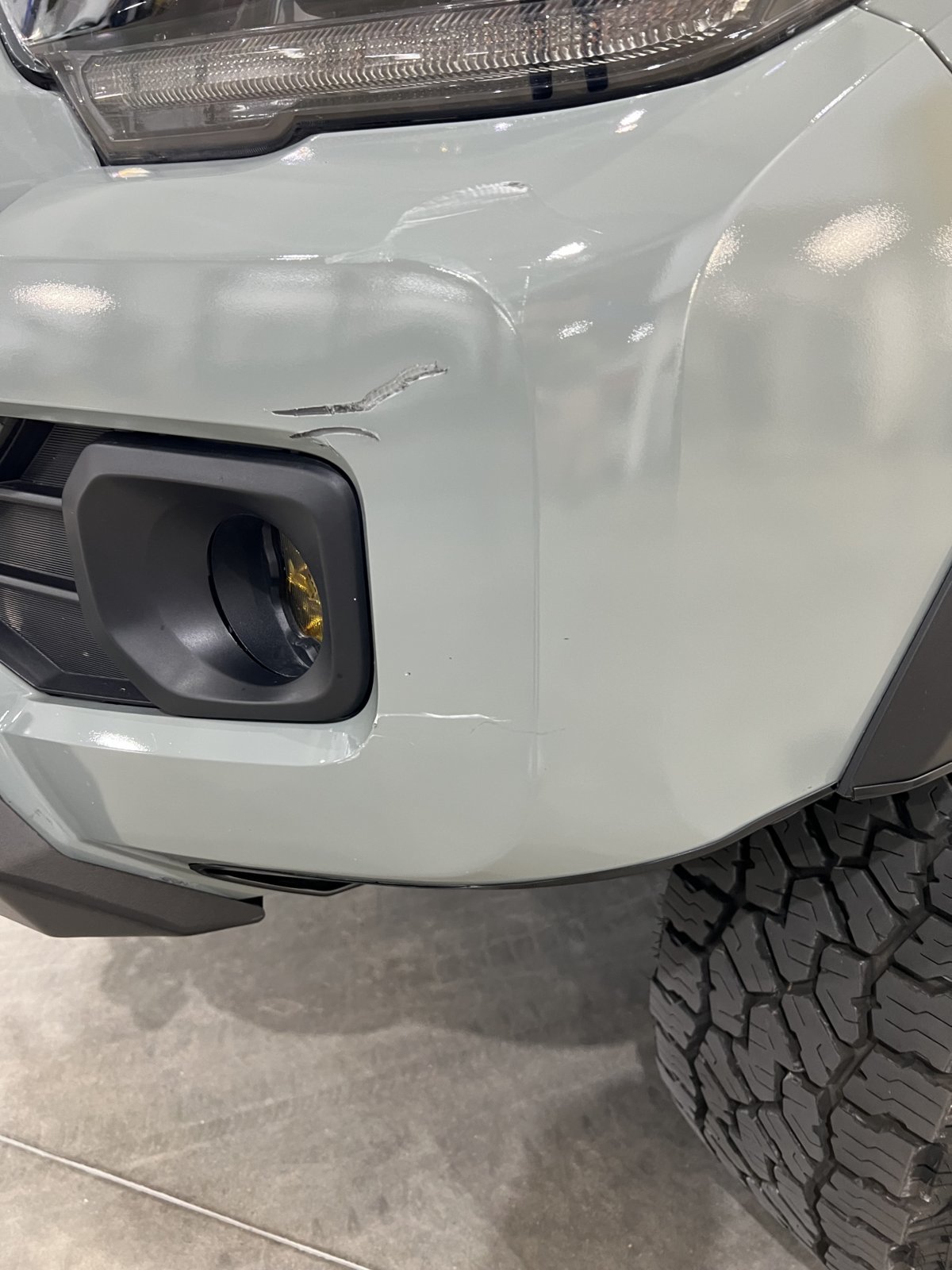

    You're really missing an opportunity here. I'd tell them I'll be having a trusted body shop perform the repair, bring them the quote for repair, and be gone with a check in hand. That hybrid bumper would show up on Toyota's dime.

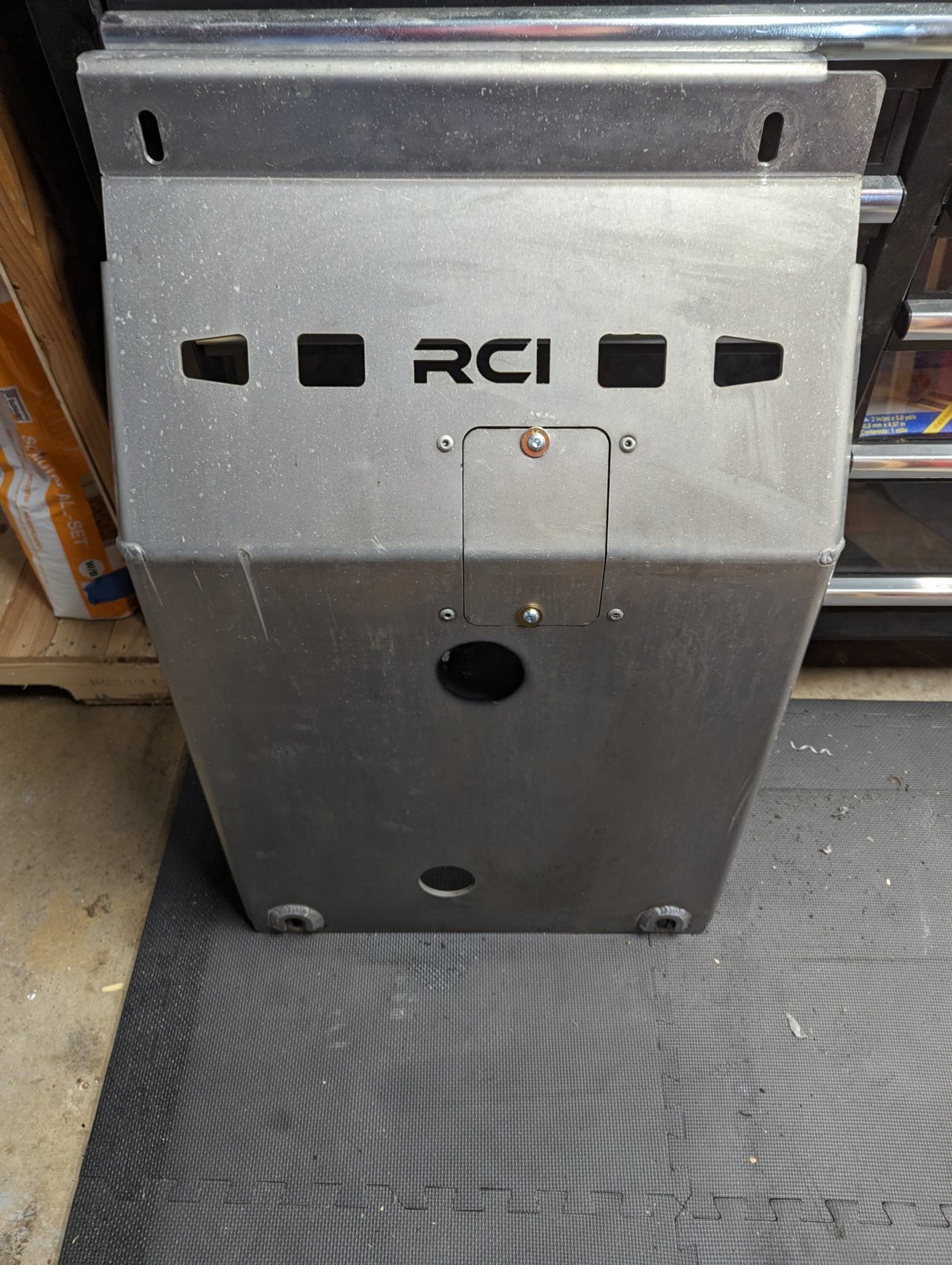

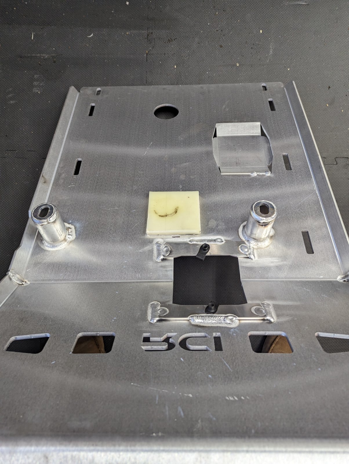

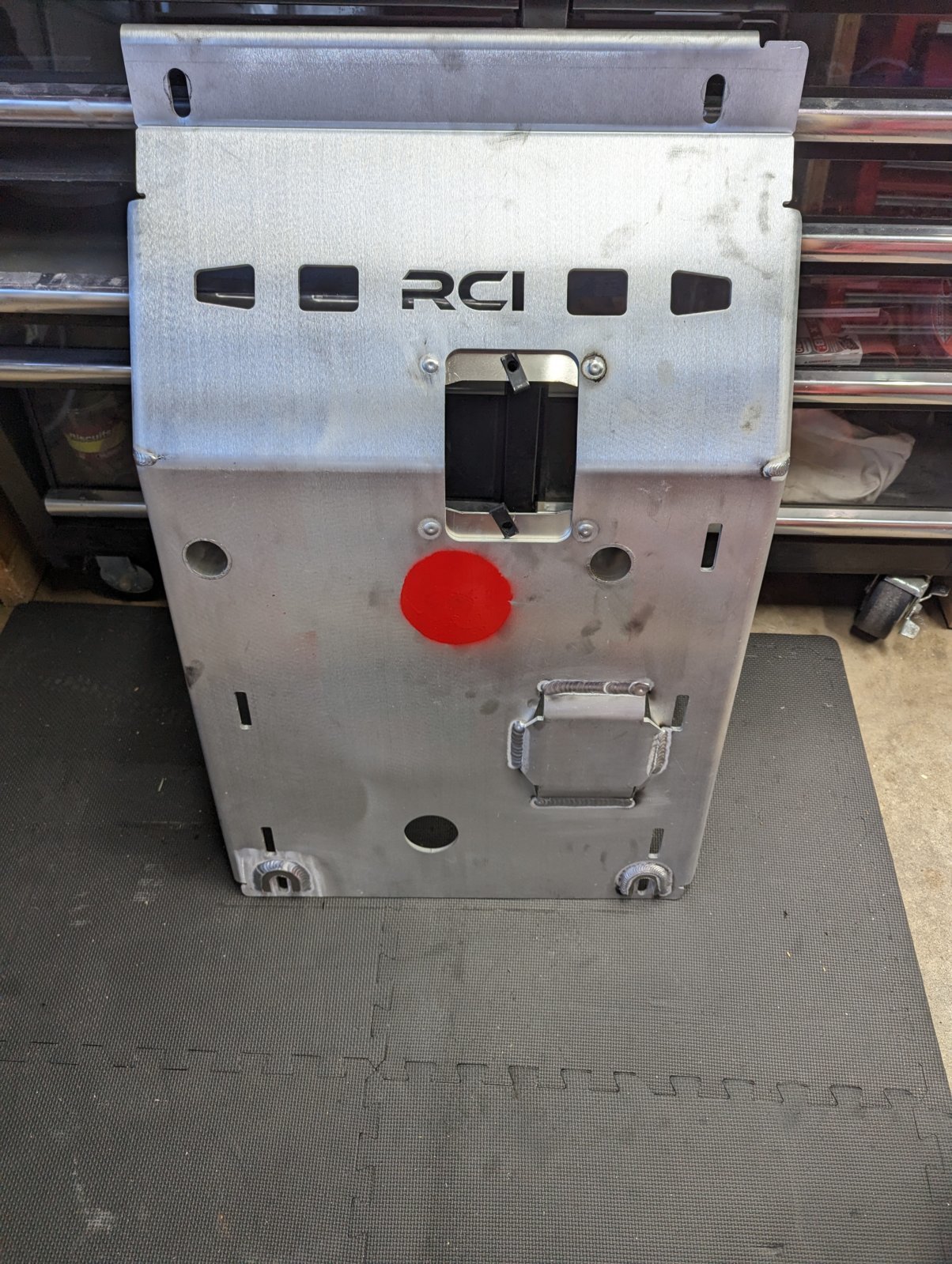

    Got my new RCI engine skid plate and am patiently waiting for my fuel tank skid to show up.
    It's replacing an older style engine skid plate that didn't have the diff bump or the extra mounting holes.
    The old one I had worked just fine but I had is spaced a 1/2" lower to give the diff plenty of space.
    So now I have more ground clearance and I feel better that it uses 6 mounting holes vs the 4 that the old one did.
    The red dot I put on there so I know where the jacking point is. On the back side I put a piece of 3/8" HDPE to fill the gap from the skid to the lift point. So that way the skid won't bend if I lift from there.

    Hindsight is always 2020, last thing on earth I expected to deal with this morning and I’ll be armed the next time this happens (hopefully never but not with my luck). Definitely took me about 10 minutes to even understand how the heck they managed to even do it, let alone come up with a plan to get a new fancy bumper out of it lol

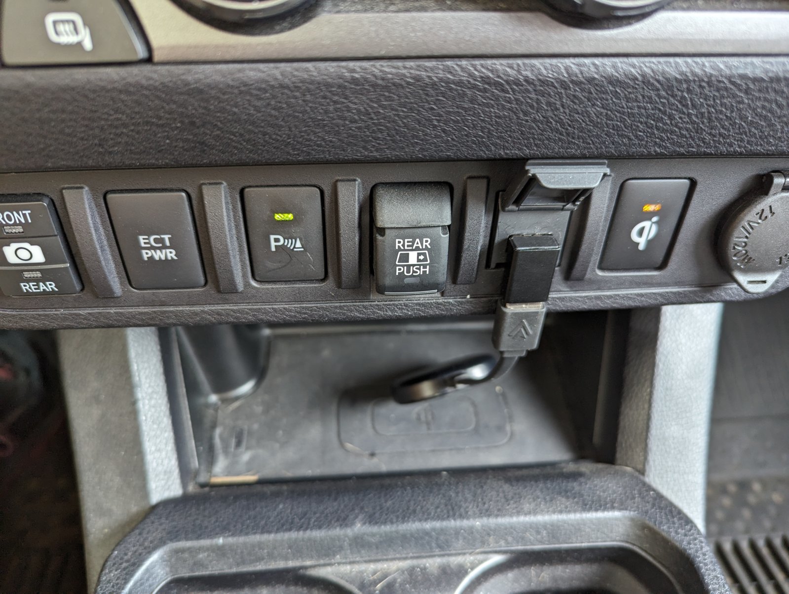

    I have been looking for one that fits that tight.... mind sharing a link to that one?

    I’m always hoping someone tags my bumper, front or rear, so I can take the check and go to Warfab Armors website and add to cart :D
    Edit: I don’t even hit the horn anymore, I just grin and hope.

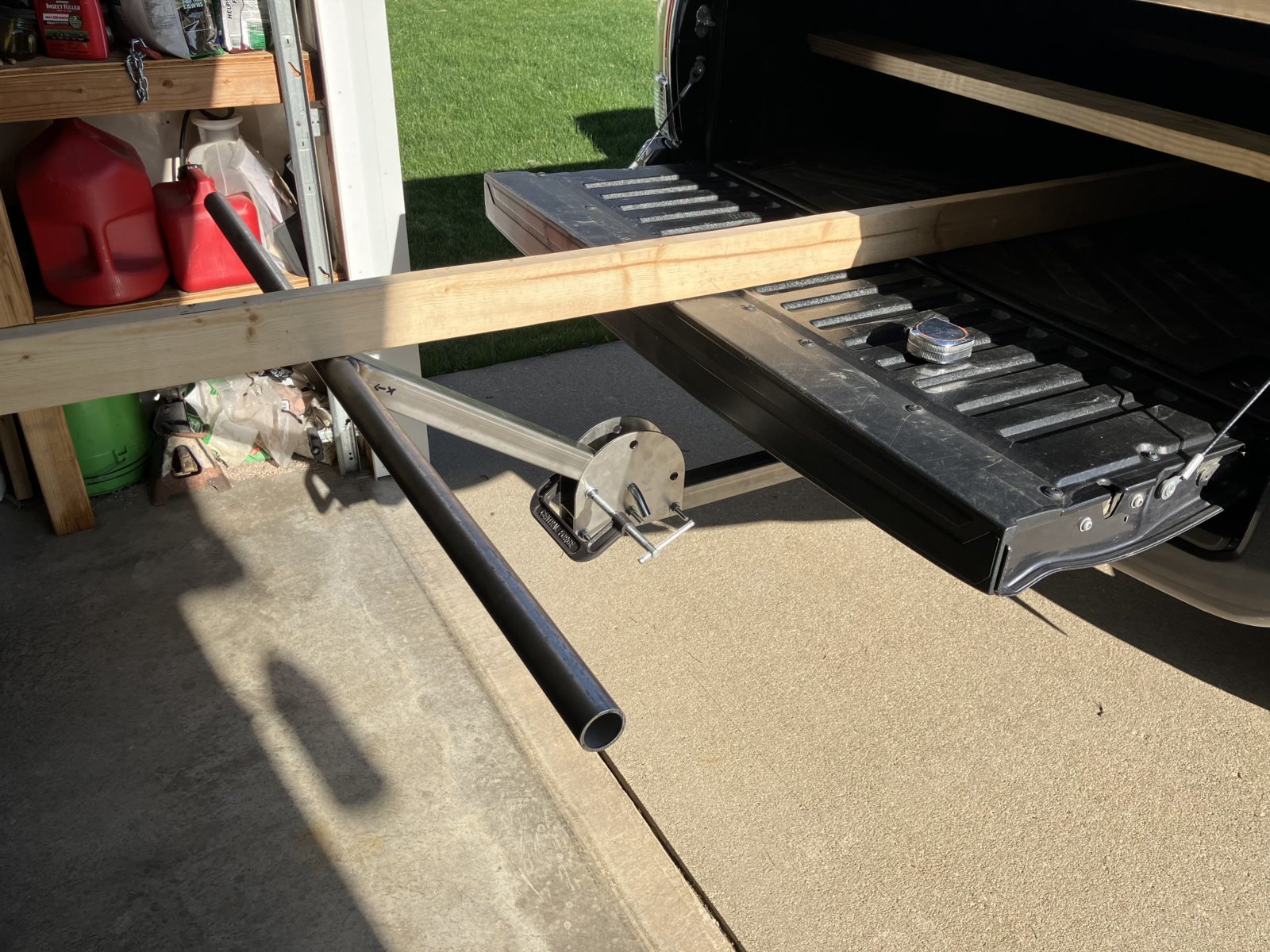

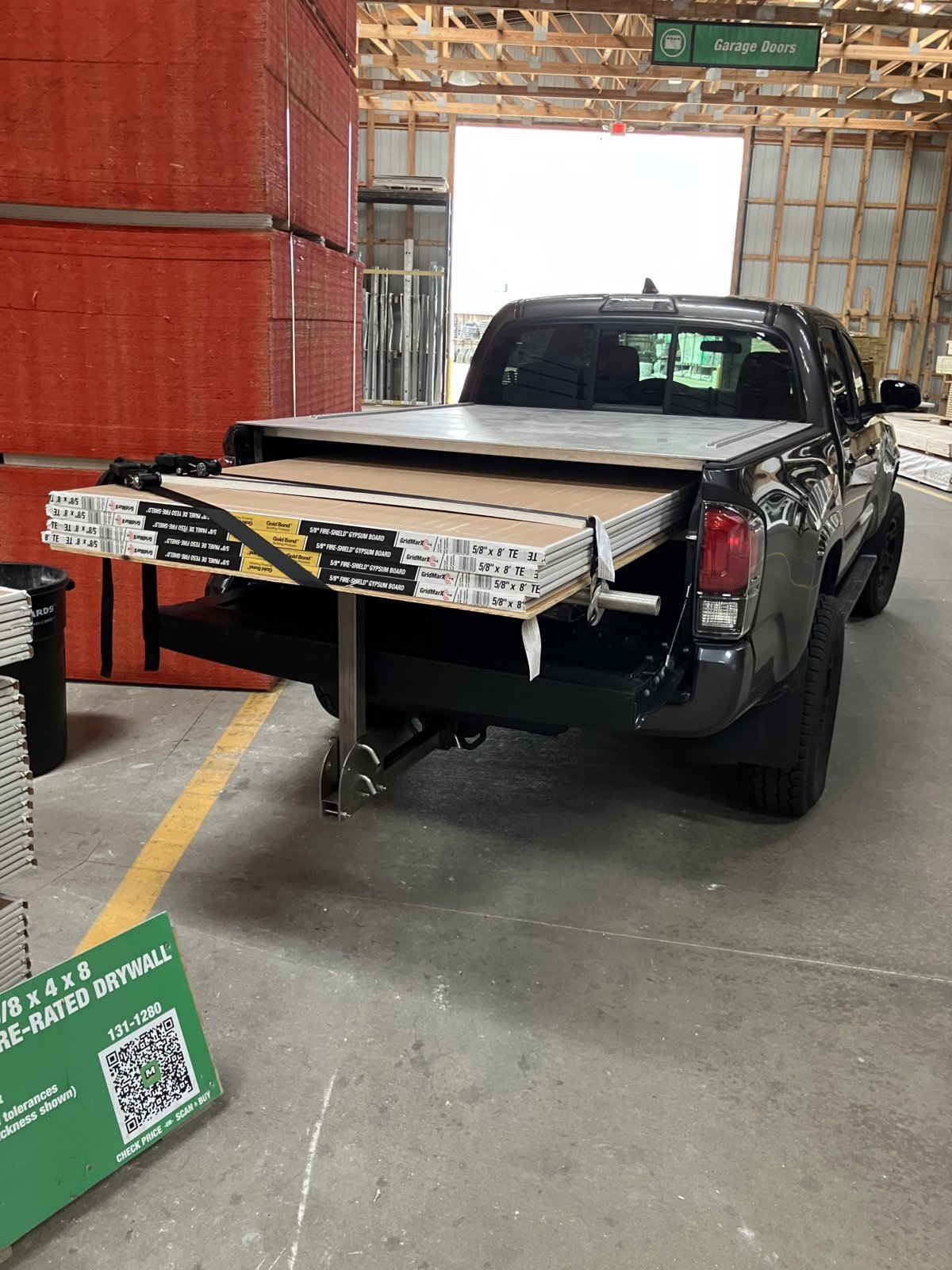

    Made myself a bed extender and finally got to use it yesterday.

    Cool! :welder: DIY is the most fun! :cheers:

    Dude, that’s an elegant solution!

    Wow! Good on you for your ingenuity! :thumbsup:
