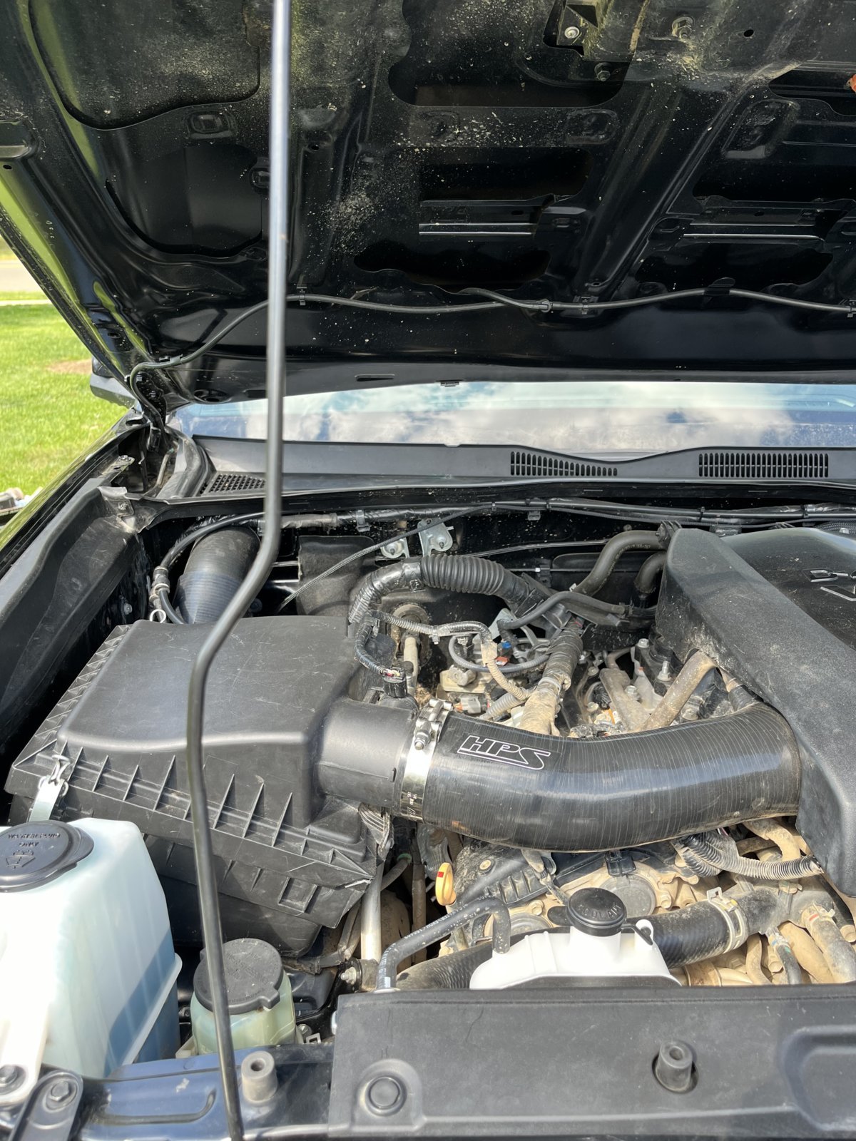

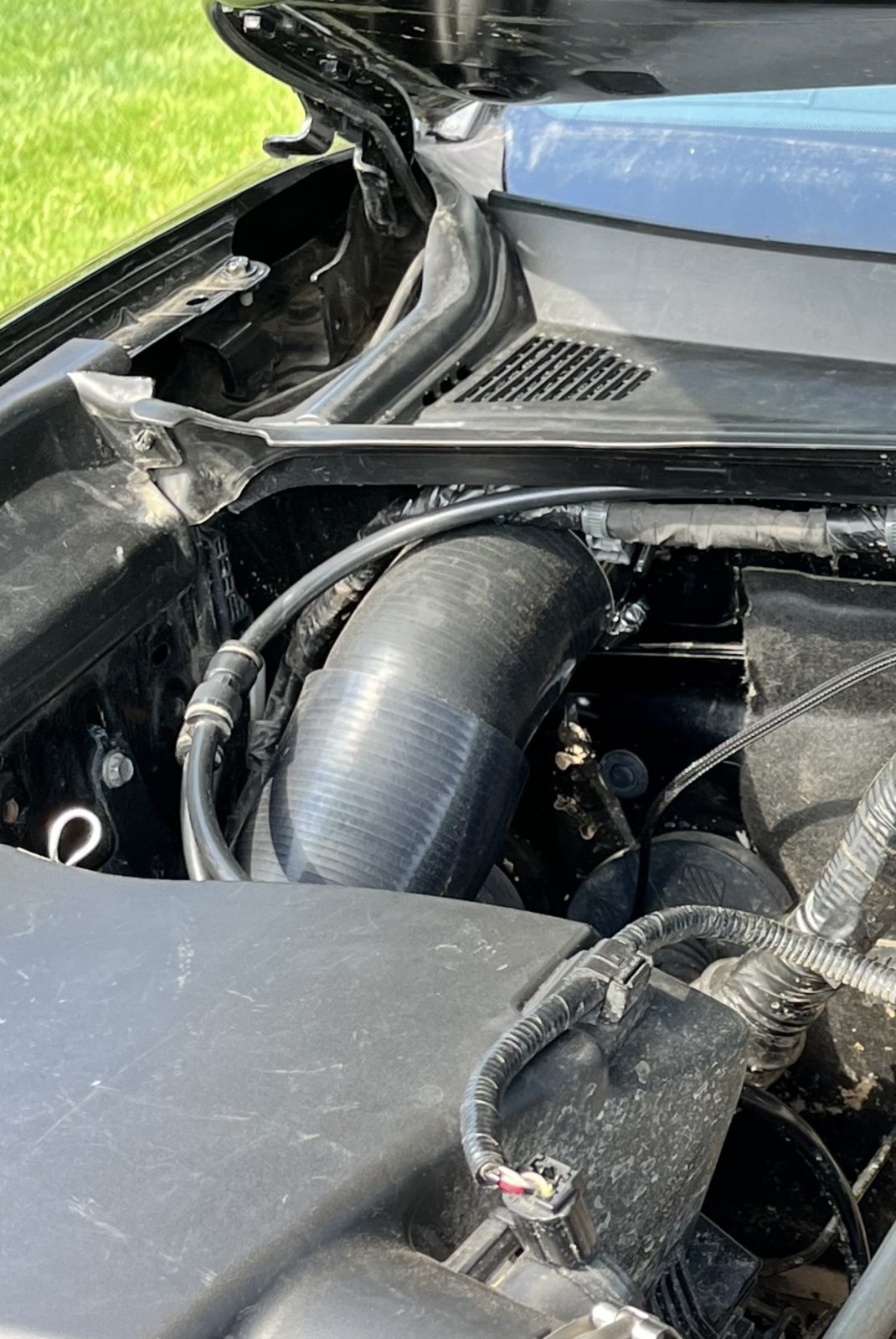

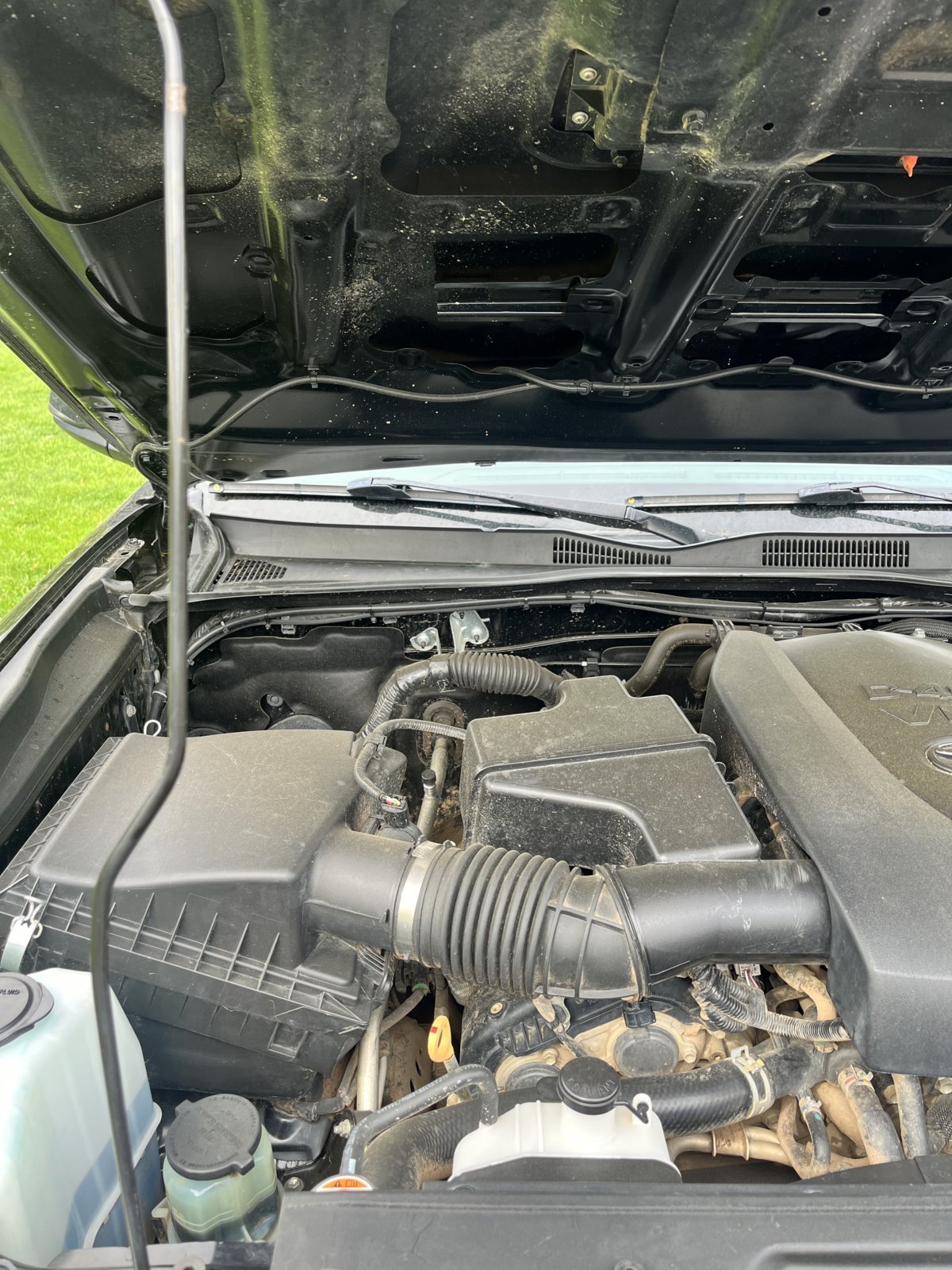

    Cowl intake mod and HPS silicone hose
    Before:
    After:

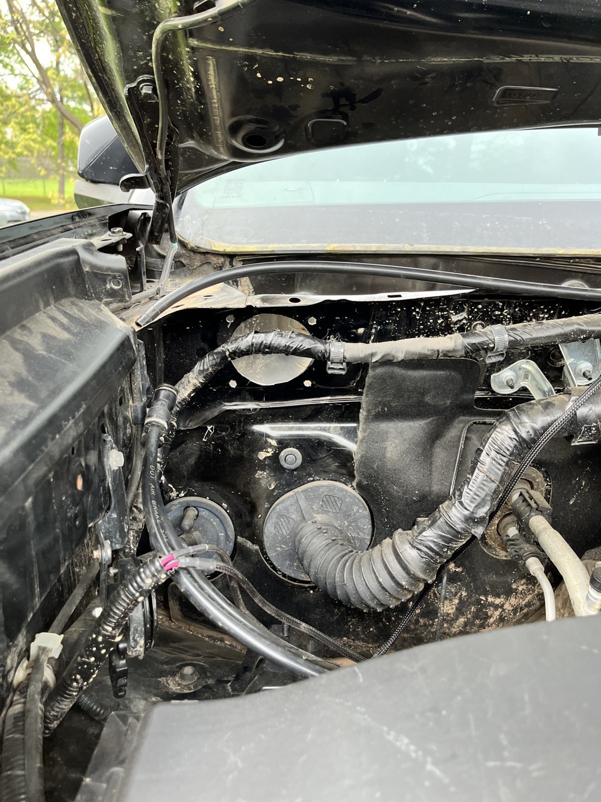

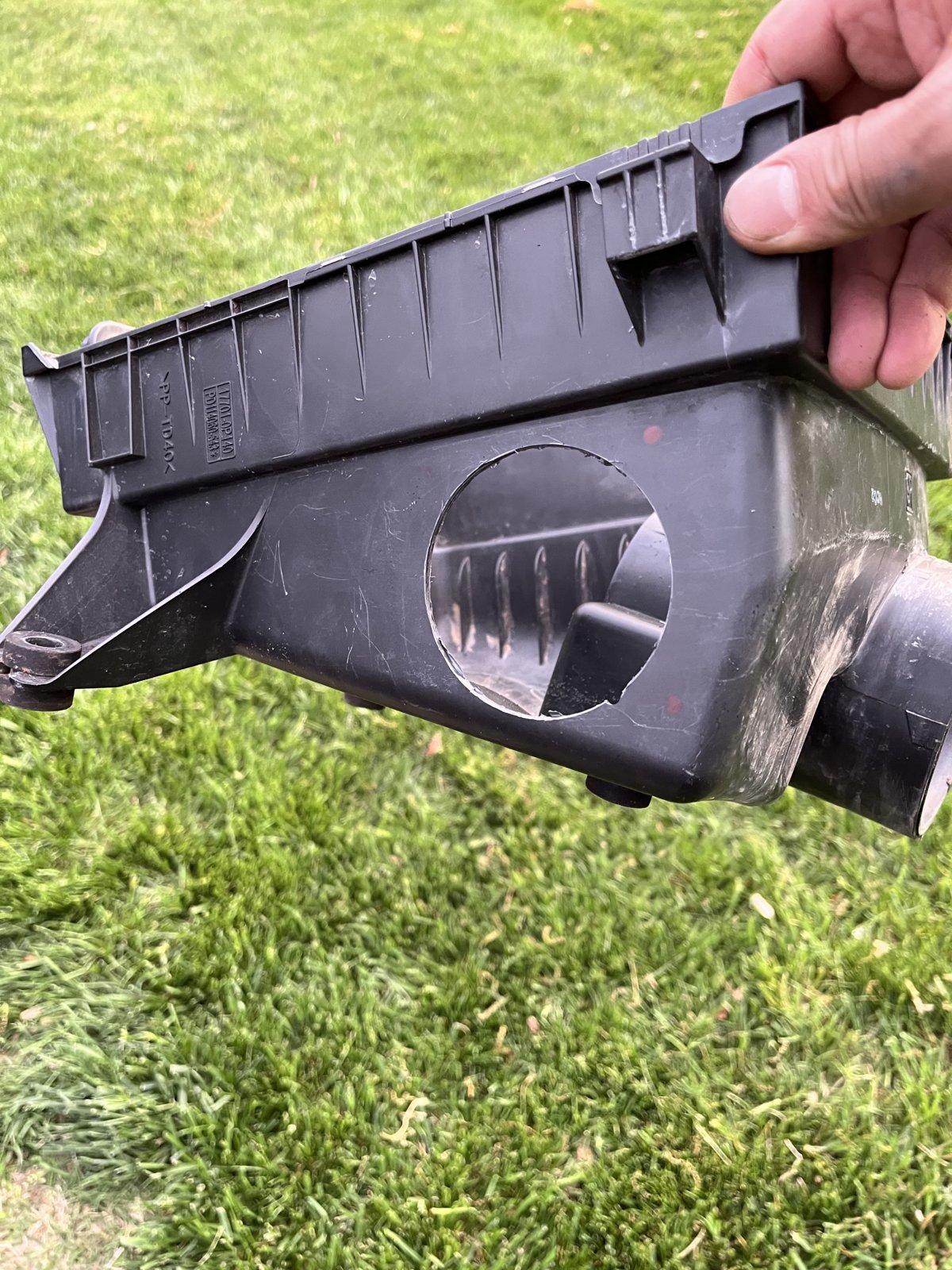

    Actually i removed it and plugged up the intake on the side of the fender

    Where does the air box pull from now?
  11. Apr 24, 2024 at 12:07 PM
    hokiehunter19
    hokiehunter19 Well-Known Member
    Aug 7, 2019
    #301506
    129
    From the cowl

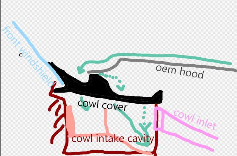

    I don’t know that I would use the cowl for my intake though. I’ve seen some downpours lately, I think that airbox would be filled with water.

    Not my drawing, but there’s a whole thread on here explaining how you’d have to be submerged over the hood for water to enter the airbox from this location
    https://www.tacomaworld.com/threads/3rd-gen-cowl-induction-snorkel.731453/
