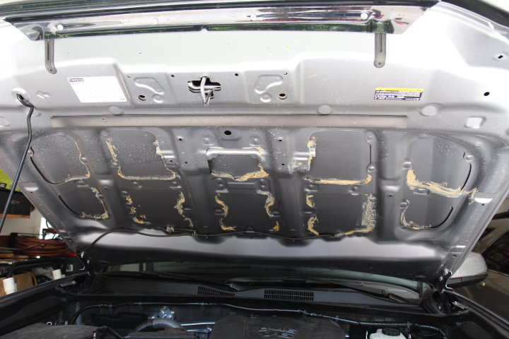

    Update 8-11-16 , After letting the liquid nails dry for 2 days , I went for a ride and my hood is finally stable and no longer vibrates / flexes over bumps etc. Finally ! I did not want a new hood because the paint never quite matches , that is why I did not press it with the dealer .

    Liquid Nails is good stuff.

    The dealership fix a little of the hood flex but there is still a noticeable amount. I was thinking about using a clear silicone to try and accomplish exactly what you did here.

    I am sure there are many products that will work. I think something that dries flexible , but not too flexible so that the hood skin still bounces .
    The dealer sent me to a body shop . The body shop did a fix. I drove around the block and went back to the body shop because it was still flexing ,and they added more . It still was not right . This was why I did it myself. I have used liquid nails on tiles , and bricks and sheet metal before and it has been through all outdoor seasons from 110 degrees F to below 0 F . It has not failed yet . I had an extra tube so i used it .
    I should also note that the gaps from the hood skin to the support frame were anywhere from 1/8" to 1/4" at the areas where I had problems . This was seriously a crappy build . But all in all it was not going to leave me stranded anywhere .

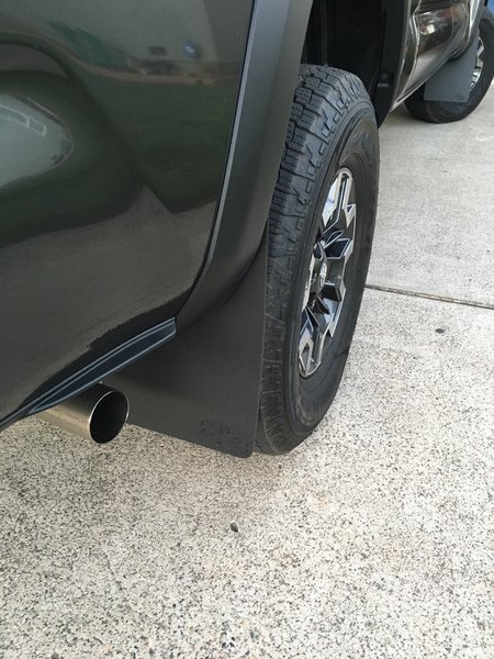

    Removed the hard OEM mud flaps that the dealer added onto my TRD OR, and replaced them with the more flexible RokBlokz mud flaps so they don't get ripped off by a rock when I off road. Why they include such hard mud flaps on the Off Road version is baffling to me. Anyway...here are a couple pics....install was smooth and coverage looks good. Well see how long they last once they start getting bent back on the trails I want to do.

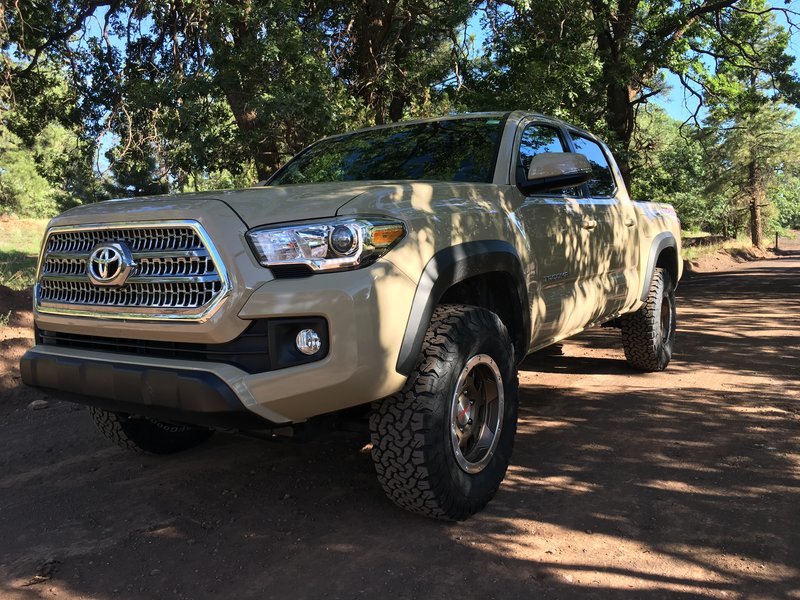

    TX baja bronze wheels and 265/75R16

    Looks great. I'm assume no rubbing?

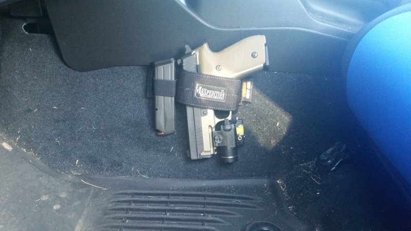

    Simple mods today and yesterday, excuse the dirty interior, hadn't had a chance to detail her since I got home so far. This was just to see how well it fit there, might add some hook and loop to the side of the driver door and mount it to the door. And my tailgate decals turned out awesome thanks @rrentrop!
