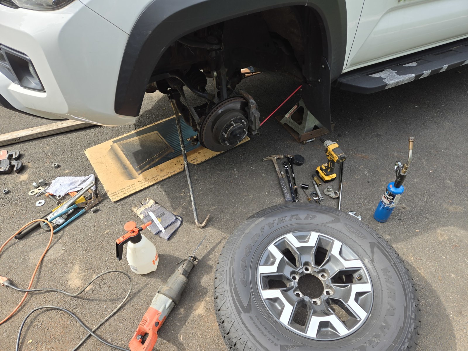

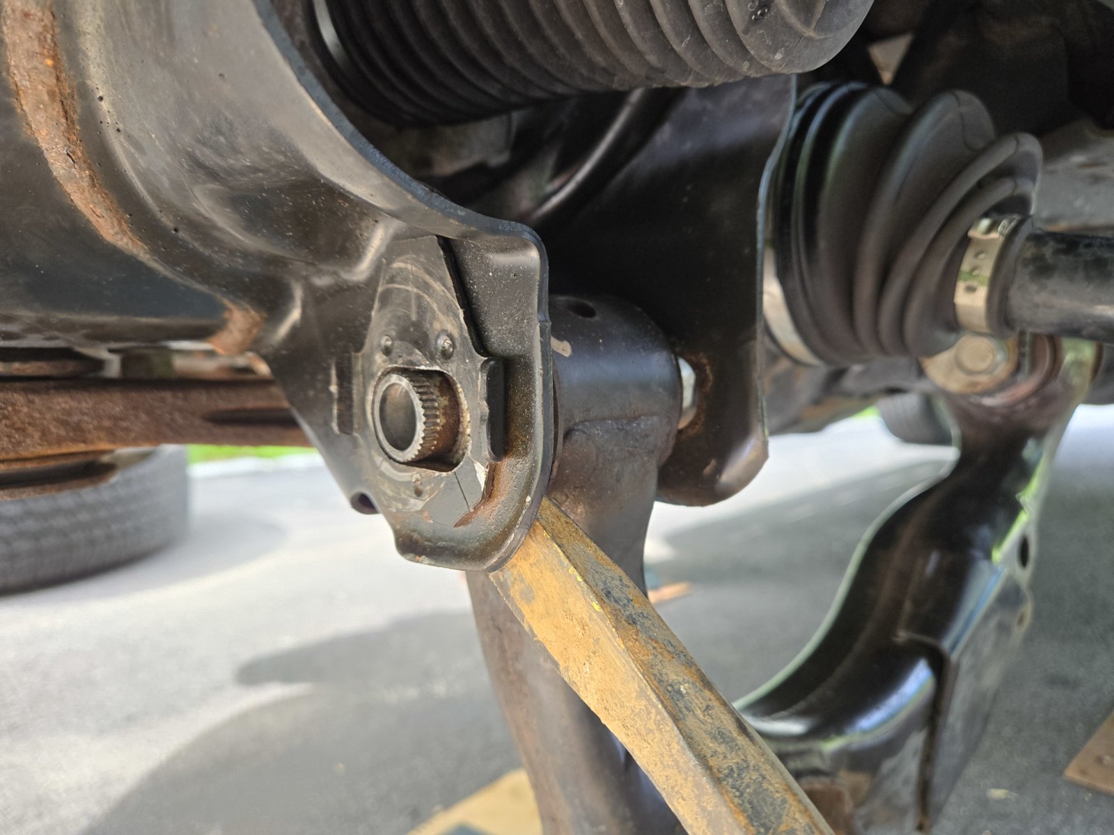

    This was supposed to be a post about me installing my new Bilstein 5100s with 1.5" lift on the front. But I ran into a bit of a hiccup with the lower control arm. You guessed it, the cam seized to the inner bushing sleeve. It's 82k miles old.
    I'm well aware of the issues with these cams/bolts, I just didn't think that it would be this bad on a six year old truck. 20240511_160422.jpg
    I tried everything. Even made a DIY puller out of pipe and threaded rod. Wouldn't budge a millimeter. So after hours of struggling I cut it off. 20240511_171022.jpg

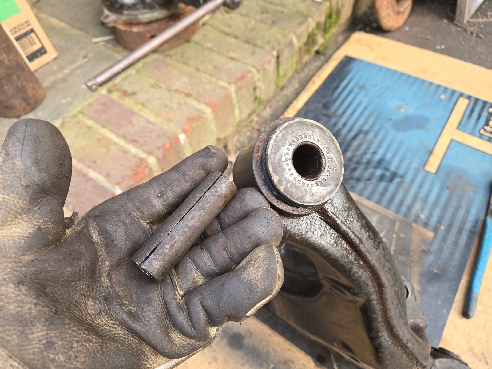

    As for the bushing, it seemed fine. Same with the lower ball joint and control arm itself. I'm going to keep them until the ball joint fails. Here's how I got the old cam sleeve out. 20240511_182608.jpg
    Now I'm just waiting on a replacement $20 cam bolt. In the meantime maybe I'll do my ECGS bushing. Everything is already torn apart for it. Stay tuned for the next post.
