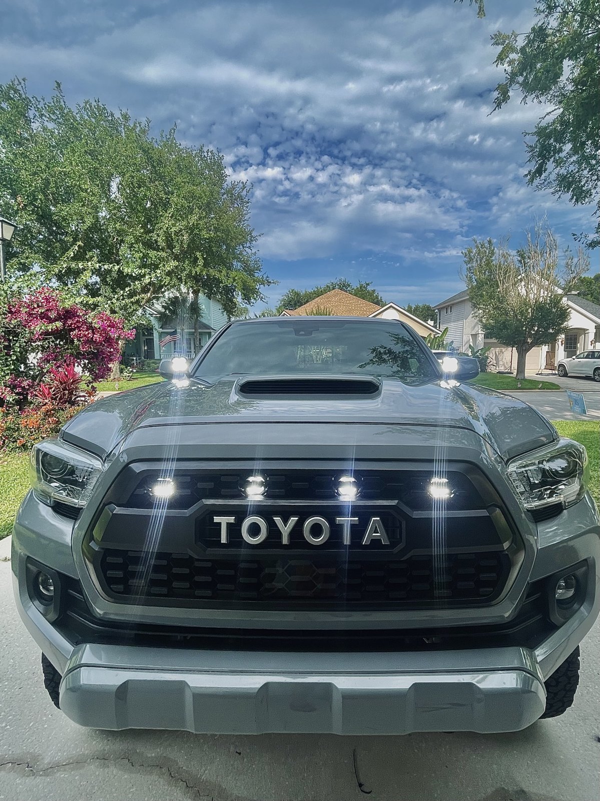

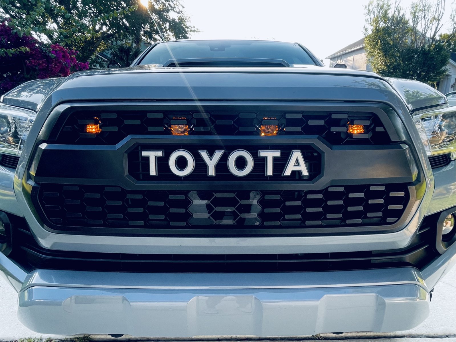

    I’ll be honest. I’m not sure, the two middle are spot beams so probably not. I have them angled down the line enough that they get increased distance but not straight into someone’s rear view.
    the two outside pods are the wide and I think they may be legal as an auxiliary fog.
    I do t really plan on using the full power setting in situations other than a/ my high beams.
    I believe they can be wired that way. They are currently wired to a two position switch. I would like to figure out how to use them as DRL’s w/o the switch, I just haven’t researched it yet. I just rewired the SS3’s to a separate switch.

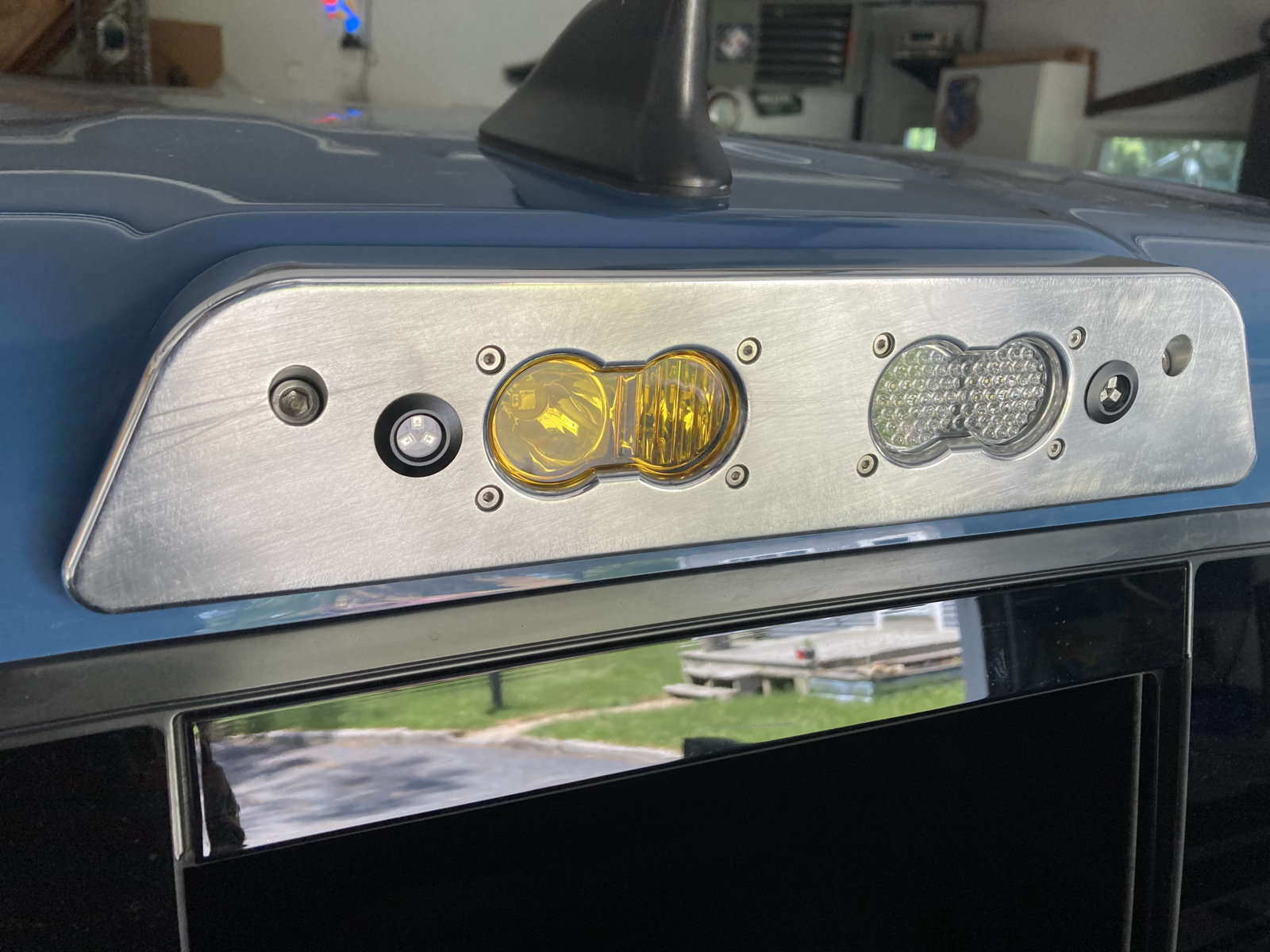

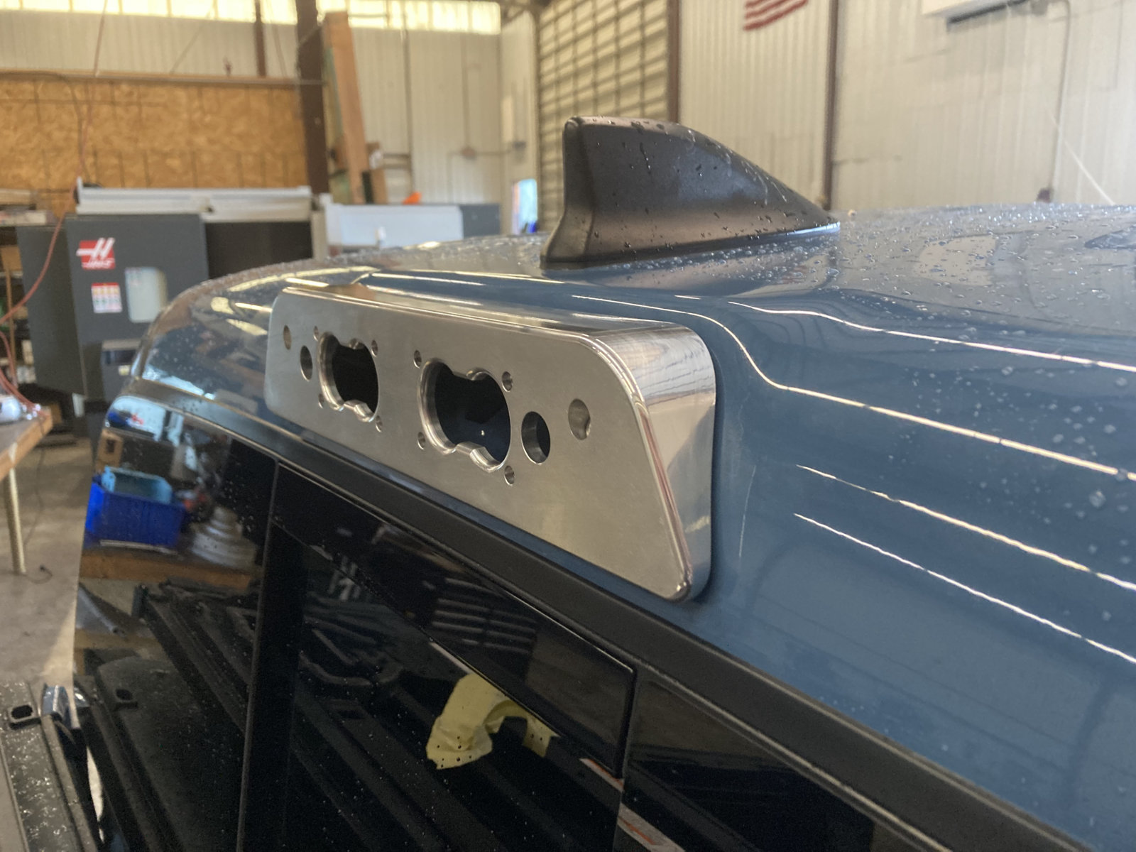

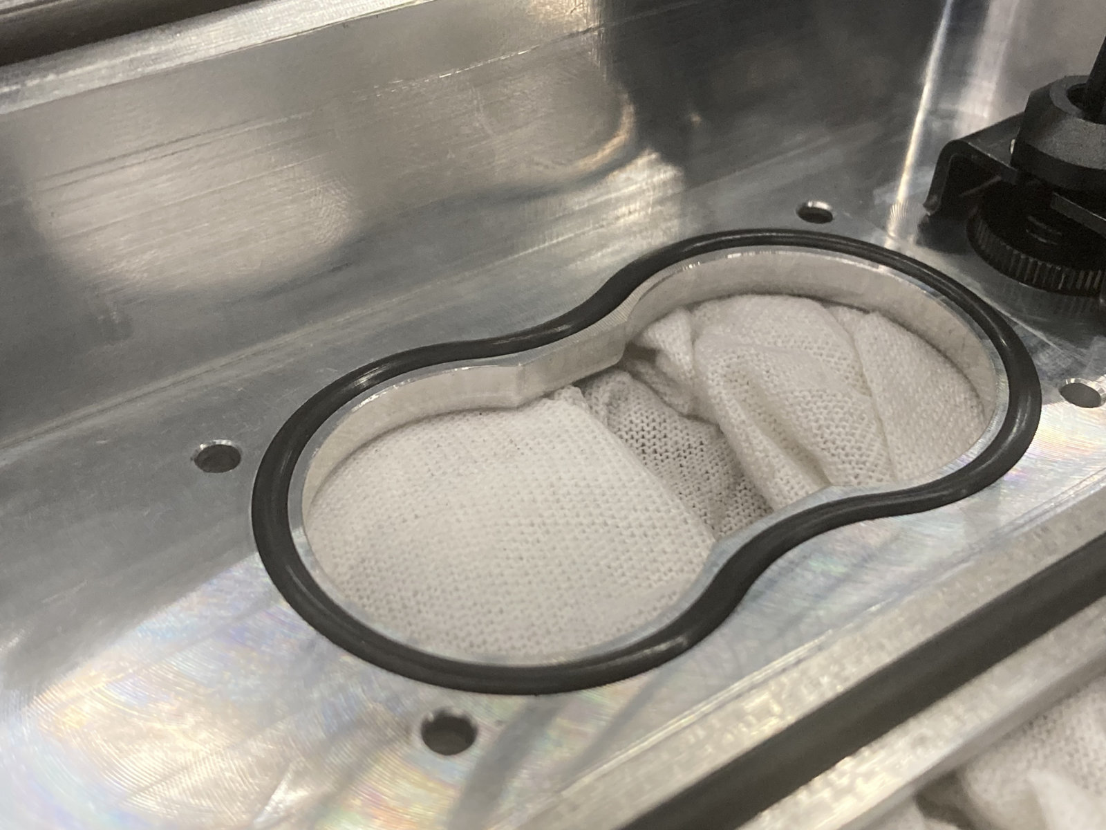

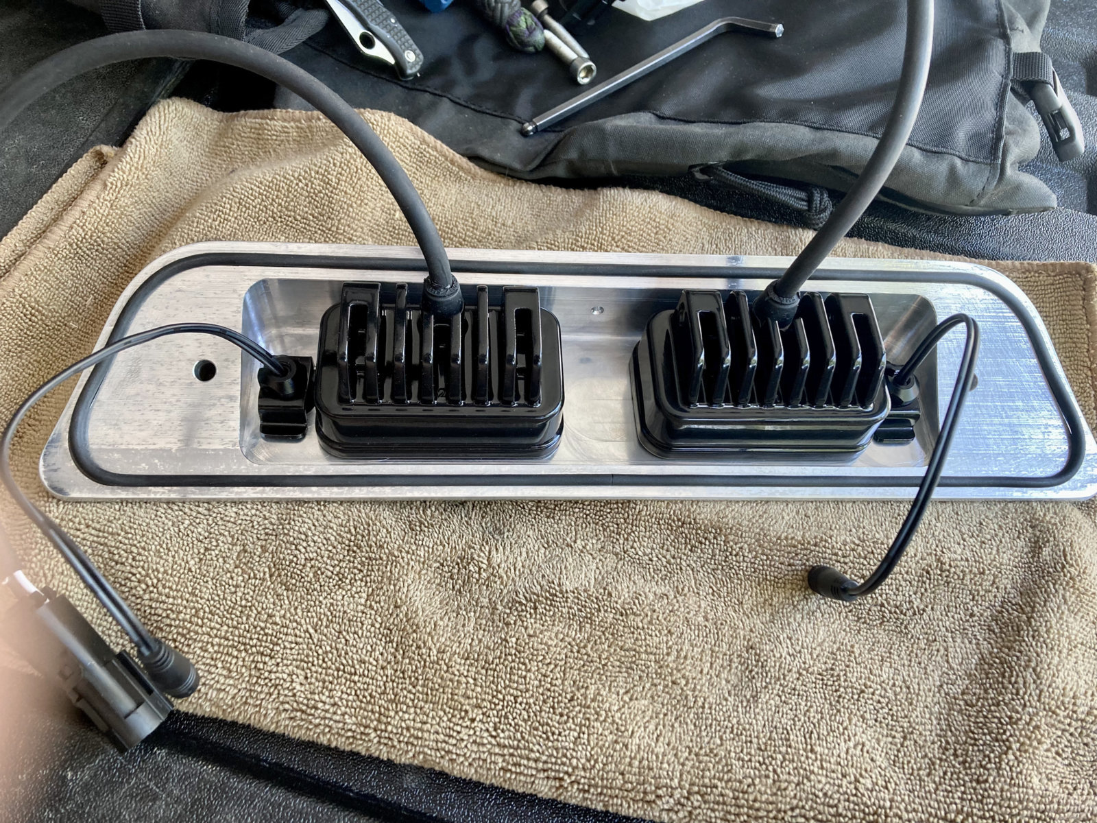

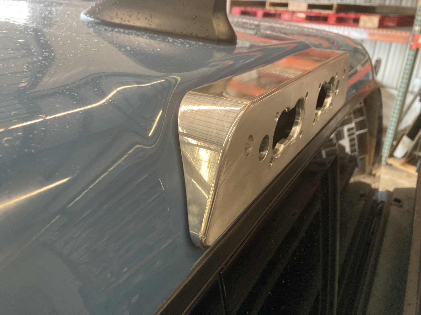

    Been working on a fun little project to mount a couple of S2's into a third brake light. Kind of a mix of ideas that were already out there. Still in the testing phase but seems pretty watertight. It better be, as it has 15 o-rings in it! Mounted two S2 pros, one for a chase light, the other for a work light. The two VLEDS pucks are wired for the stop lights. Also left a center drilled hole to blow out for an NMO antenna mount in the future. Going to most likely anodize it when complete.

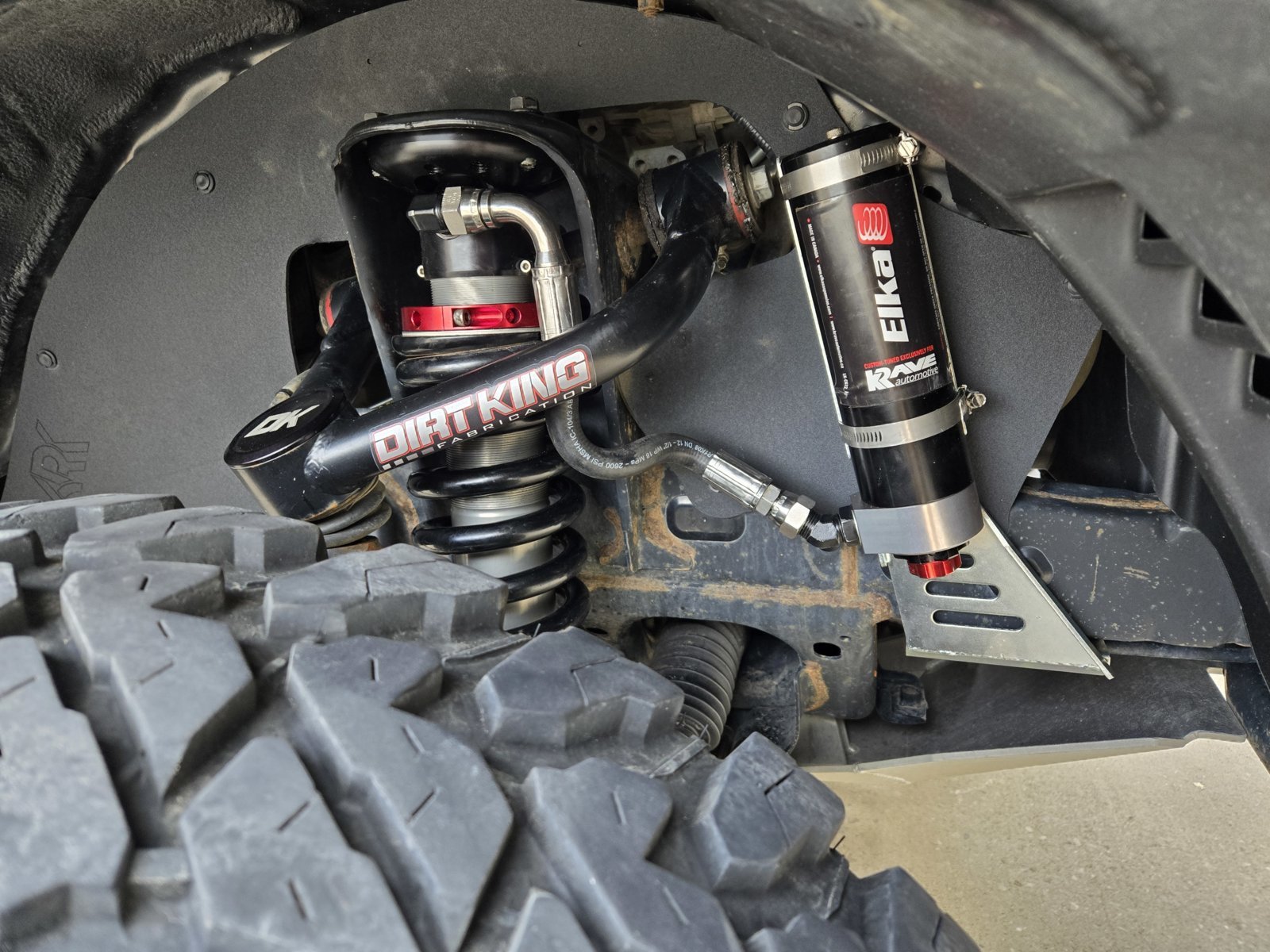

    Added some front elka 2.5 DC's see how long it takes for me to blow these ones up. My 2.0's were not up to the task of my shenanigans.

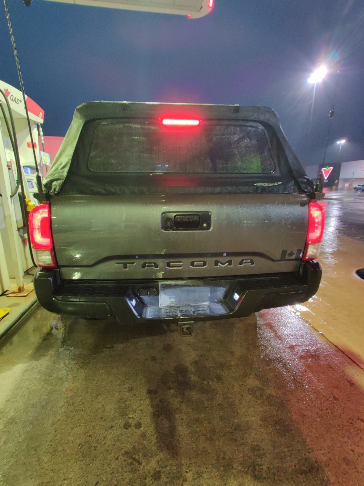

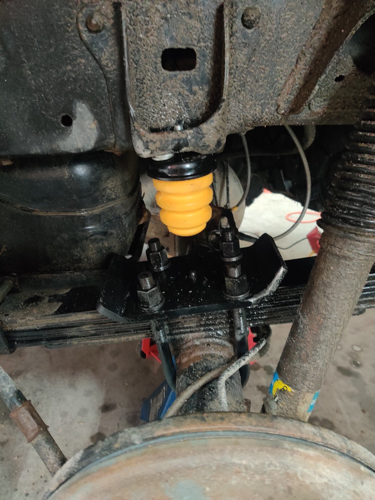

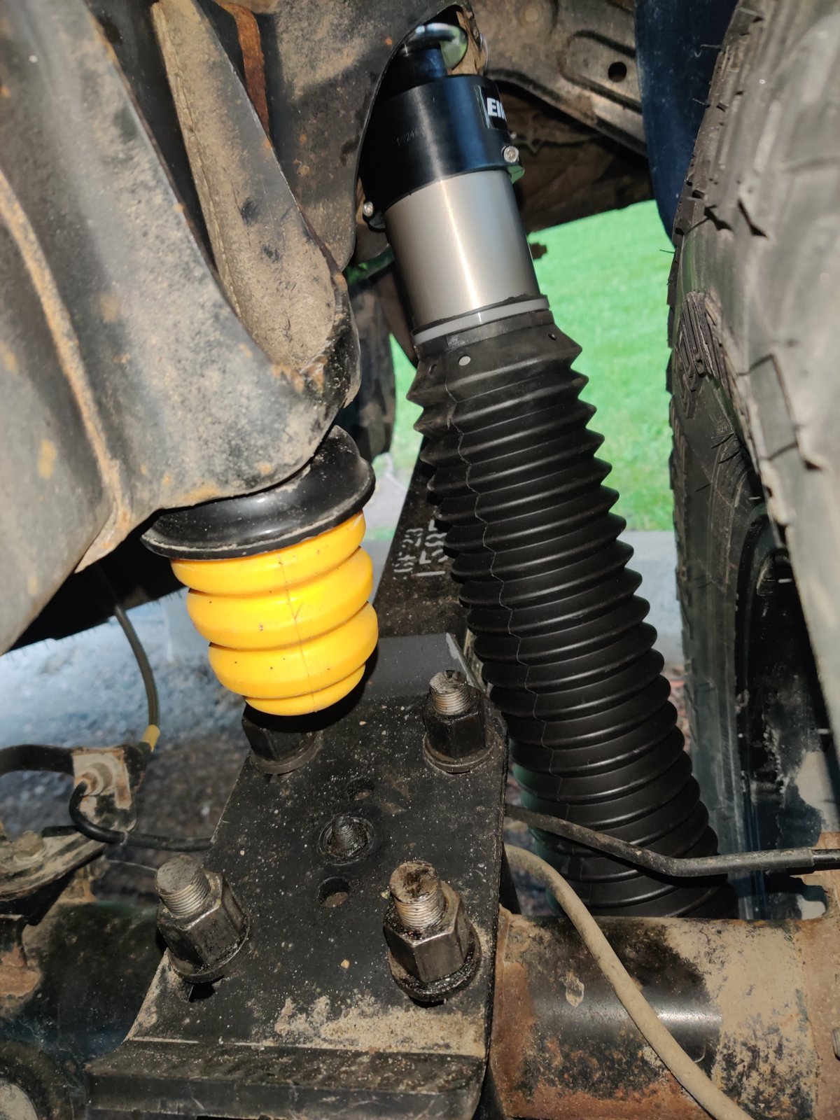

    TRD go brrrr
    All the mods
    Softopper third brake light
    Ubolt flip kit and gm bump stop mod
    And elka 2.5s

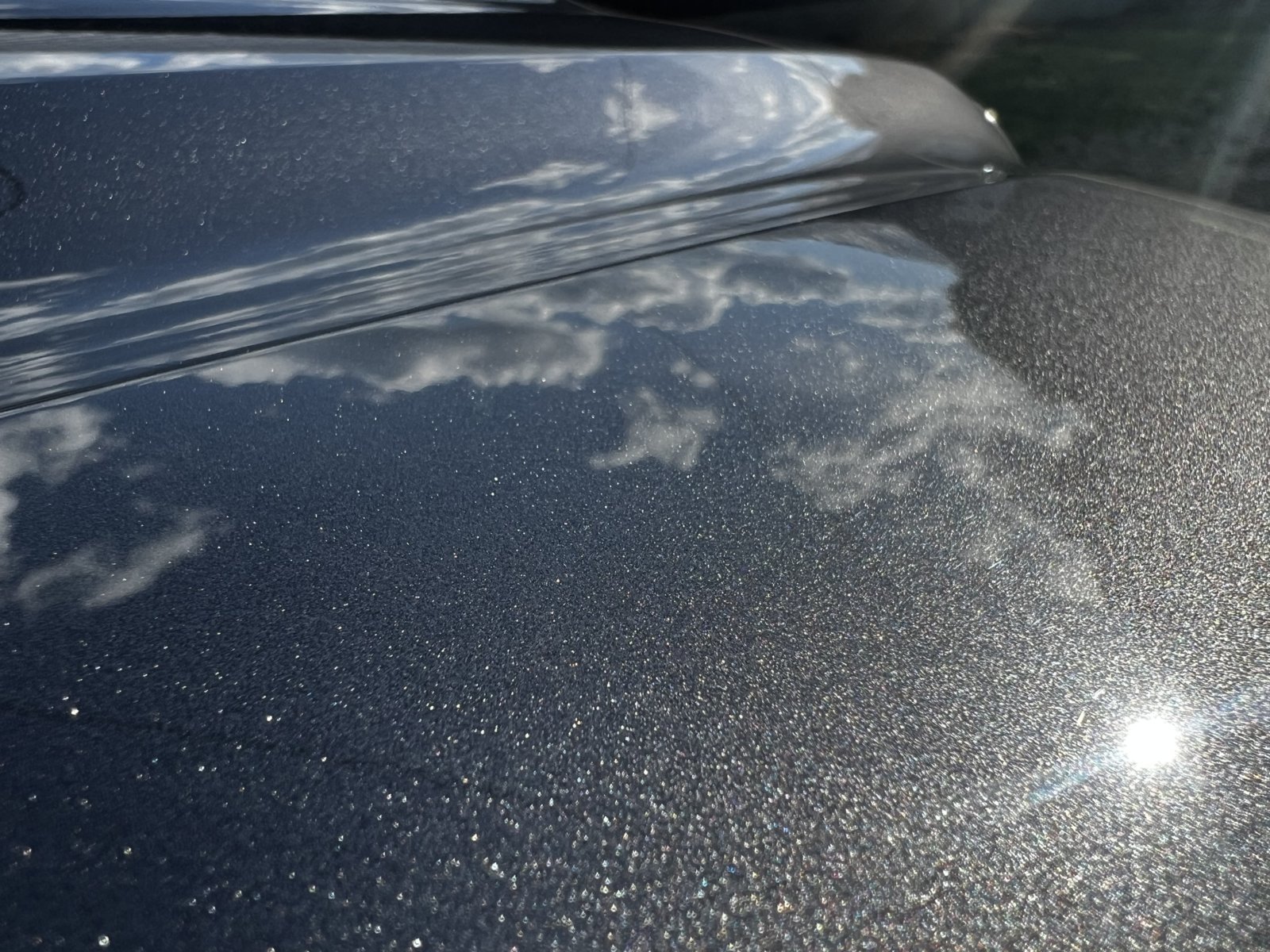

    Washed it now it looks all shiny. The MG looks so good.:pccoffee:IMG_2633.jpg IMG_2628.jpg
