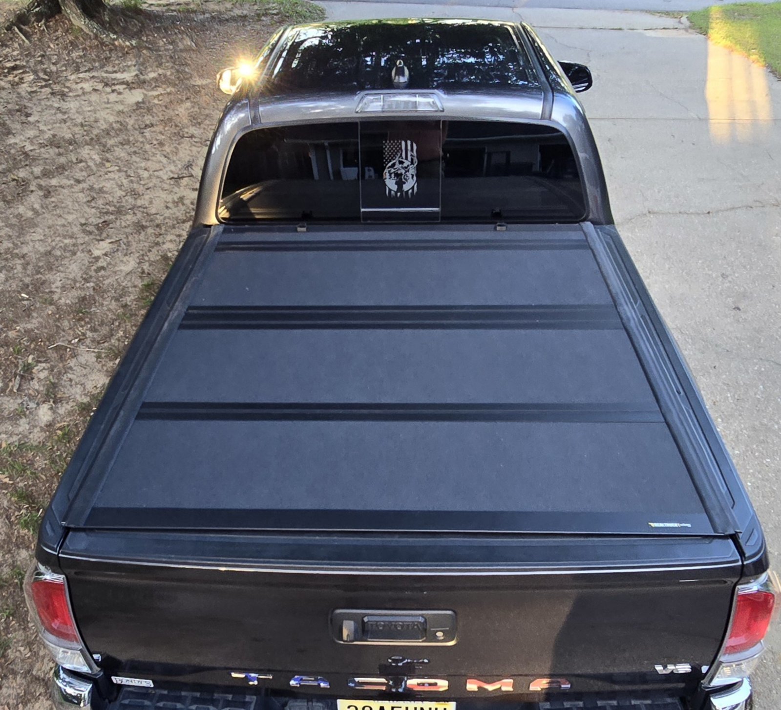

    20240529_190107.jpg Added a tonneau cover.

  7. May 29, 2024 at 11:34 PM

    Brand new.
    Until it is coated with pollen once again.

    Nice job, just a heads up I have the same cover, i suggest you write to the company and get a few extra plastic pieces sent to you they do tend to break every so often, the pieces I am speaking of are on the corners of the cover where they are half round, if you just tell them one broke, and if you could get a set, they will send them to you for free, i have 3 extra sets, as i have broken one side one month and the other the next month.
