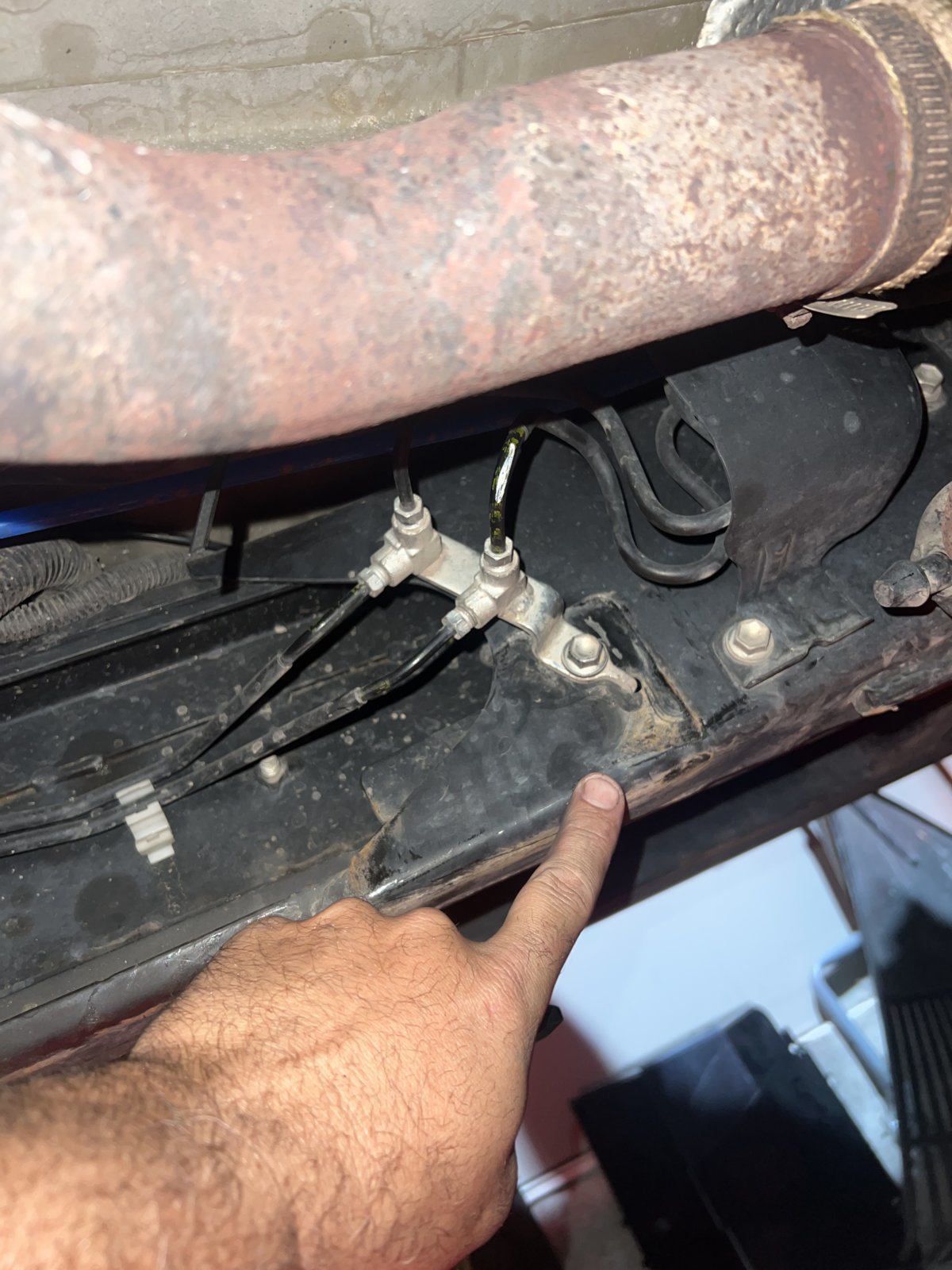

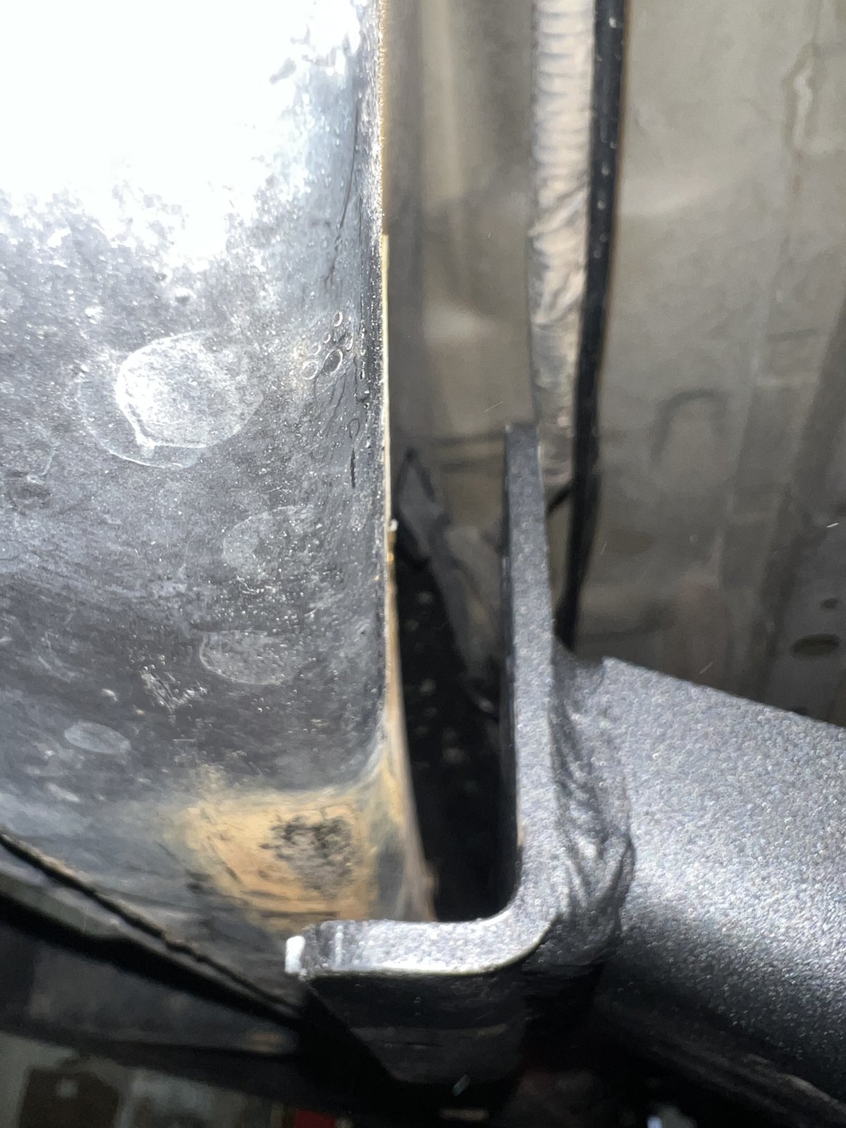

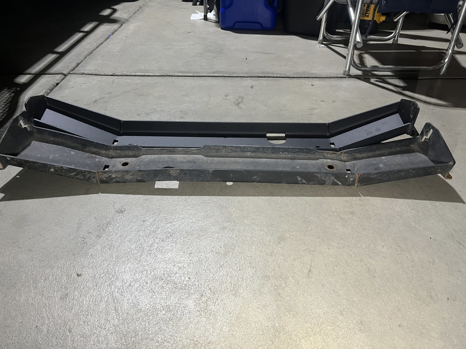

    Been going to battle with the tacoma recently. After fixing the twisted ADD tube off the front diff, still had some vibrations. I found my drive shaft had lost a balancing weight. Picked up a OE spare for $175 from a used part dealer in town with a carrier bearing and popped that in. Gonna balance the old and keep it as a spare.
    Went to reinstall my skids and had 2 threaded holes give up on me, so drilled em out, and welded in a flanged nut to the frame to replace the blown out threads. I also ordered a new TCase skid cross member from RCI bc it was nearly broken in half and touching my TCase. Went to put it in and came up almost 3/4” short. Not sure if this could be from welding deflection at the RCI factory or my frame is bent from the previous crossmember taking such a beating and spreading the frame a tad. Im headed out friday to wheel so I guess I will cut the crossmember at the welds where it kicks up to meet the frame, flatten it out to make it long enough to reach the frame and re weld it, then reinstall it. I might even weld it to the frame- lightly in a way i can easily cut it off when needed.
    you can see in the pics how different they are fresh compared to abused, so tough to say what the problem is. I did take some measurements of the frame, so if anyone without a tcase skid wants to chime in please do
    Under the flag bolt on the driver side that holds the brake line housing (2nd to last pic) : 39-7/16” inside to inside
    Directly behind the frame wrap, where its kinda boxed in, just behind the brake line housing, on the actual frame- not the added steel on top- last pic :40 7/16”.
    I plan on calling RCI in the morning to get to the bottom of it and to check dims/ angles. Chime in if you got time to measure to verify if my frame is a lil tweaked- thanks yall
