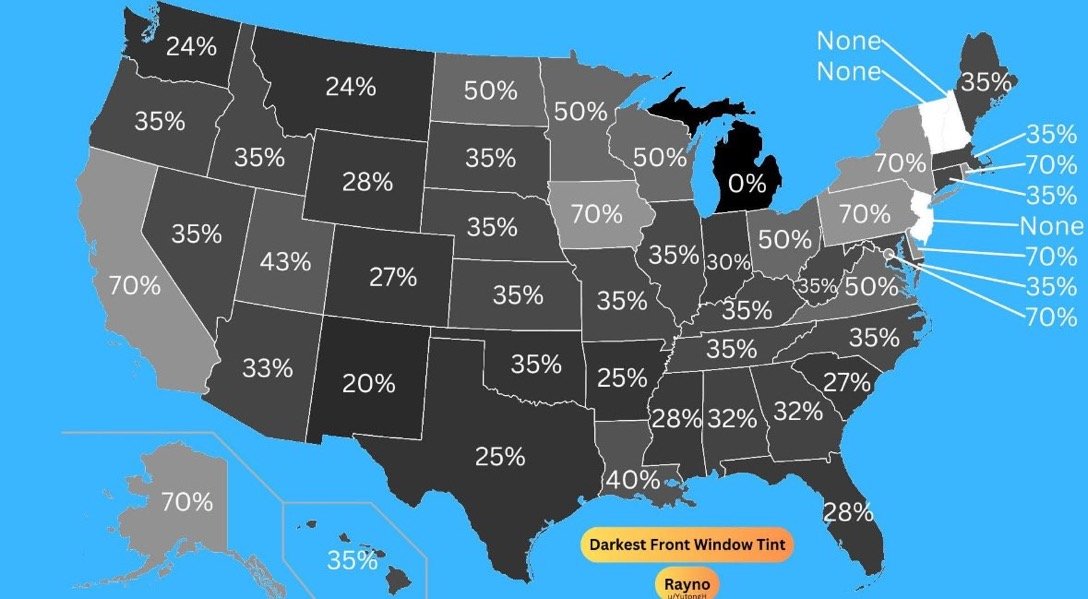

    Looks like 33% is the correct max for Arizona.
    What’s going on in Michigan? 0%?!

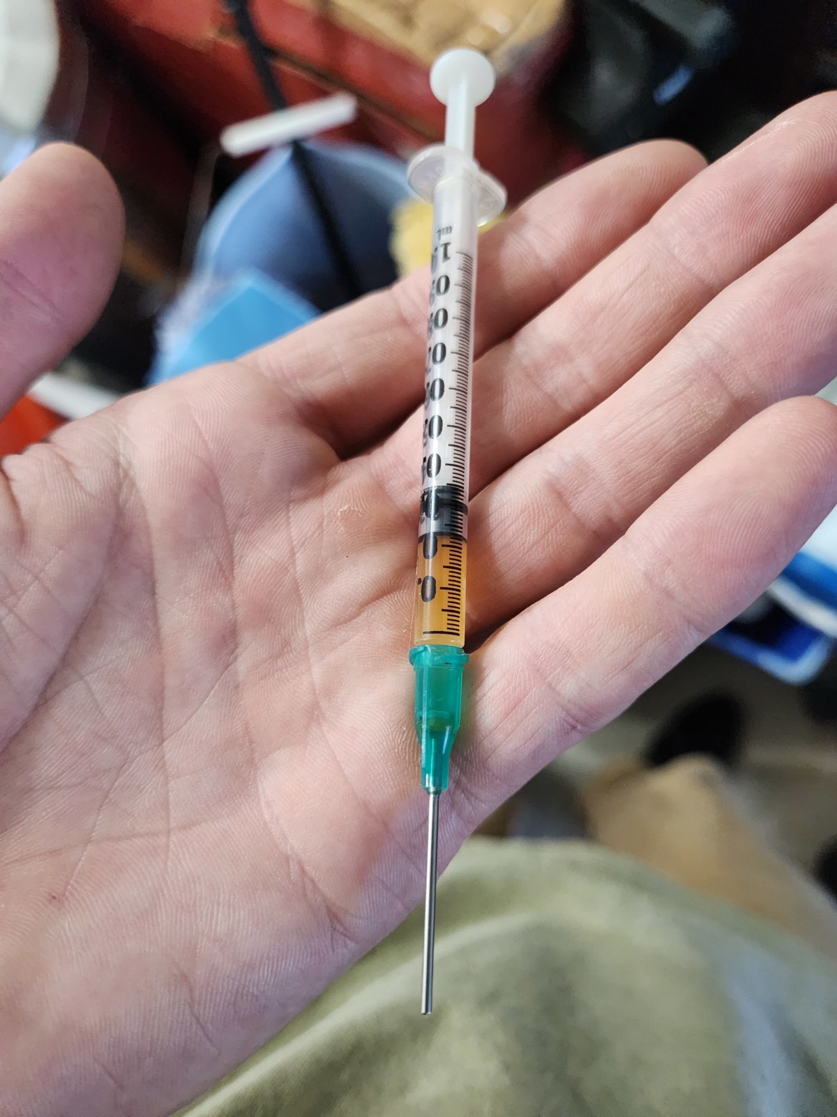

    Heard a bit of creaking from the clutch pedal again when I went to leave work today. I used this bad boy to shoot some sil-glyde straight into the spot where the nubbin sits. Hopefully this lasts longer than a spritz of white lithium grease. I don't know why I didn't think of this sooner.

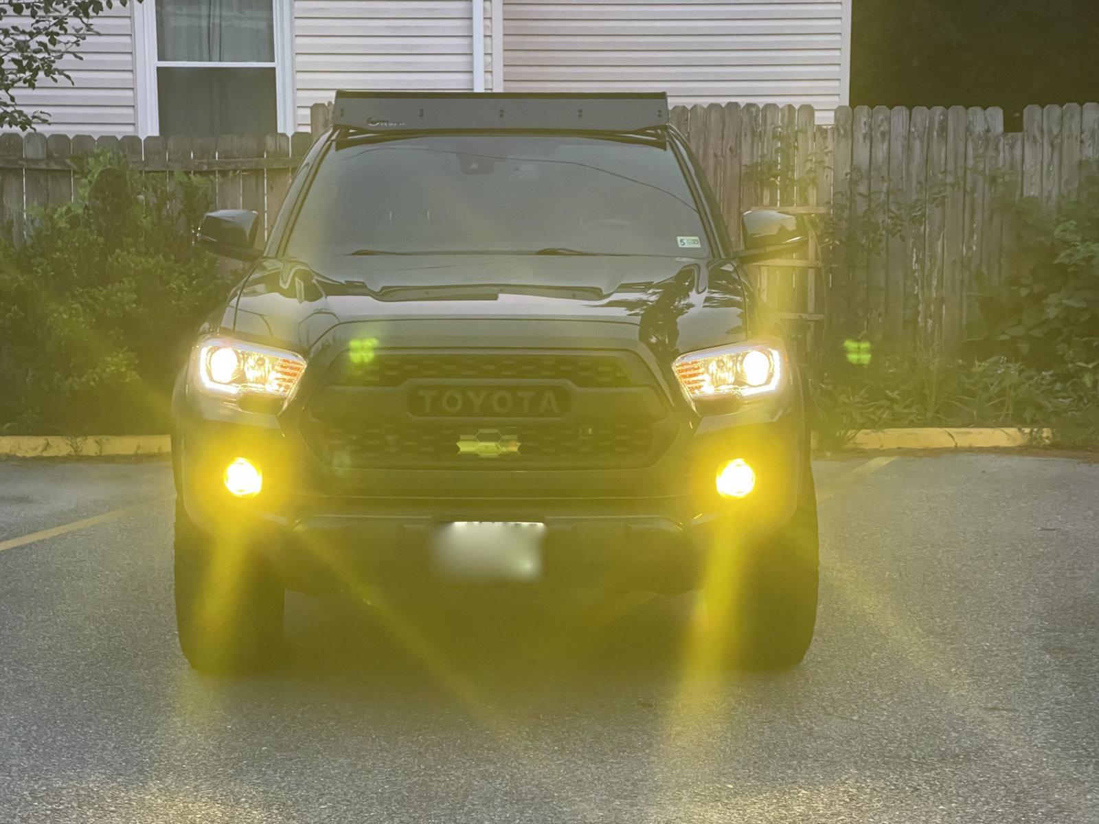

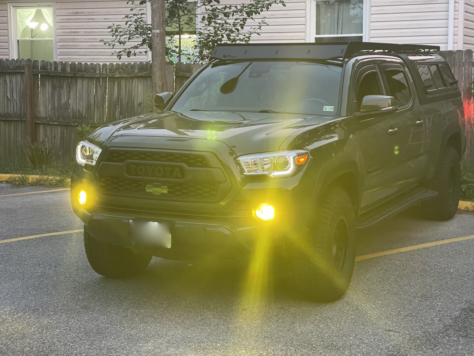

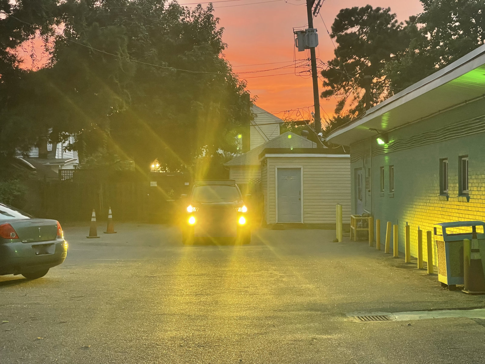

    Finally installed. Last pic was taken about 60 ft away. Might have to adjust down a little. A1BDB6B8-8ABC-489A-8D25-4B8B72A9C7C8_1_201_a.jpg 80124B7E-A7F3-49CF-8735-51BDB0BC6C9F_1_201_a.jpg 4B15C120-00CA-4382-9240-7810741A7063_1_201_a.jpg

    You want to find a level surface and a wall that you can project onto from 25’ back, like the wall on the right. Adjust the fog lights so the top of the fog beam pattern is about 4 inches down from the lamp center.
    https://youtu.be/p5RXq28ZOYo?si=EloF9cfSJtpwbMyJ

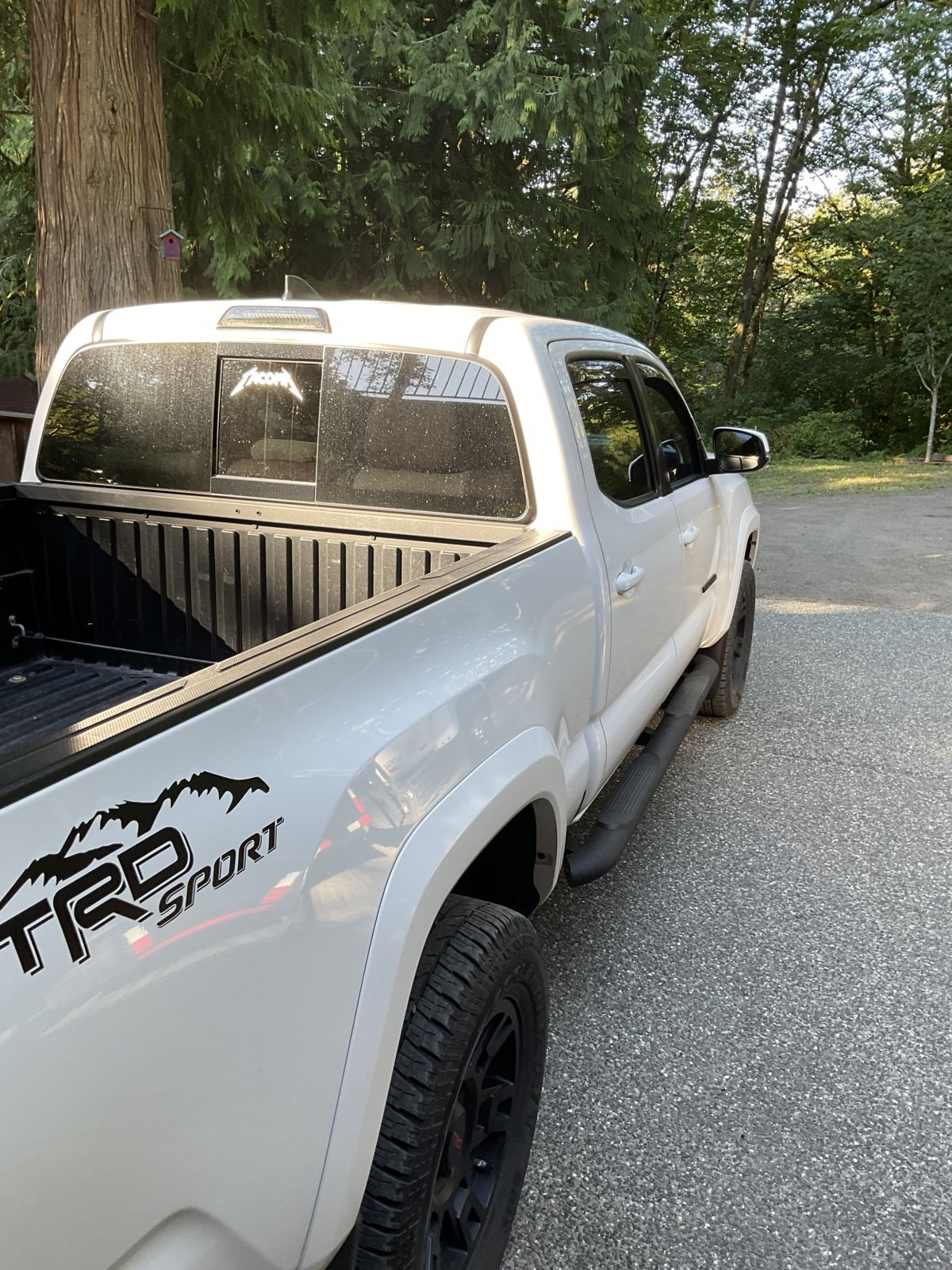

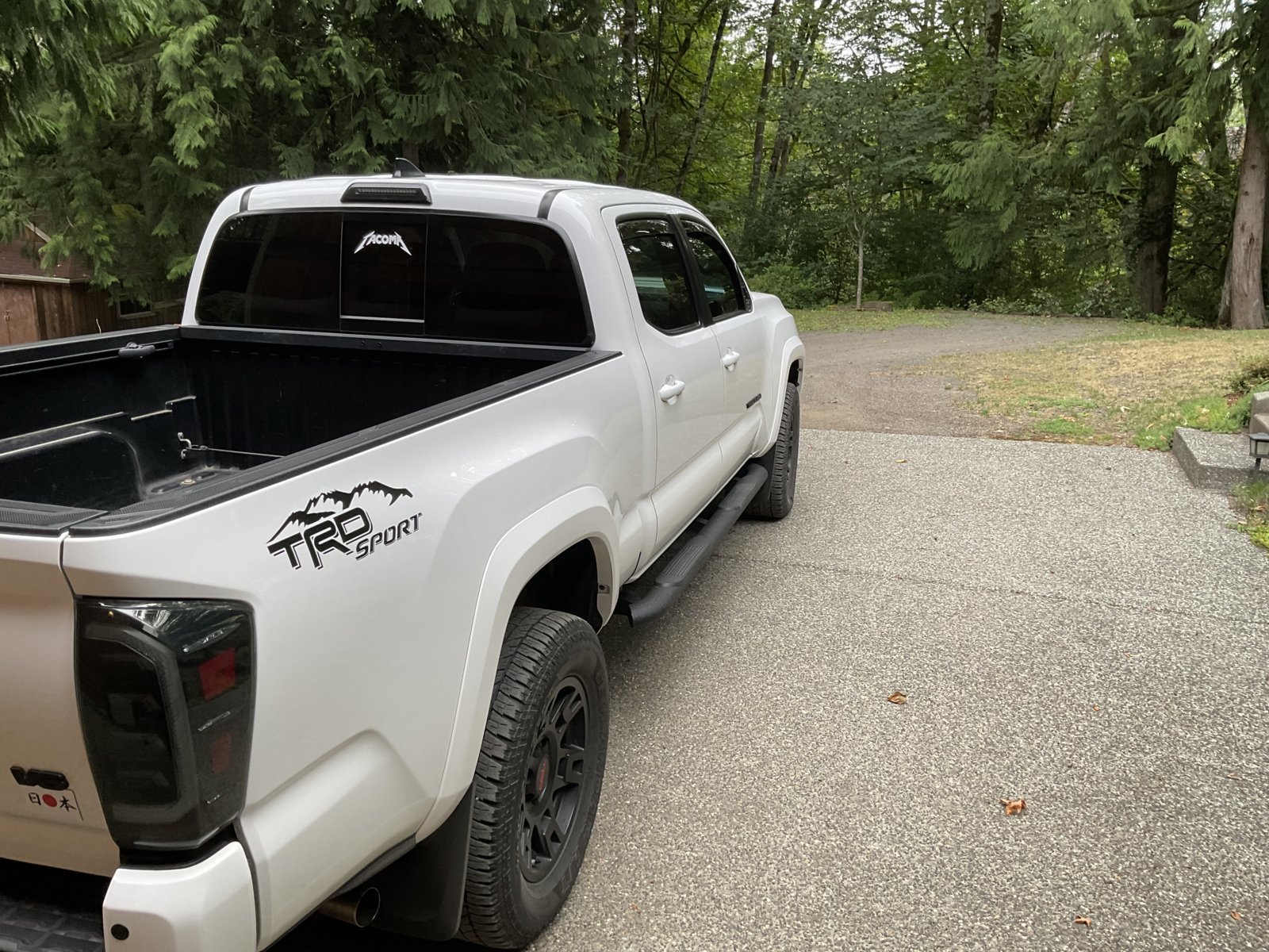

    IMG_1788.jpg Ta Da!! Look, the dealer came through. D-Know is back 100%

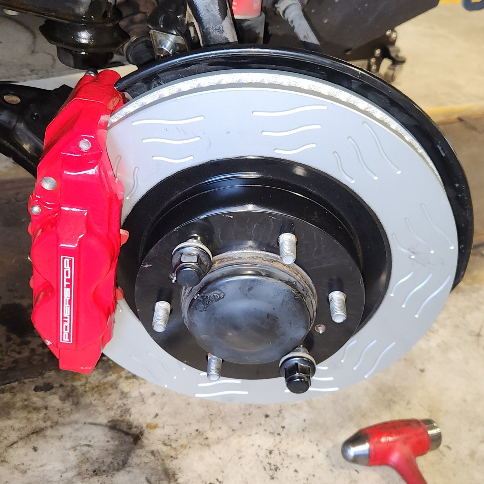

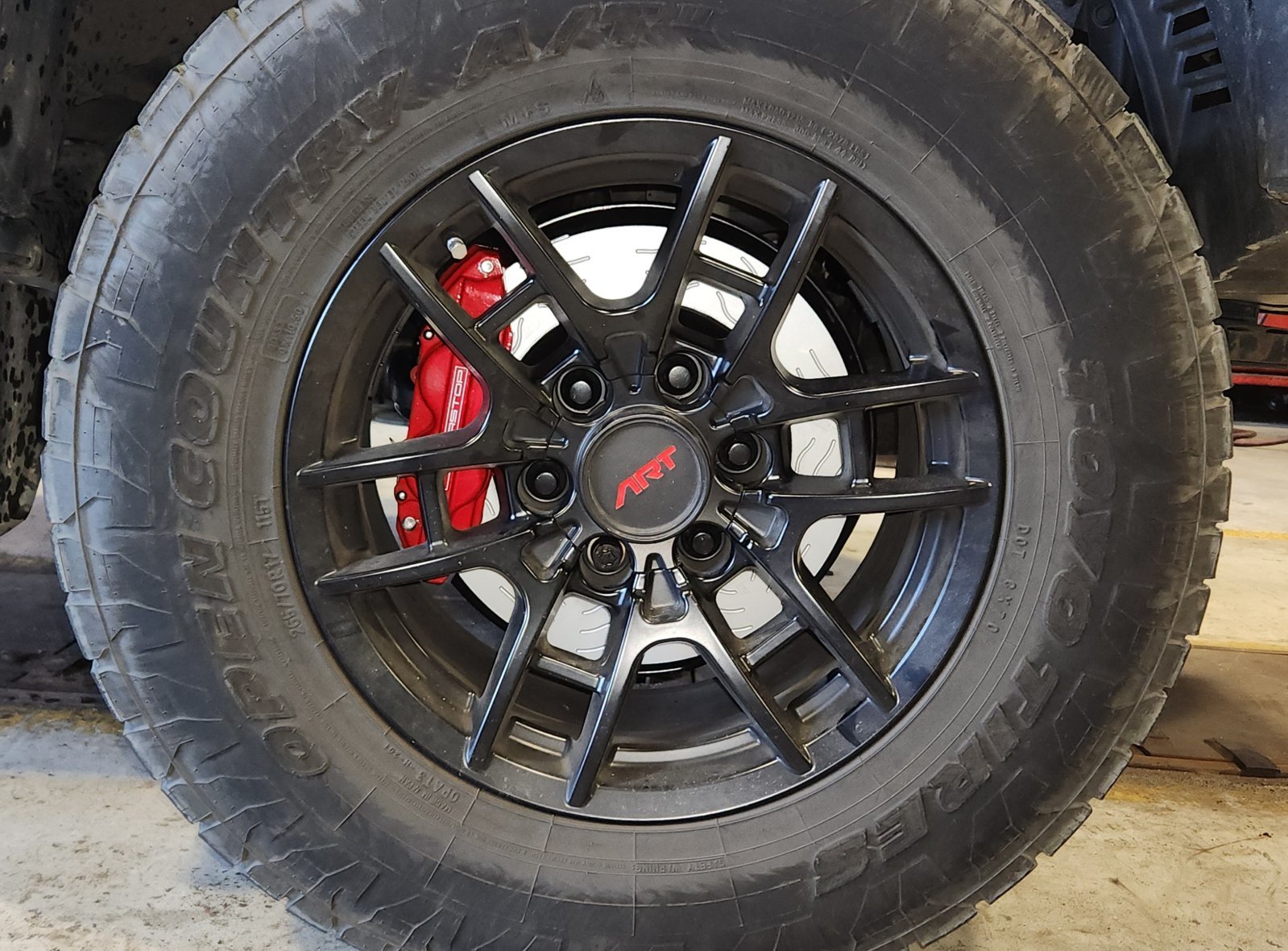

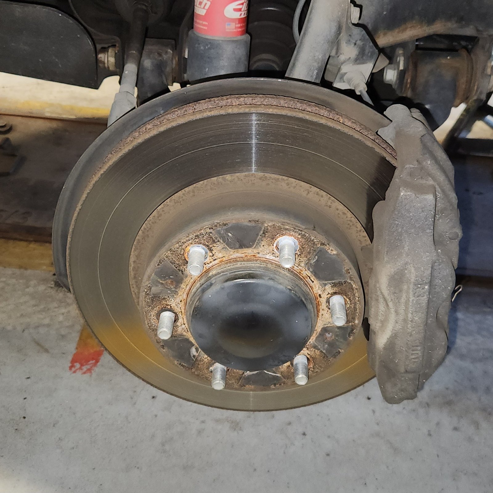

    After 110,000kms, it was time to do a front brake job. So I stepped up a bit and did a 4Runner rotor and caliper swap with TRD pads and braided stainless steel lines. So far I am very happy with the set up. They should work well while towing in the mountains of B.C.
    The original set up.
    The new set up with Raybestos S-groove rotors and Powerstop calipers.
    And the new look thru the wheel.
    My initial impression is very positive with this mod. Everything bolts right up and I feel like I can modulate the brakes better without the bite the stock brakes had.

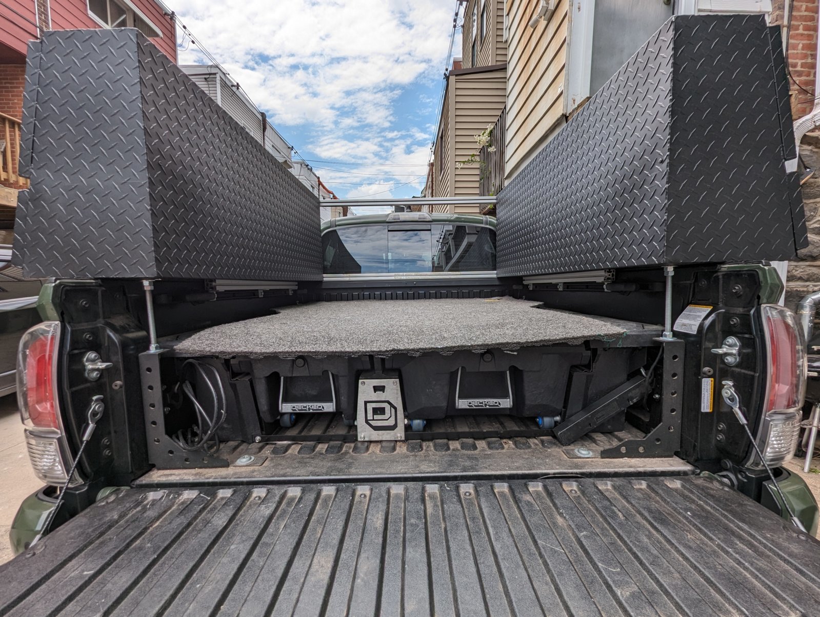

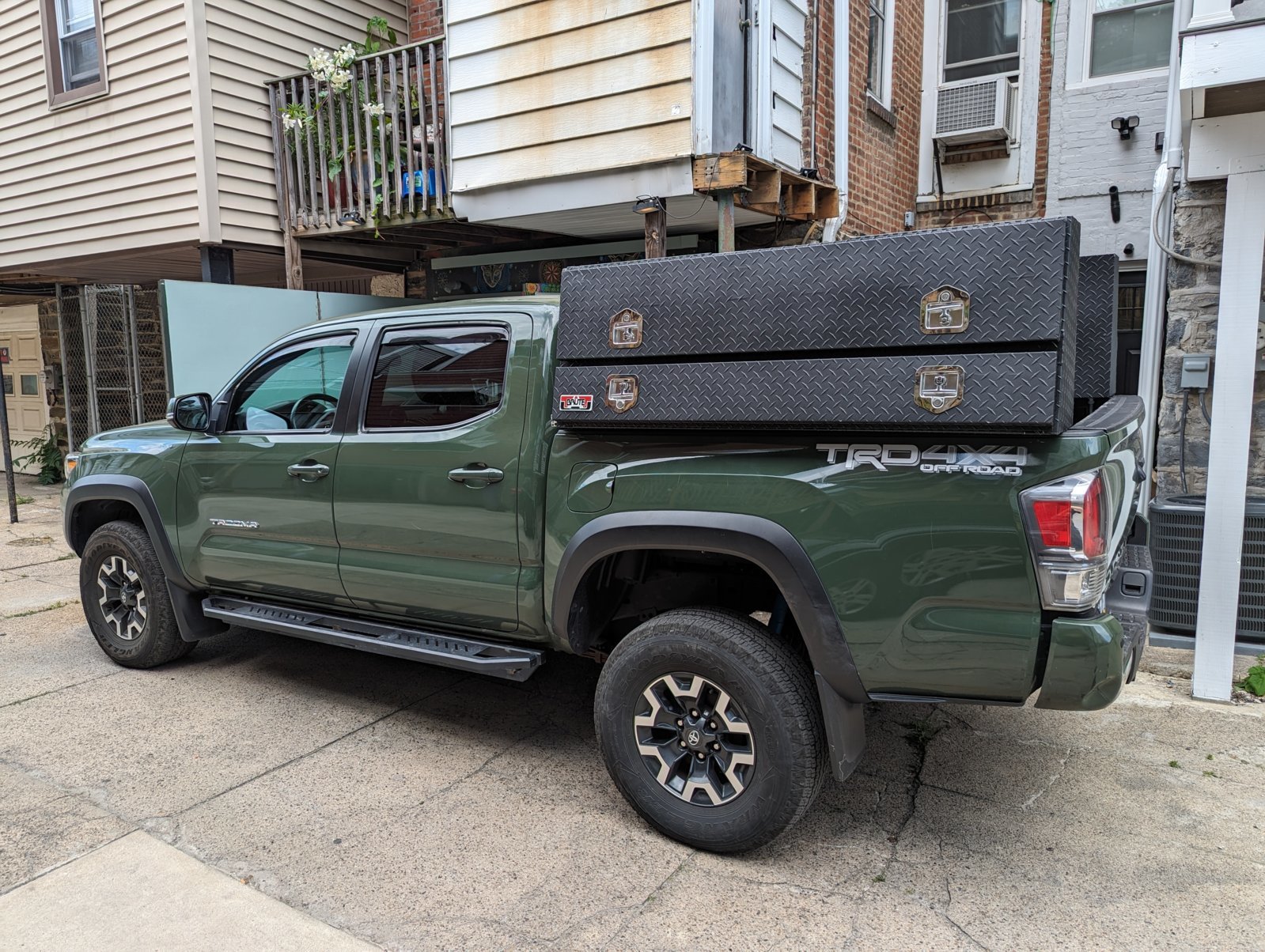

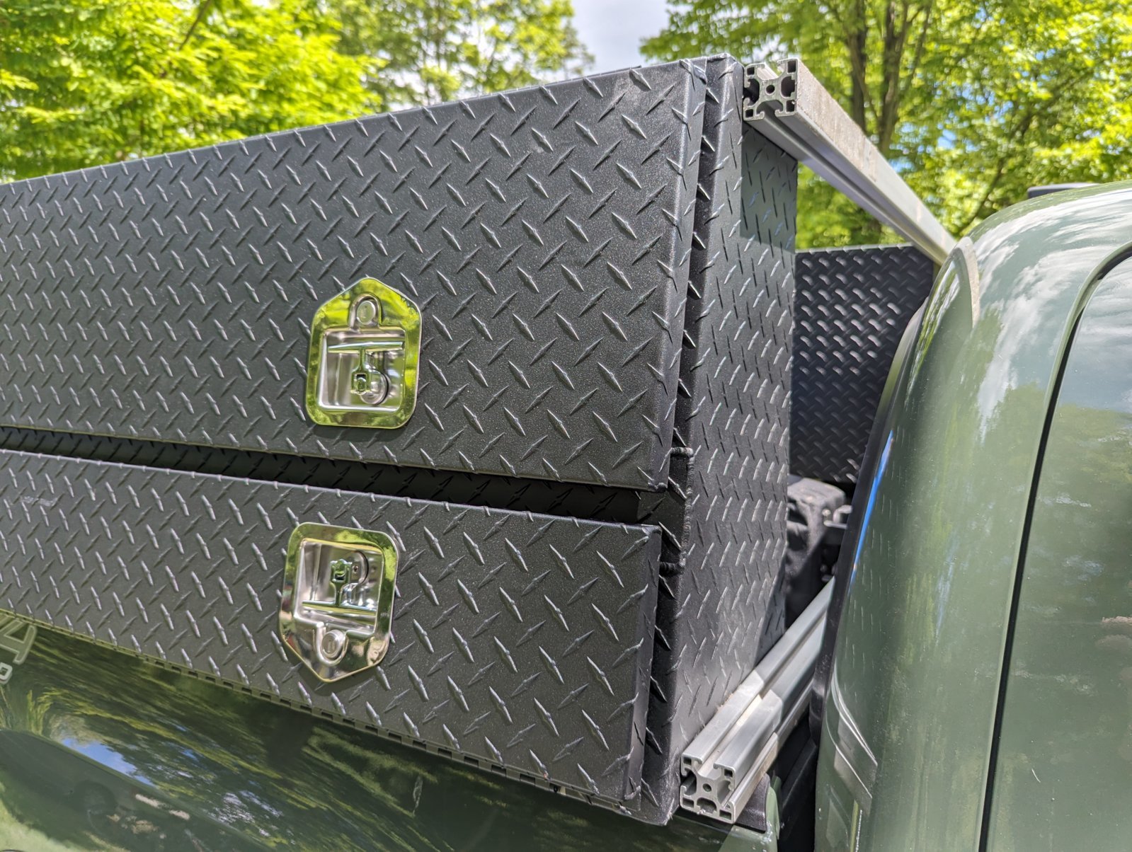

    I got some of the stuff and a road map for the rest...
    I've been loving these Brute tool boxes. Mounting hardware didn't match my set up, so I had to do some custom 80/20 work to stabilize and secure everything.
    Next step is to enclose the top so I can sleep in it and haul ladders etc. Likely will do a DIY wedge tent.

    Love extruded aluminum. It’s so versatile. Easy to cut, doesn’t rust. What city/region is that?
