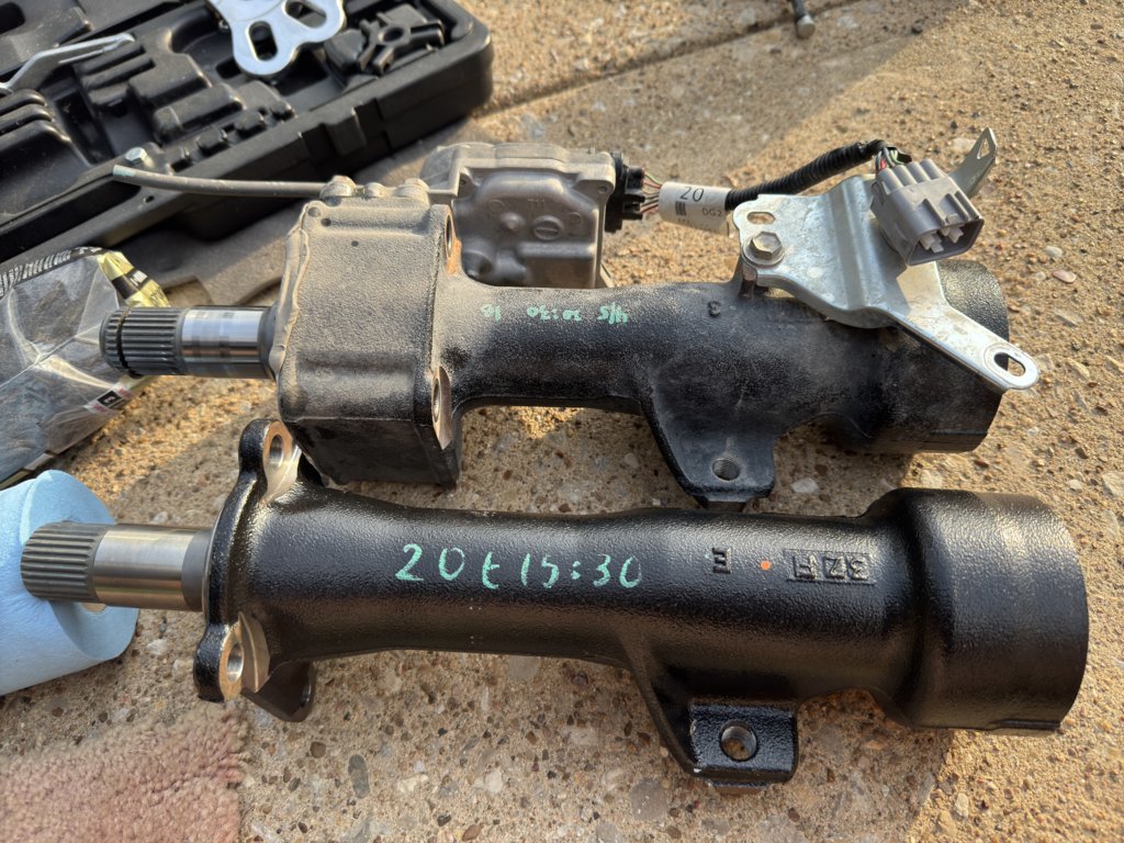

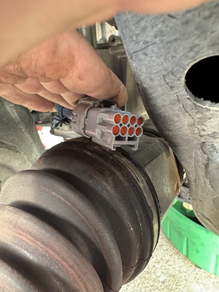

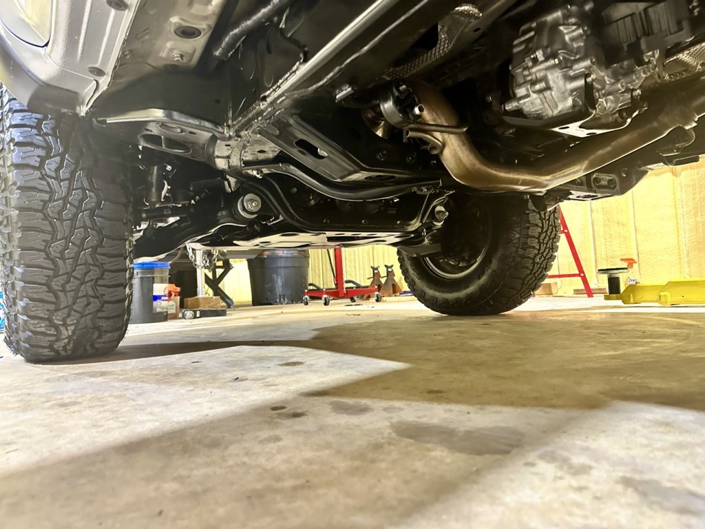

    Wished a farewell to the ADD tube this morning, capped and zip-tied the wiring, and swapped in the solid FJ AWD tube. Now my front diff is fully live (as it should be) and 4WD engages pretty much instantly at the transfer case. Time will tell if it hurts my mpg at all but I doubt it will.
    Only real downside is no 2WD Low hack anymore, but I probably will swap the transfer case for a manual one with twin sticks at some point and I’ll get that function back at that point, if I do. With 5.29 gearing on smallish tires, combined with a potential future even lower reverse gear in the transmission, I just don’t really need a super low 2WD. Nice and fun to have but not really necessary for me.
    Already spoofed the ADD at the 4WD ECU so it doesn’t complain that the ADD went missing.
    It was a good time to do it so I drained and refilled the diff as well.

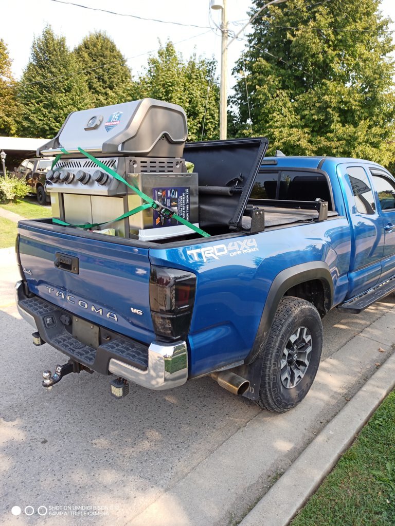

    Doin truck stuff today.

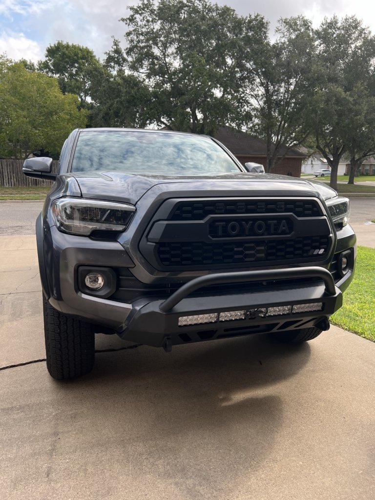

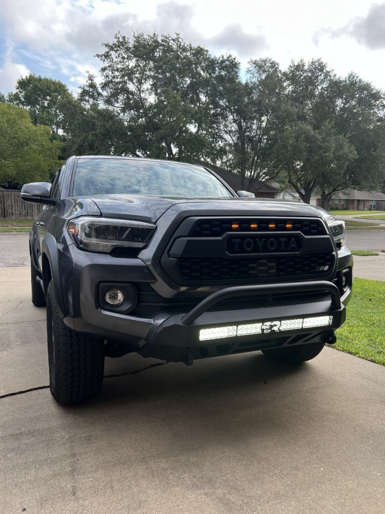

    Finally getting around to making the upgrades to my 21 TRD Off Road. Had it for 3 years now. This is my second Taco. Had a 15 4x4 that I couldn’t pass up what I was offered in 2021. Dealer paid what I paid 6 years earlier. As for upgrades to the 21, just finished a Pro Grille with smoked amber Raptor lights and CaliRaisedLED Stealth bumper with light bar. A while back was the TRD Cold Air along with some minor interior upgrades. Pedal Commander is on the way. Next up is a suspension but will be awhile while I research what meets my needs. IMG_6416.jpg IMG_6419.jpg
