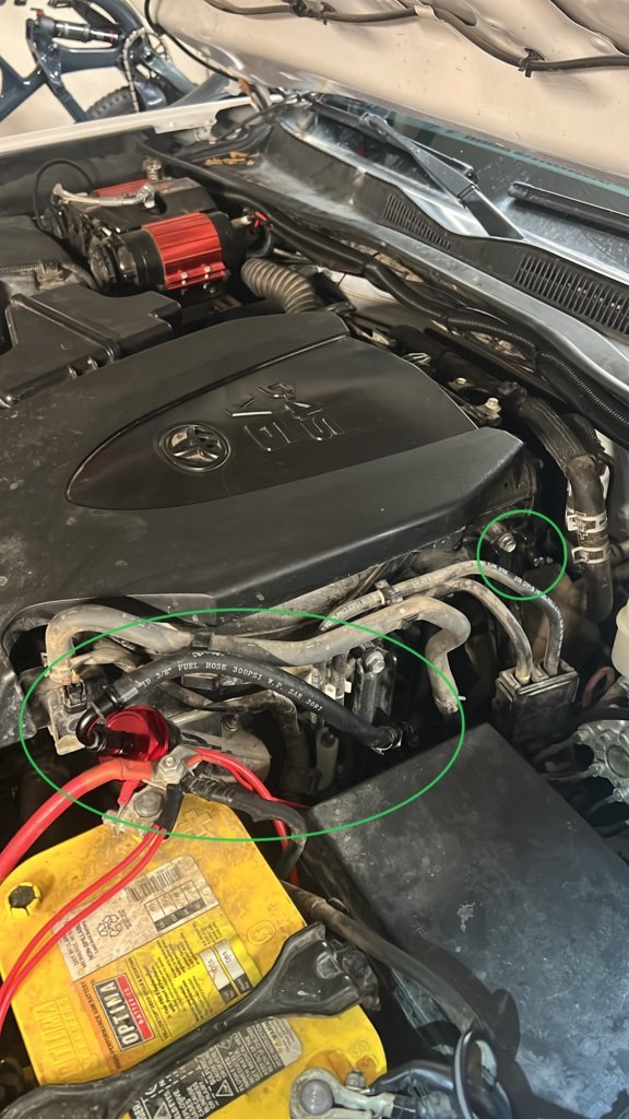

    Yes it routes it back into the oil fill port of the crank case. Where this is significantly more drainage.
    If you’re extremely off camber to the drivers side or extreme incline and have the original PCV location it will cause smoking or hydro lock.
    This prevents it.

    Ah, ok, I thought it connected the existing PCV valve directly to the oil filler cap, just making a loop between them and bypassing the intake. That would be kind of silly. Looks like this just adds an additional vent at the filler cap that goes to the intake, or just replaces the current PCV with a better location.

    This is what comes with the kit. It caps the old PCV and reroutes from the intake to the fill port.

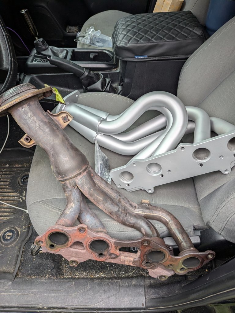

    Yeah pricey but the header and gears woke up this little 4 banger tremendously

    Every dollar spent towards performance was well worth it IMO. Just need an upgraded exhaust and I'll be golden
