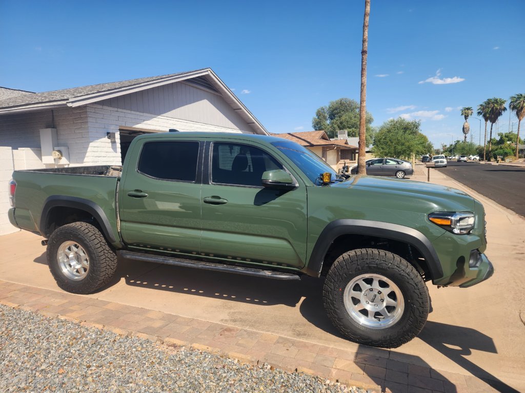

    Family was out of town, so I got after some truck projects today. Just hit 60,xxxx miles, so time for some maintenance and some post-warranty fun additions!
    First and most exciting was I replaced the (terrible) suspension. I went with the 6112 (set at 10/8) and rear 5160s paired with an ICON RXT Leaf Pack. I swapped them to Option/Stage 2, although if things don't settle over the next few months, I may go back to Stage 1. My old springs were crap and had settled an inch, so with the Icons/Stage 2, I went up a total of 3" (stock +1.75", or 2.75" total, was expected with my topper). I got a little more than expected, and it looks pretty ass-high/empty rear wheel wells with my 265/75/16s. Time will tell.
    MAJOR shoutout to Colton/@memario1214 from Hotshot Offroad for answering all of my questions. Multiple phone calls, texts, etc. He always answered and called back when he said he would 100% of the time. Shipping was fast, prices were good, and the customer service is unparalleled.
    Here are my hub to fender before/after
    Install was pretty straightforward. For the rears, the first side took me 3 hours and the second side took 45 minutes; nothing like learning on the job. My stock shock top nuts were not coming off so I used a Special Service Tool to remove them.
    I decided to go ahead and do the Archive Garage u-bolt flip while I was at it. It's SUPER nice, and although I don't wheel hard enough to need the flip, I was CONSTANTLY bottoming out on my old suspension and it was harsh. With the new springs, this is probably unnecessary, but again, figured I'd do it while I had everything apart. Plus the price was right thanks to a buddy!

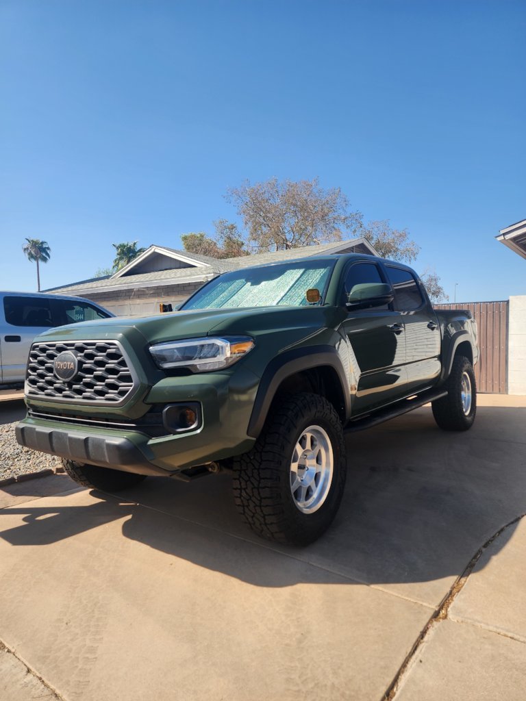

    '23 Super White DCSB TRD OR 4X4
    Accutune stage 4 Adjustable King 2.5's w/resi's All the meso Diamondback HD Method 701's 17x8.5" 285/70R17 Diode dynamics fog/ditch/stealth lightbar Sliders RCI skids OTT tune Total Chaos bed gussets Etc...
    Breifly considered white letters out on tires but thought that was a bit too much.
    Machined finish will hide the rock rash too :thumbsup:

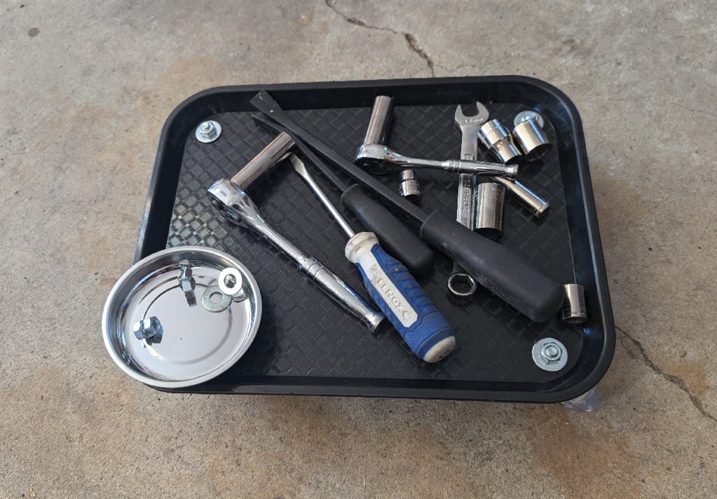

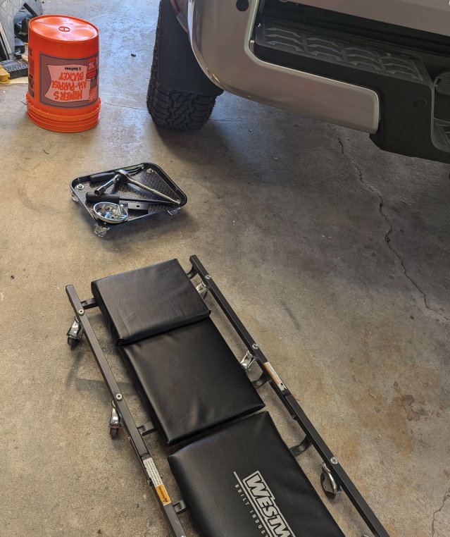

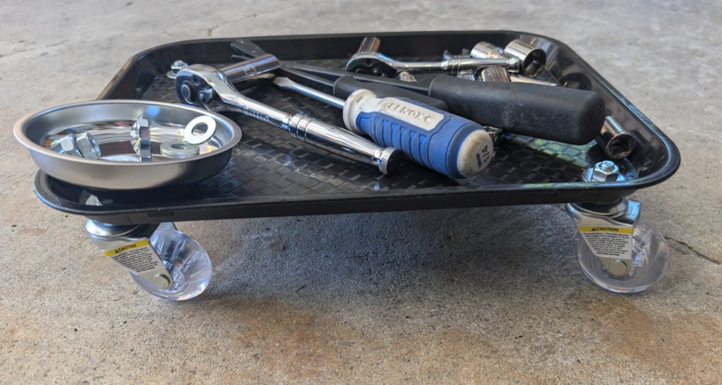

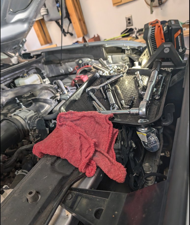

    As a side note...I made a little mechanic's helper out of four Harbor Freight casters and a Wendy's tray. This thing is a lifesaver for keeping track of tools, moving around to different areas of the truck, and keeping nice tools from getting dragged around and beat up on the concrete.
    An added benefit is it fits super well over the radiator in the engine bay, too!
    Finally, I'm REALLY bad at leaving tools all over when I'm in the middle of a project and not being able to find them. I grabbed this tray and it was SUPER helpful in that regard. upload_2024-9-29_20-35-33.png
