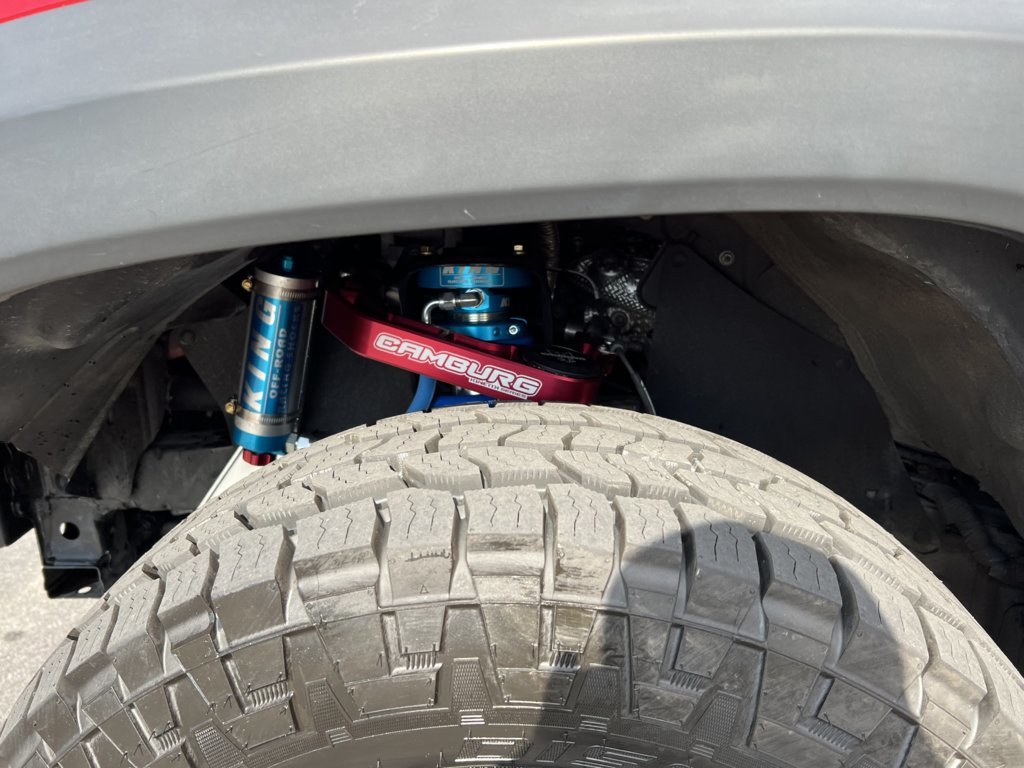

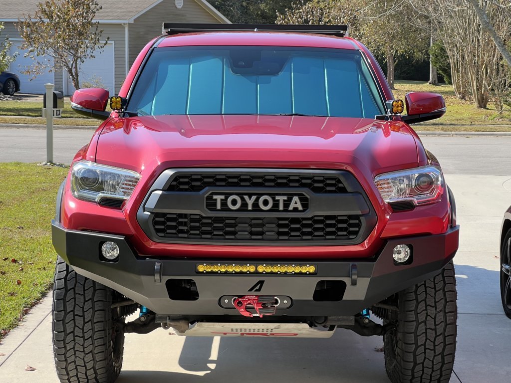

    Finally got my Apogeeoffroad front bumper installed with Baja Designs S8 30 inch light bar, Warn Evo 10-S, Squadron Sport ditch lights, Switch Pro 9100, King 2.5s, Alcan leaf pack, front and back duro bump stops.

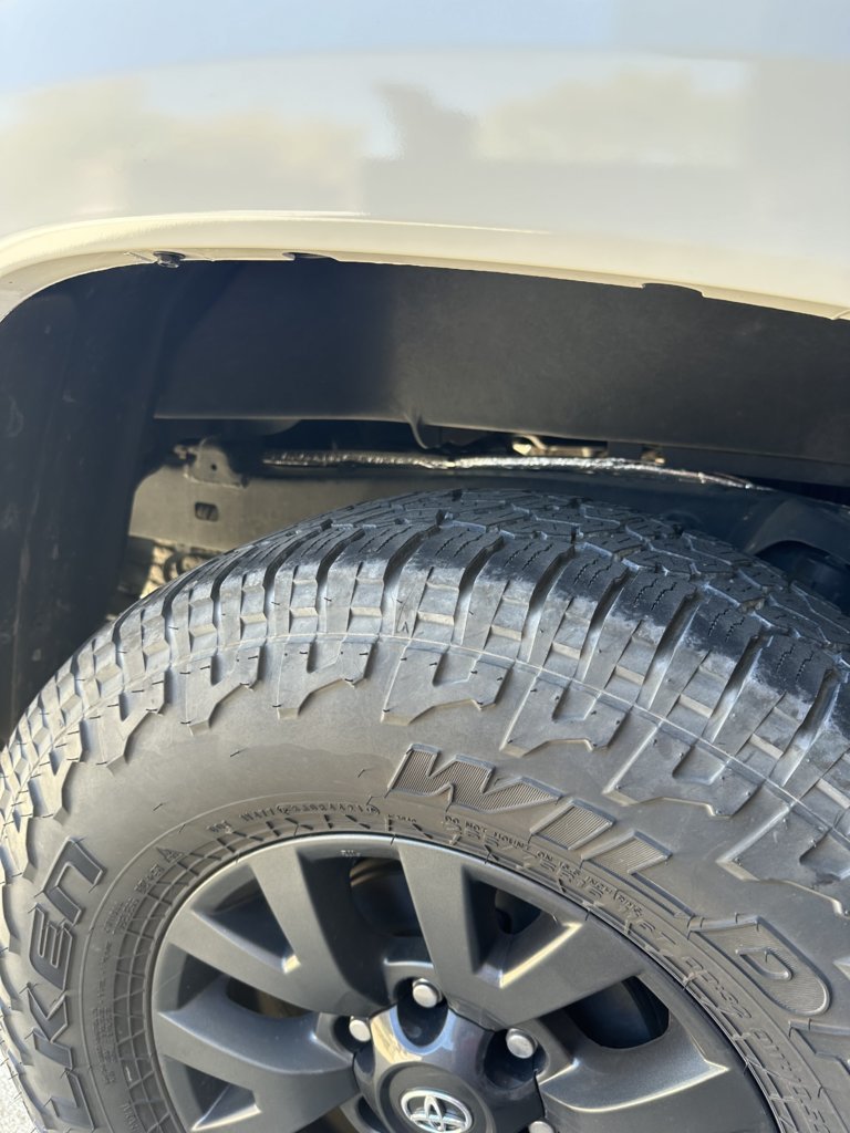

    I’m pretty sure I trimmed mine.

    Whoa, I wasn't aware Camburg is now offering anodized colors on their billet uca's. :cool:

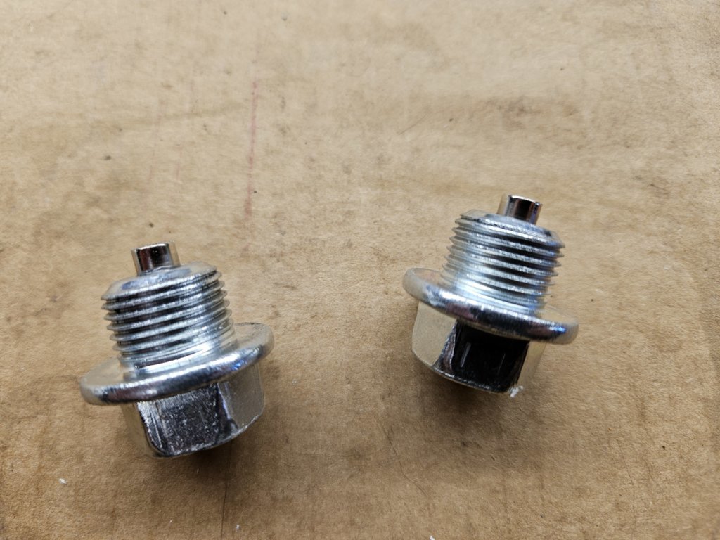

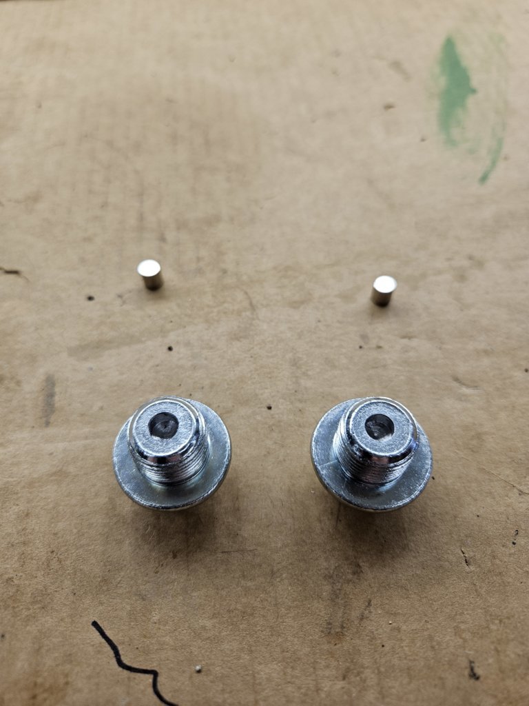

    Modified 2 M18x1.5 drain plugs into magnetic plugs.
    Used 1/4"x1/4" high temperature magnets. Drilled a 1/4" hole in the end of each plug. Mixed up JB weld and put in the holes before pushing the magnets in. Left plastic clamps on the magnets overnight to keep the magnet seated.
    I am going to use them on the fill ports of the front and rear differential.
    I had a bag with 5 of these plugs so was only out the cost of the magnets.

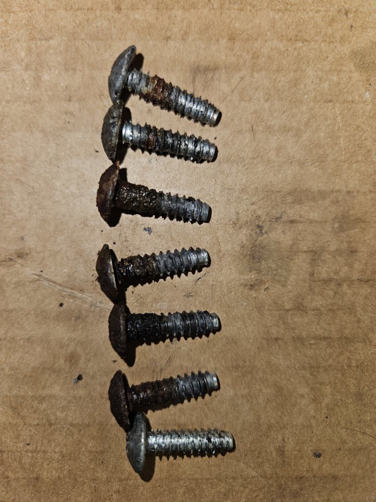

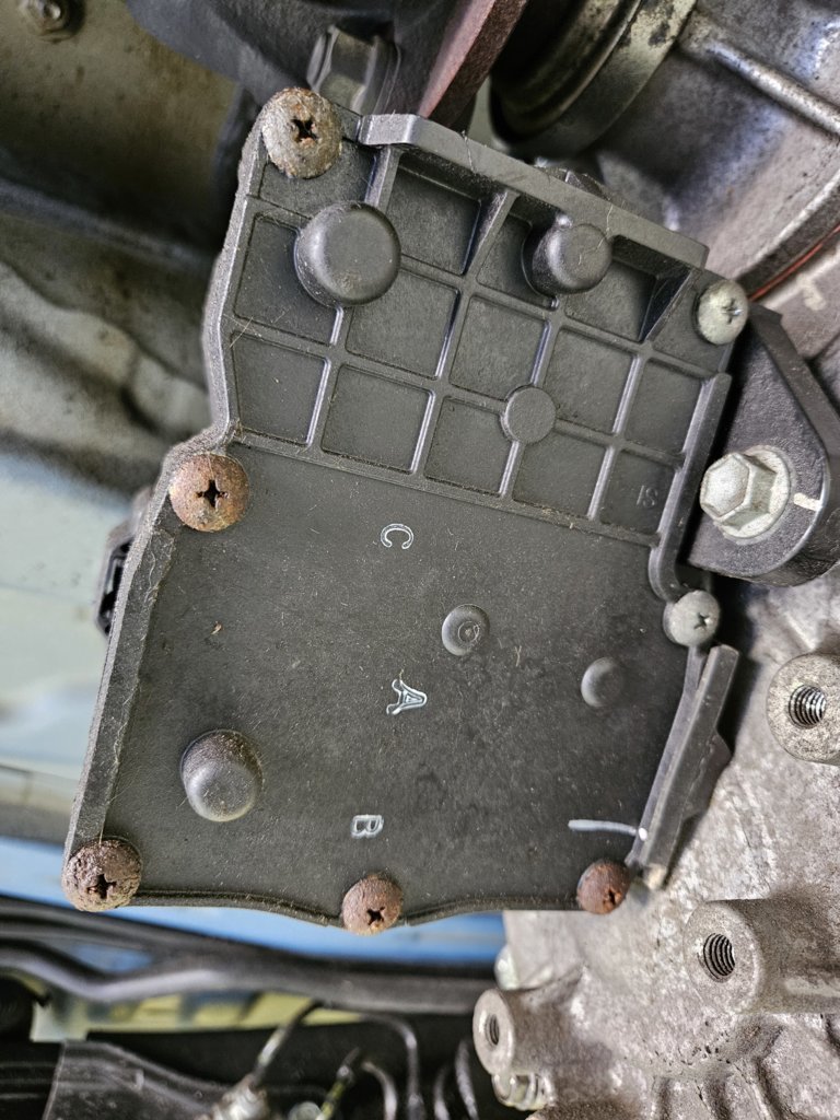

    My transfer case actuator Screws looked like they came off the Titanic. I measured the thread OD of the factory thread cutting screws at .205".
    I had some 18-8 stainless #12x3/4" sheet metal screws that have a thread major diameter of .210".
    Replaced all the screws one at a time.
