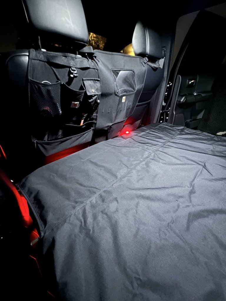

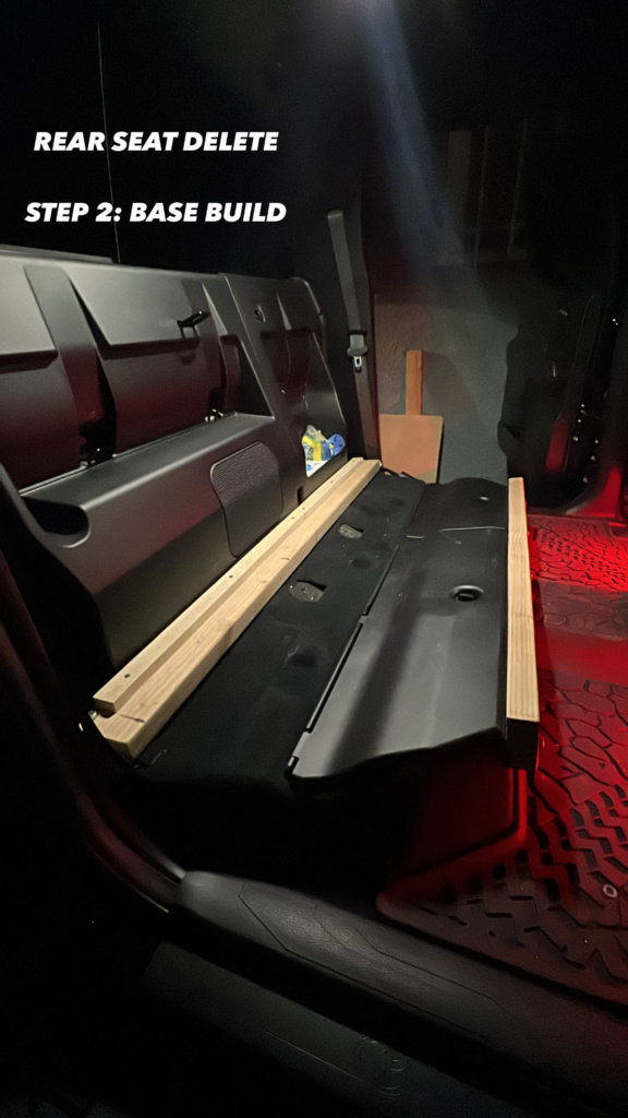

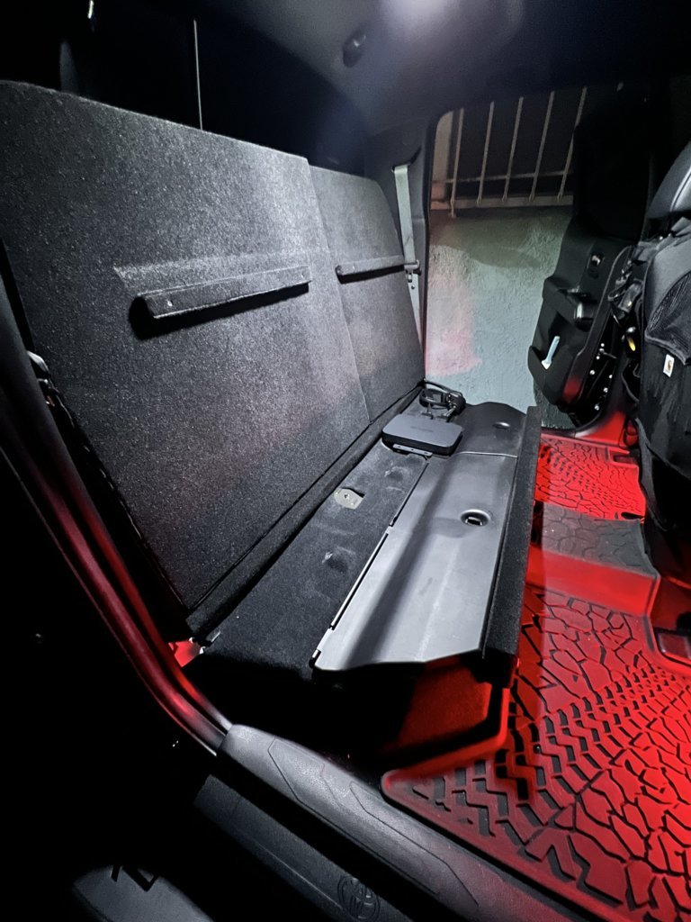

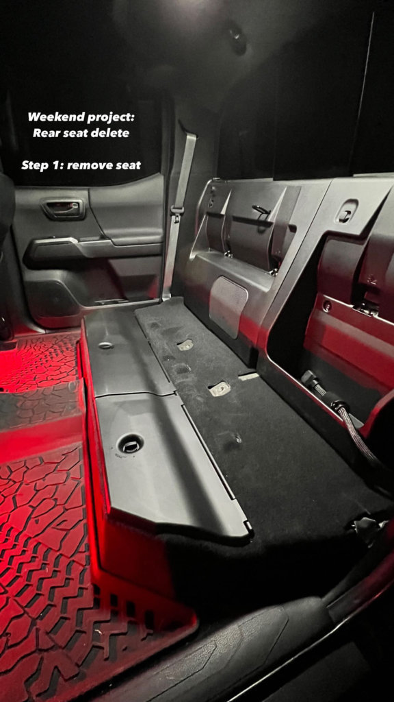

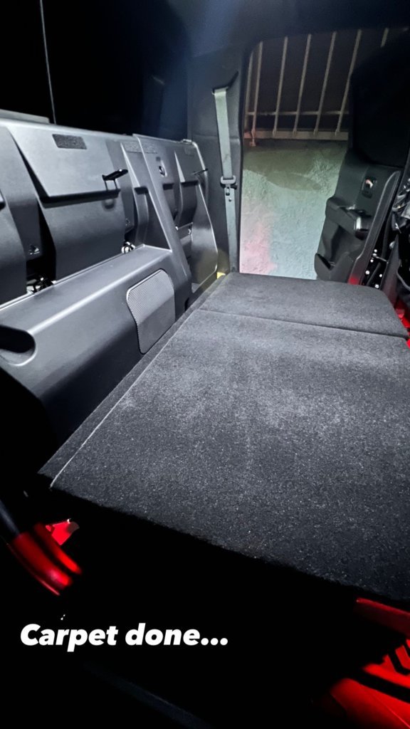

    had some leftover 3/4” mdf from a project and decided to do a rear delete.
    also added the carhartt universal pet carrier modified for the rear delete…remove the buckles that attach to the rear seats and added heavy duty Velcro to attack to rear panel.
    may first had it on a piano hinge but decided to just attach a little block to the bottom of the platforms to prevent it from moving allowing for easy removal as needed.
    The base is just 2 2x4s attached to west the seats would originally mount to. It’s solid.
    was hoping to mount the eco flow alternator to the rear driver storage panel but I’ll figure that out another weekend.

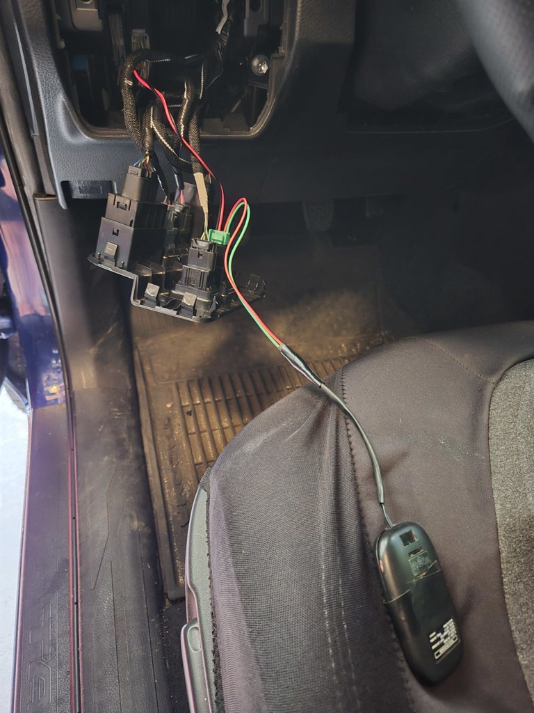

    Did you just wire the switch to the door opener or do something else?

    I wired the switch to a standard garage remote opener. Bought the Toyota style switch off Amazon ($10). It was prettty simple to identify which two connections to solder the wires to.
    This thread helped out a bunch.
    https://www.tacomaworld.com/threads/diy-garage-door-opener-non-homelink-10.485793/page-2
    Tapped into a dash 12v and ground for the switch llight (not necessary for it to work). Then stashed the remote behind the panel. Easy, cheap, and stock looking garage door opener.
