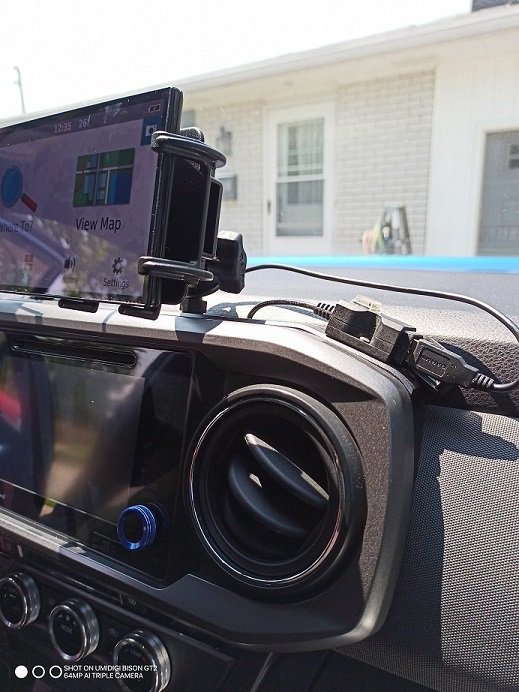

    TRD emblems, tinted windows, OEM running boards, AVS vent shades, RMAS upgrade, LED lights in front and rear, interior LED lighting upgrade, LED lighting in bed, touch control dash mount for LED lighting, auxillary 12v and USB jacks in bed, replace all speakers with Infinity, custom mod with Bose tweeters, TRD Pro illumination mod...
    https://www.tacomaworld.com/threads...pe-ball-mount-new-stock-available-now.754982/
    https://www.amazon.ca/gp/product/B07NLD6DRD?ie=UTF8

    I did something similar to this. Then ran a couple usb plugs up behind the head unit and trimmed the plastic trim for the wires to come out through.

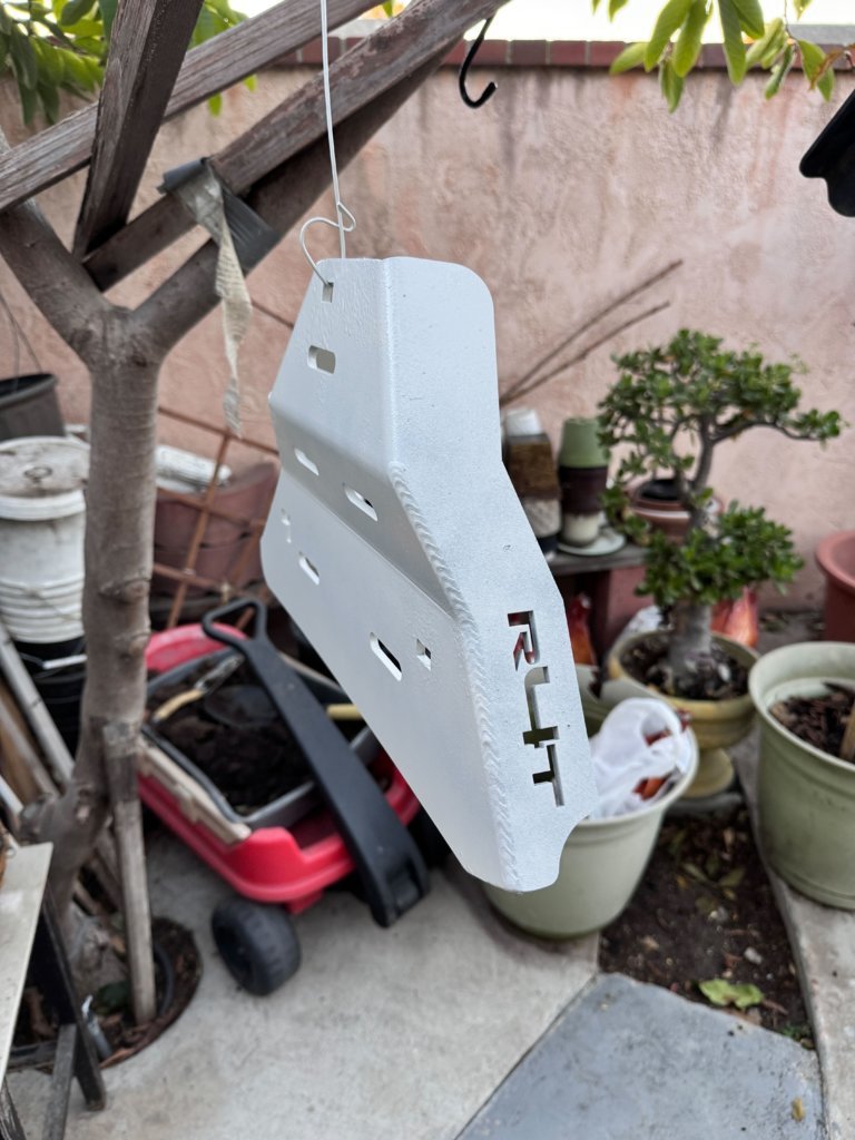

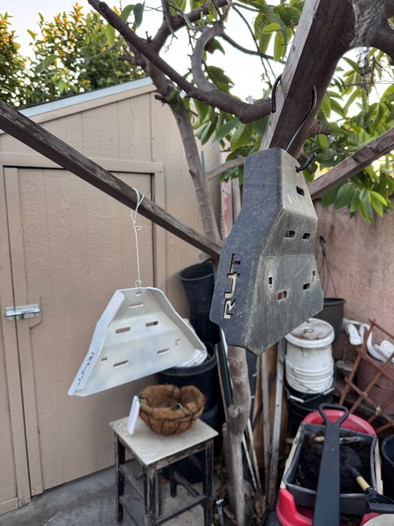

    Thanks @Jerry1026 for the R4T LCA skid's. Went ahead and painted this morning... Will install once they're dry.

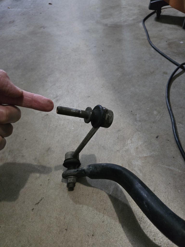

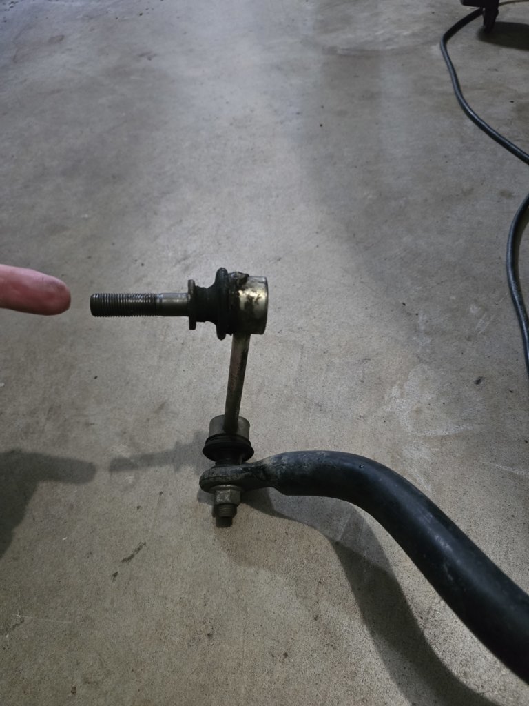

    Do you have stiffer springs in the front and/or larger bump stops? My front is on the heavy side I ended up with some icon tundra bump stops after I pulled my sway bar.

    You should be able to grab the stud and feel how tight or loose it is, or even if it is floppy loose, and for the stud that is mounted to the sway bar, just grab the end link and see how easy/hard it is to move around, or even if it is floppy loose...
    Hint: should be hard to move, the looser one is (all are) the more out they will make noise going over bumps etc...

    I have original bump stops and stiffer ome front coilovers. Endlinks seem tight enough.

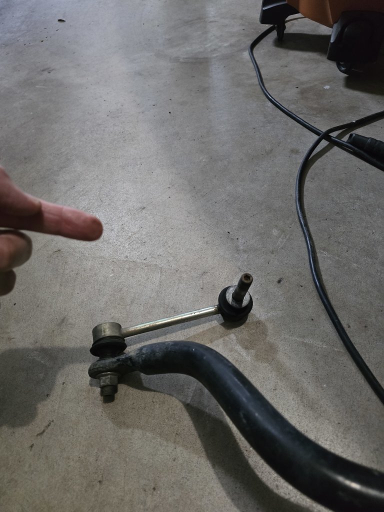

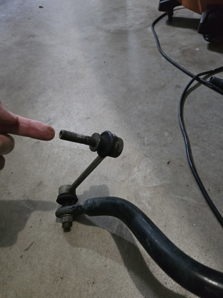

    Both sides, from vertical, drops to floor.

    Grab the threaded stud you are pointing to and see if it moves/wiggles freely, then see if the end link/bar going between the threaded studs (one is attached to the sway bar) moves/wiggles easily...
    But yeah, if they fall to the floor like that, they are basically shot, or close to it anyway..
