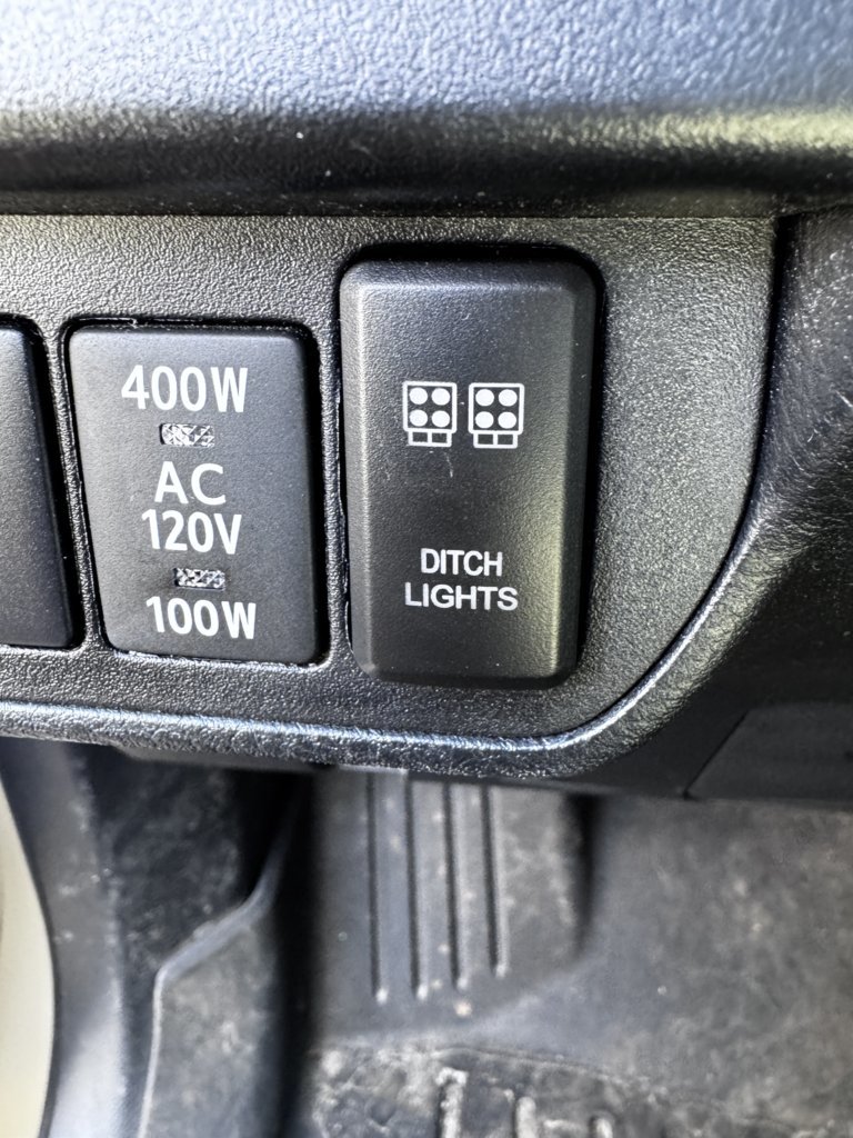

    I got the ditch light brackets from CaliRaised so I get the switch from them as well, No noticable wind noise from the MaxTrax but the stereo is usually turned up so I wouldn't hear it anyway. The rain guards are ......ahhhhhh. would I do it again, no.....water still gets in the inside of the doors when it's raining. IMG_7211.jpg

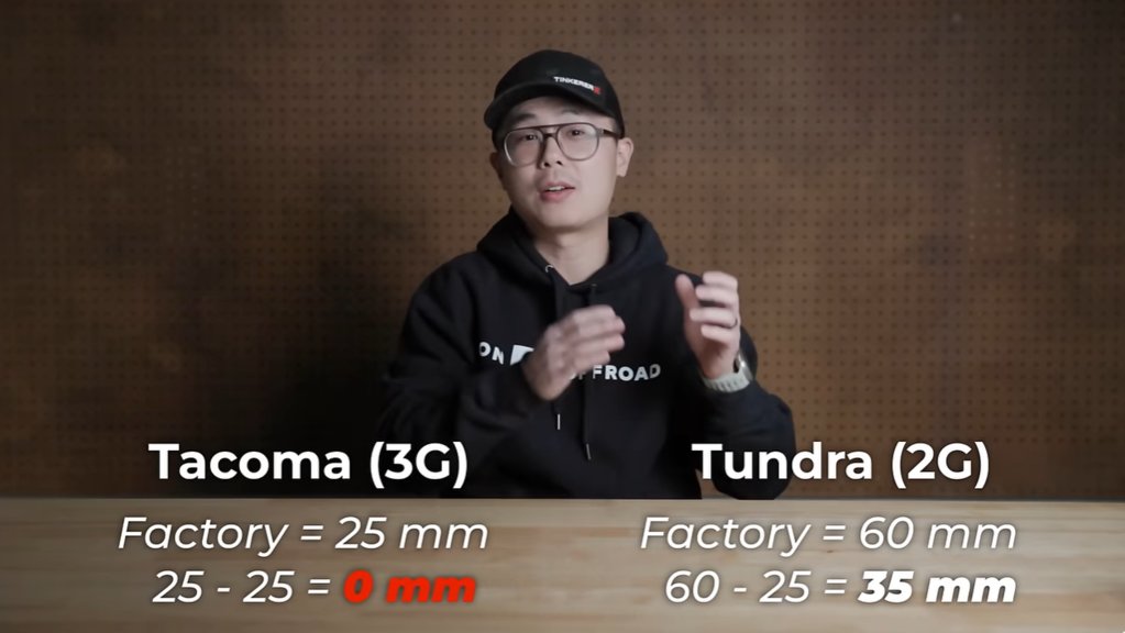

    -10 or -12 offset is less than 1/2”. That 1/2” is not going to make a difference. Now running a -38 or something like that on a Tacoma will make a difference. But Kai is correct that the more (less) offset you have and the farther out your wheels sick will increase the scrub radius, likely cause more interference with body mounts, plastic, etc and put more wear on components. IMO -10/-12 is about the same as a 0
