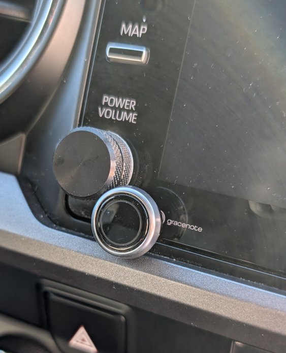

    I hate the stock Entune radio knobs; they're slick and too small for my hands. Replaced them with a couple of nice knurled anodized aluminum knobs I found on etsy for $35. Much better.
