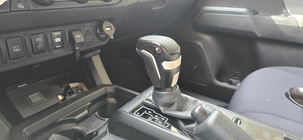

    Installed an ECT button on my shift knob, retains the factory ECT button functionality as well.
    Added a bass knob for adjusting the sub bass level.
    Added a momentary push button for those special drivers who need some extra light in their life.
    And yes, that's a me-so bucket that I used to install the switch and bass knob.

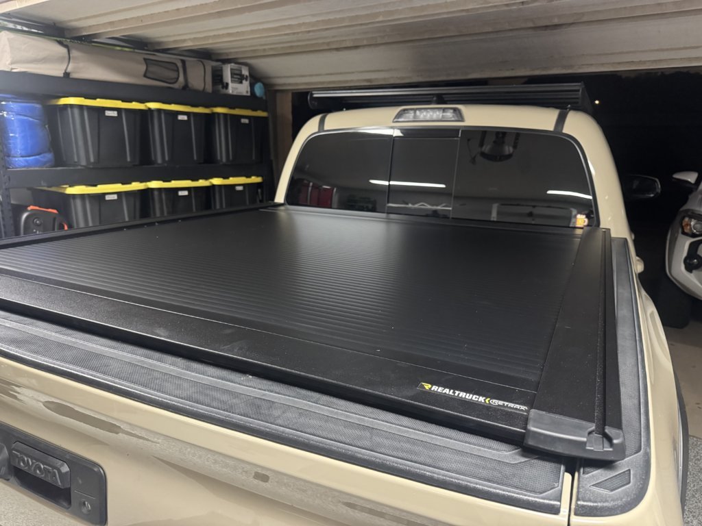

    Yeah real truck owns retrax and bakflip. I believe they have for a while but they are now putting their logo on them.

    Nice job! How did you wire up the remote ECT? What type of switch is needed?

    I used the harness from https://tacomabob.com/. I bought a small momentary button, drilled into the side and up from the bottom on the shift knob. Soldered the wires to the button, fed speaker wire thru the side and down thru the bottom. I used bullet connectors where the wires come out from under the console near the floor so I had a point where I could disconnect this as needed without having to cut wires. The tricky part is threading the knob back on and keeping the wires from twisting since the wires feeds thru the opening on the collar of the shift boot.

    OK - so ECT switch is simple momentary, and ECU controls/changes the ECT status with each ‘contact’ made.
    Thanks for the details!

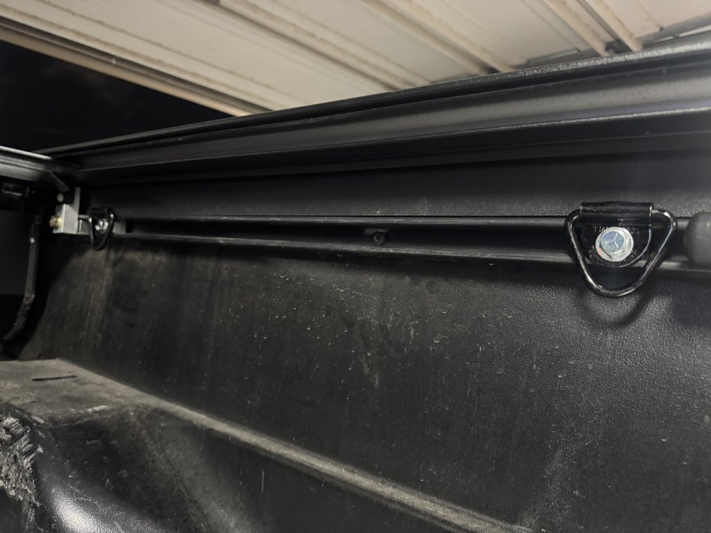

    Can you give comparison of the 2 covers? I have backflip and am wondering why you swapped?

    Mostly because I wanted a tonneau that is still fully functional with a bed rack. I plan on getting the upTOP rack that works with the retrax.
    And partly because I have to move a some stuff regularly for my wife’s business that requires me to flip the bakflip up and I don’t like the back window being covered.
    As far as comparison the bakflip is great, I just thought this would work better for me.

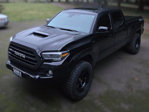

    S&B intake, MBRP exhaust, Black Rhino Shogun wheels, tail lights, VLED footwells, bed stiffeners, side mirror turn signal lights, interior lights, X-Trek grille, Tinkerer shift knob, TRD skid plate, OEM bed lights, OEM remote lock tailgate, blackout door handles, window tint, hitch pod light, oversized cup holder, RAV4 knobs, RetraxPRO XR cover
