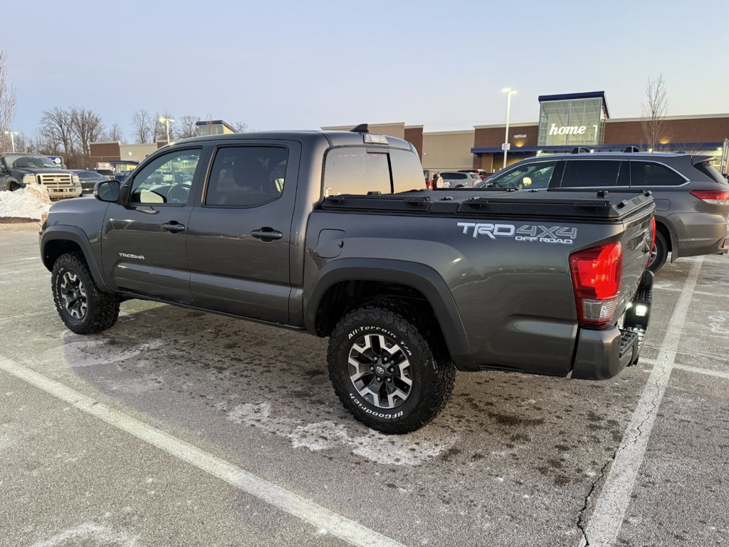

    Decided not to wait for the bath.

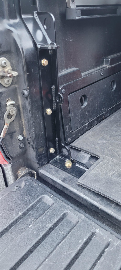

    Timbren Active Off-Road front bumpstops and @TOTAL CHAOS bed stiffeners went on today

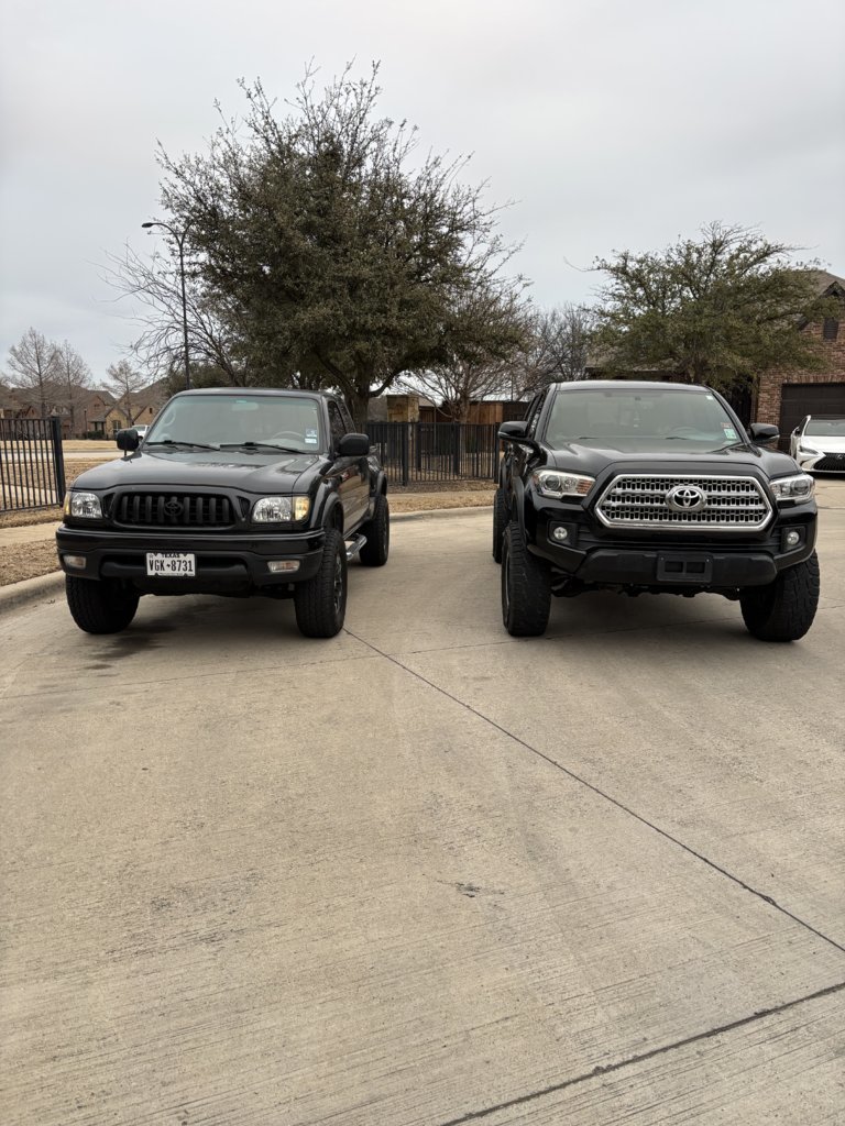

    If my '04 was 4WD I would have never traded for my '20. But I've come to like my '20 so I guess all's well that end's well.

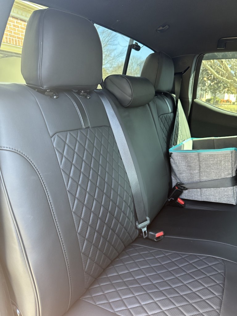

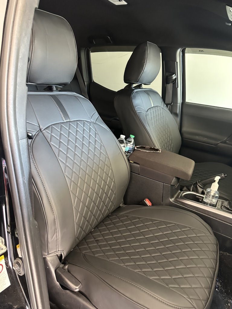

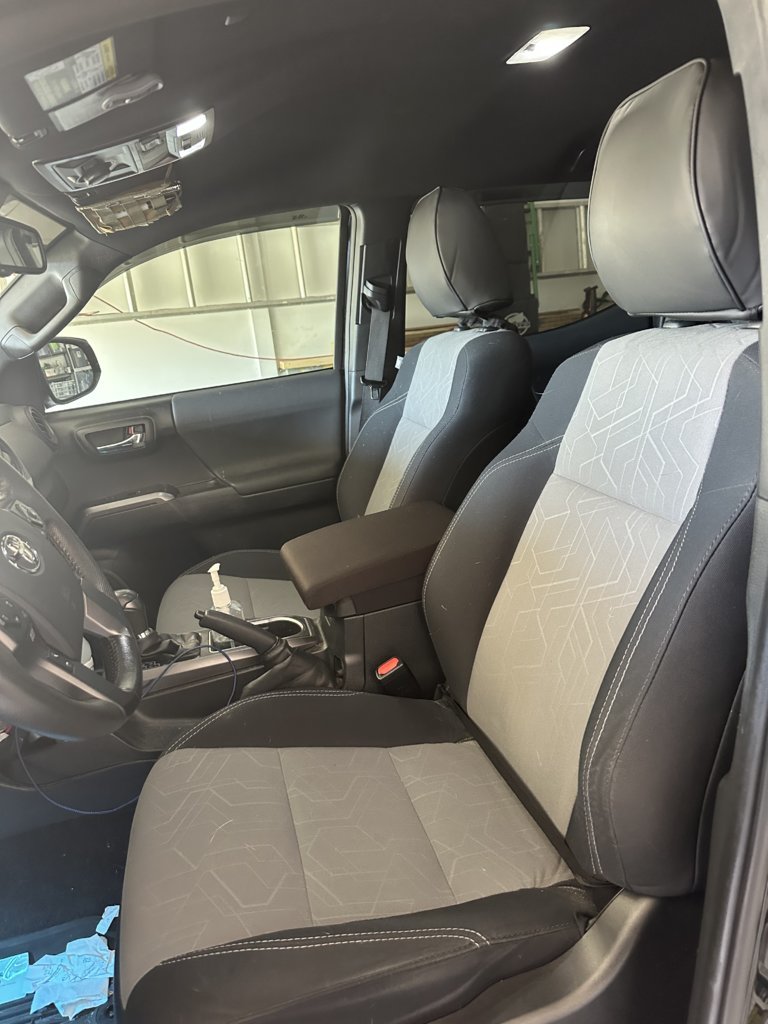

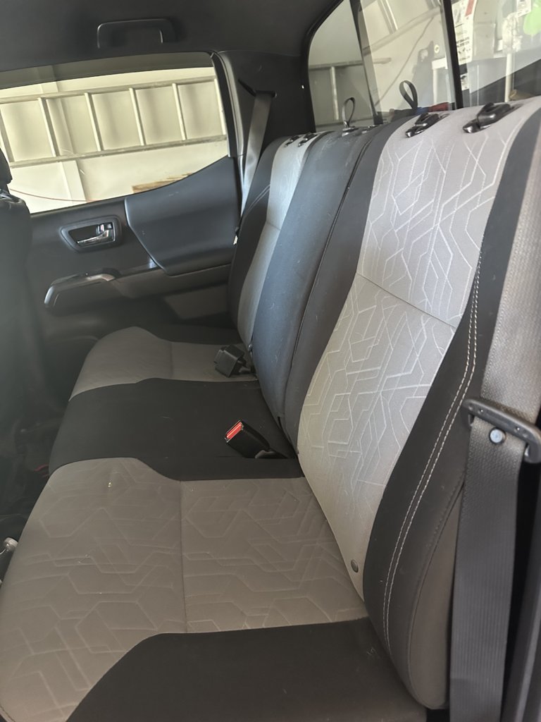

    Installed some faux leather seat covers. The seem like great quality and pretty easy to put on for seat covers. Can still feel the heating element too, just takes a bit longer. A great looking upgrade.

    I found that with similar covers that you installed my drive comfort improved because of the extra padding.

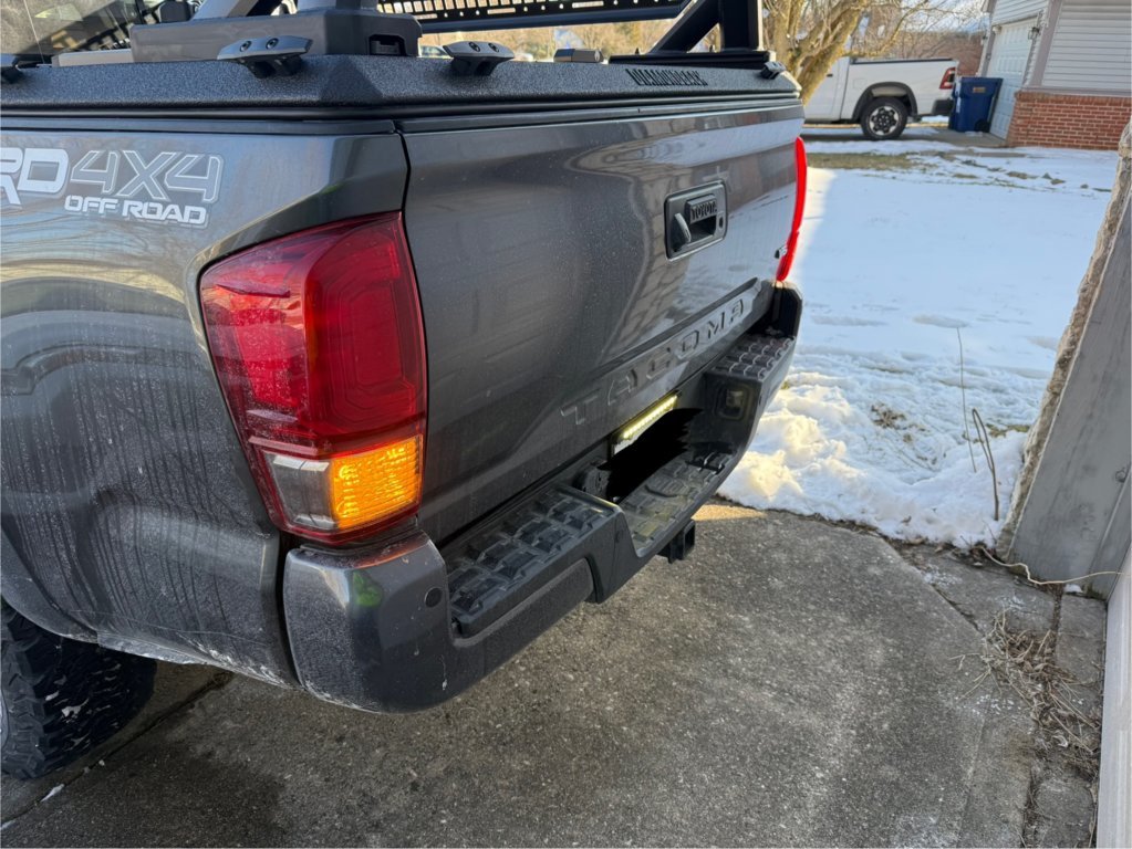

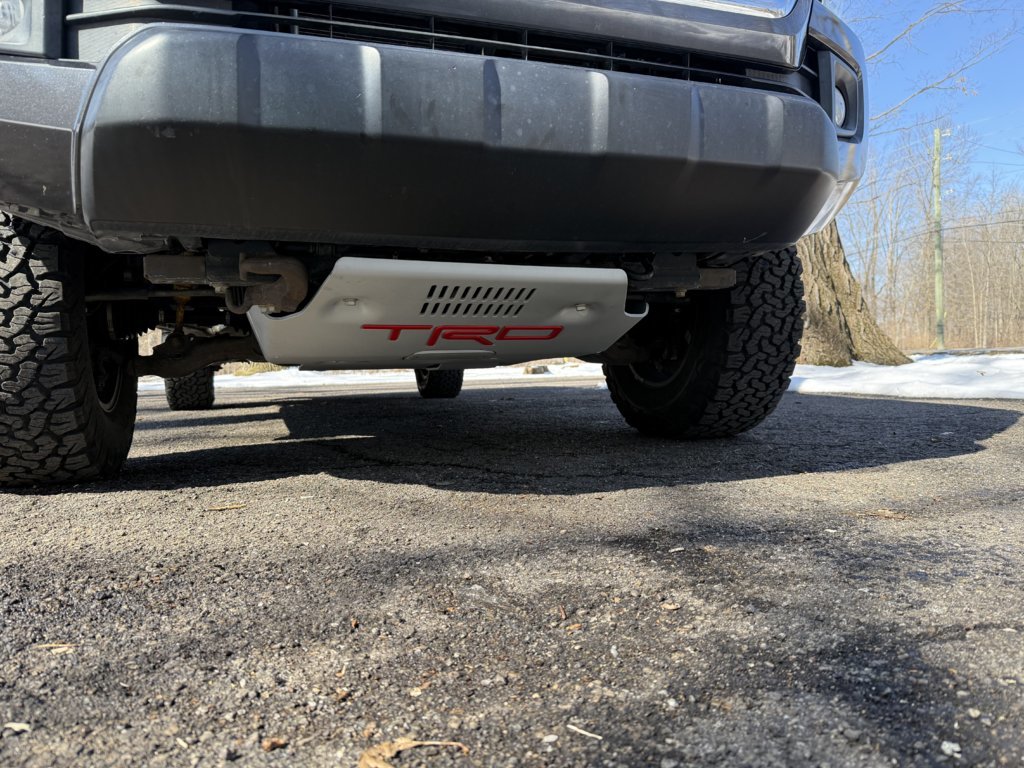

    Oil change and TuRD skid plate installed. That will be it for a few weeks. I also finished the wiring for the tailgate lock too. A whole weekend wrenching has to be repaid with a whole weekend pampering the wife.

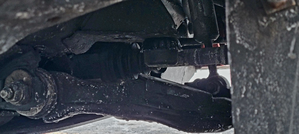

    Installed these (link at bottom) today (assembled coil overs from wheeleveryweekend; stock height and spring rate). Had them since 7/29/24 and USAF son asked to help (saw box setting on floor). So, knocked them out today. Watched a few videos and did a modified version of this one: https://www.youtube.com/watch?v=a9N1fvbGAEw
    Modifications:
    (1) Used Sharpie to mark lower control arm-to-frame “washer” positions (washer’s used to perform alignment but wanted to get it close so drive to alignment shop wouldn’t make my brain crazier). NOTE: Each LCA has four (4) of those washers, one under the bolt head and nut of each of the two (2) bolts PER SIDE.
    (2) Installed already-assembled coil overs so removed the 3 nuts holding the assembly to the upper mount vice the single nut holding the shock to the coil over assembly.
    After doing the job and watching the video again I now have the confidence to save some $$ next time and replace just the shocks.
    ODO: 71,000
    Why’d I do it? There was a 'thunk' noise on the front, passenger side when going over pretty good ’transitions'. And, since my wallet is bigger than my brain (the bar is low!) I decided to easter egg and see if the assembly fixed the ’thunk’. Mild off-roading that followed installation didn’t reveal the ’thunk’.
