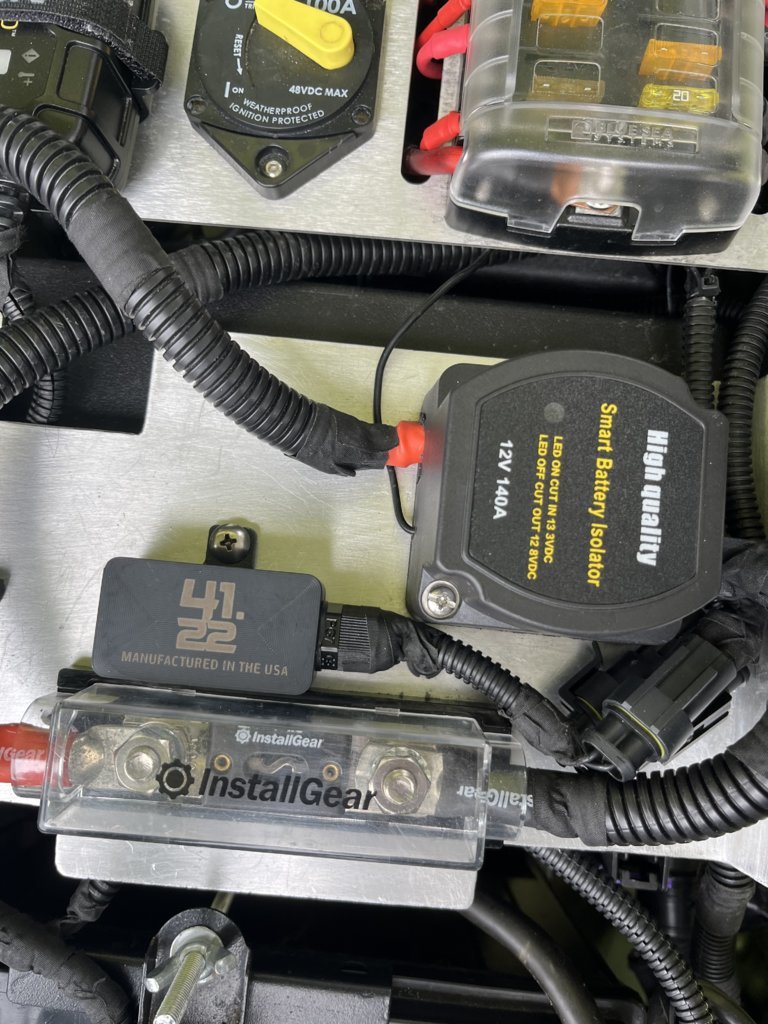

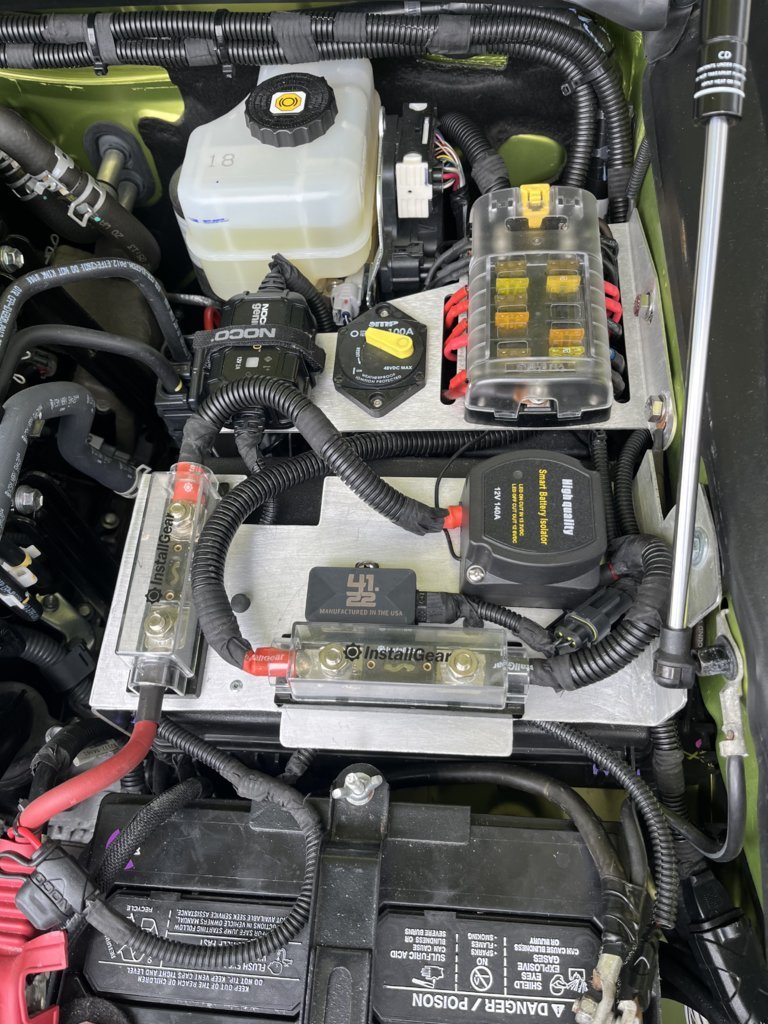

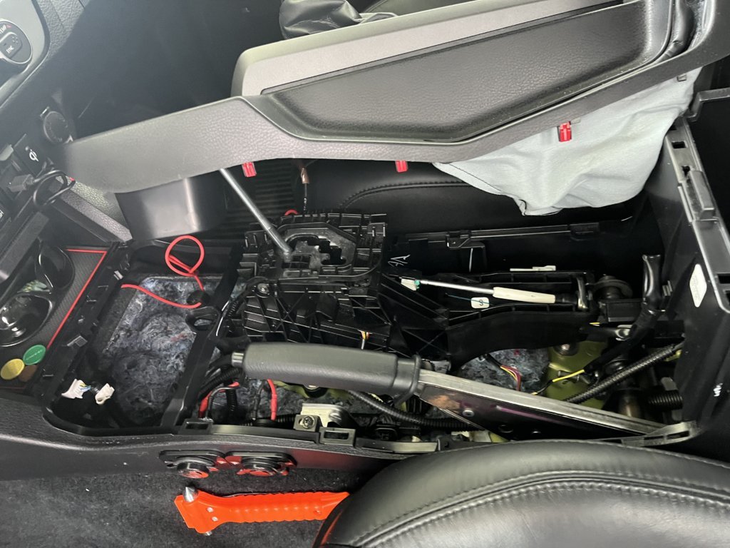

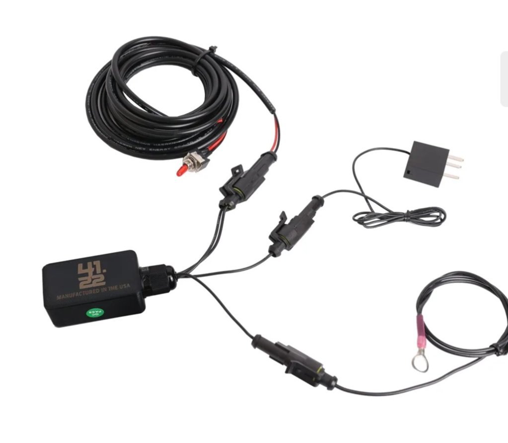

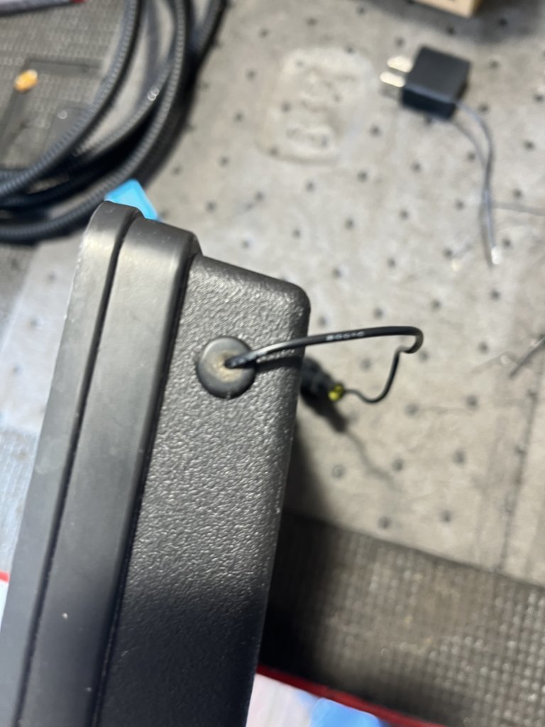

    Installed the 41.22 kill switch. Due to my second battery setup the works were a but more complicated... Had to remove the fuse/isolator panel which meant I had to disconnect both batteries. Drilled a hole in the relay box, cut the new relay wire and ran it through a grommet through the relay box wall. That should make it pretty much water proof. Then ran the wires up to the vault in the middle console where the switch is now. Thought I was done after putting all together again! Wrong! The 2023 Taco TRD OR needs the reverse relay installed, not the normal relay. But now it all works fine. Switch off - lights are all on and fuel pump active. but engine does not start. Switch on- car starts.

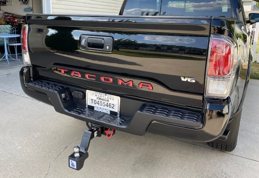

    No pics because there are hundreds out here from other trucks already:
    • Reinstalled a New Ham Radio (Vero VGC NR-7500)
    • Reinstalled my Dash Cams
    • Cleaned out and audited all of the gear under and behind the rear seat.
    • Charged or replaced batteries in the flashlights
    • Added some black overlay's on the Chrome Tacoma and V6 Badging
    • Removed the mudflaps
