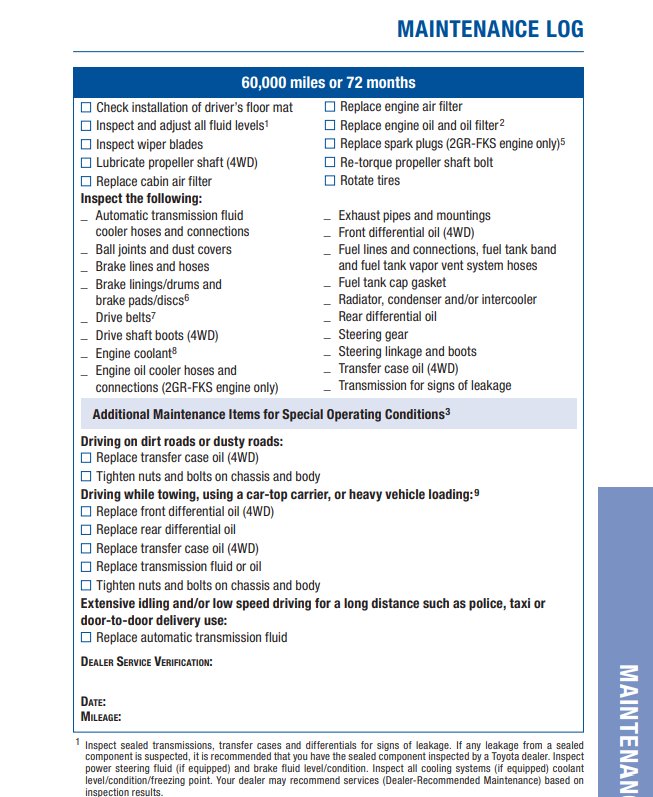

    Team Oil Drop says 60k miles Car Car Nut says 120k. FWIW I'm going to knock mine out at 60k.

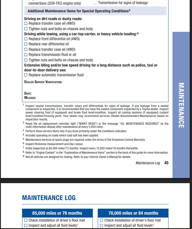

    EDIT: If you are talking about the 3.5L V6:
    May want to watch this video, the car nut says on the 2GR-FE is every 120K miles, the 2GR-FKS (2016-2023 Tacoma's) is every 60K miles... The owners manual is 60K miles...
