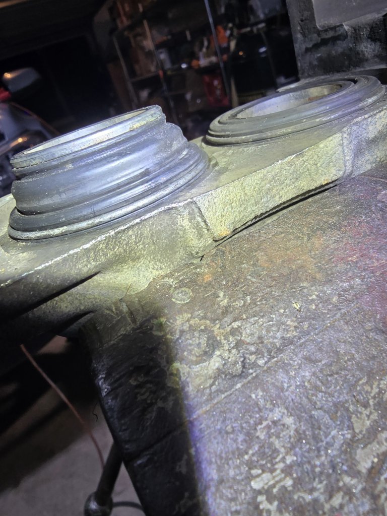

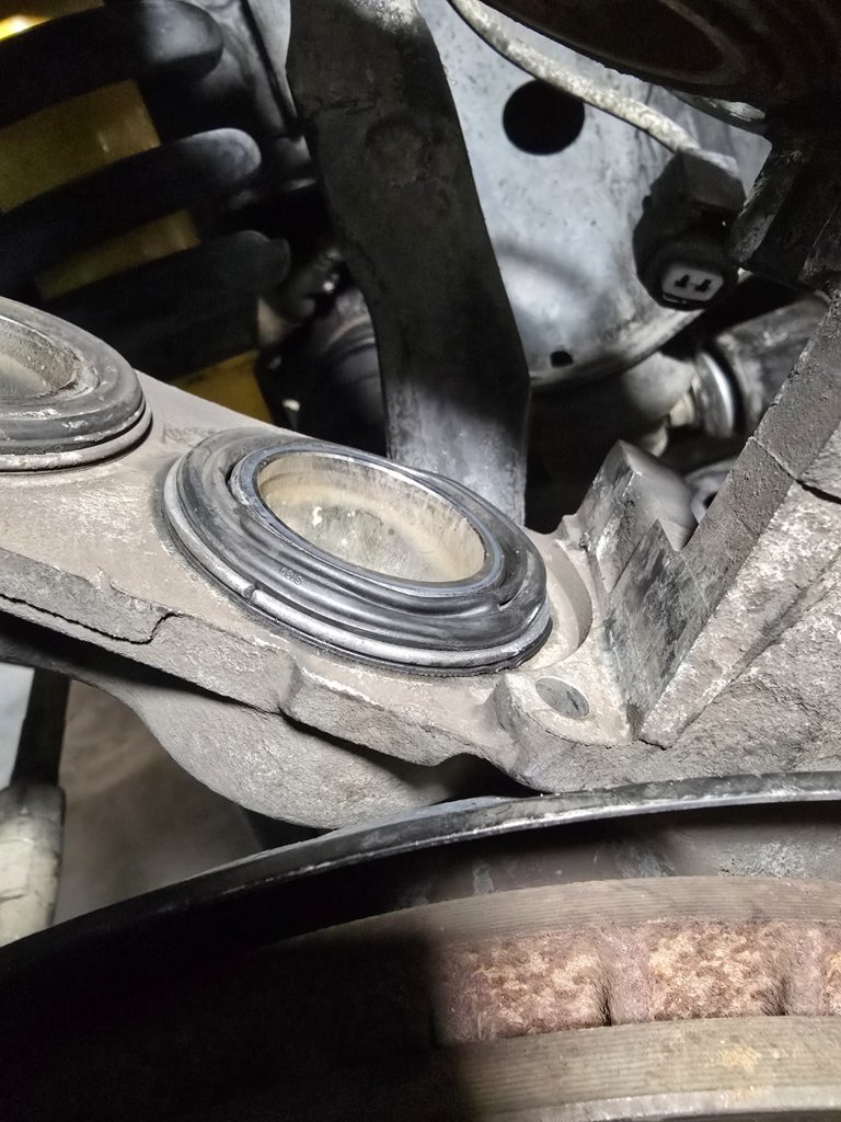

    Doing brakes front, a piston popped out. I got rubber seal back on, looks like little rubber is present between caliper and c clip ring - all around. Can you have a look at this, is it good or not? Brake fluid emptied on left driver front.
    Ring popped off. Anyone knows the technique to get it on.

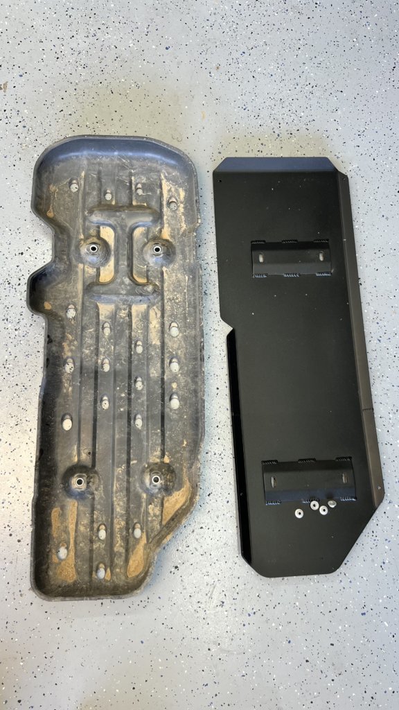

    Got the RCI gas tank skid installed. Sleek and simple .

    https://www.tacomaworld.com/threads/2-gen-caliper-rebuild.753933/
    not a lot of info there but there's some. I'd be more concerned about the lost brake fluid.

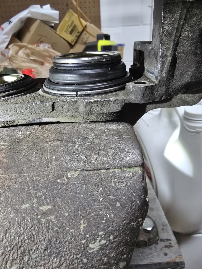

    Thank you C. I got it, almost perfect I'm sending it. Put caliper in vise and got better visibility and clip is on no squiggly. I'll use the suction tool to bleed this one brake for tonight, then do a better job on it tomorrow. Thank you.

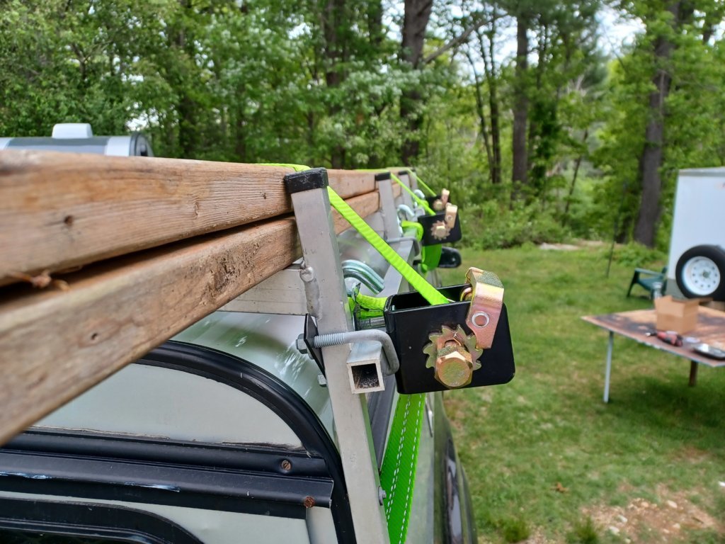

    Prototyped ARE lumber rack upgrade with heavy trucker 2in strap ratchets, U bolts and drilled steel backing plates for now. Will weld up on AL plate at a later date.
    No more hanging by one arm while wrestling ratchet straps. Hernia and torn shoulder mandated a better system.
    Not pretty but works well. Easier to reach and operate. Straps stored in truck. Can reach from ground.

    I would say the rubber seal on the right is no good. The seal should look the same all the way around, like in the link from @BigTang.
    Apply some grease to the grooves around the top of the piston and around the outside of the cylinder. (Don’t get grease inside the cylinder.) This should help the seal to pop into place, and help to waterproof seal. Once any water/corrosion gets past either groove and starts to corrode the wall of the piston or cylinder, the piston is likely to jam.

    Yep - much better! :thumbsup:

    That rubber should do what it is supposed to do. Bent or unfolded in this case. It just keeps crap off the piston.
