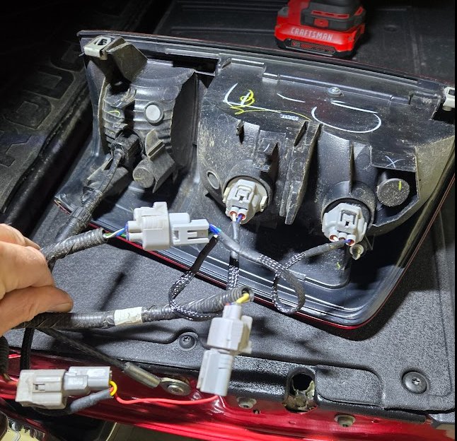

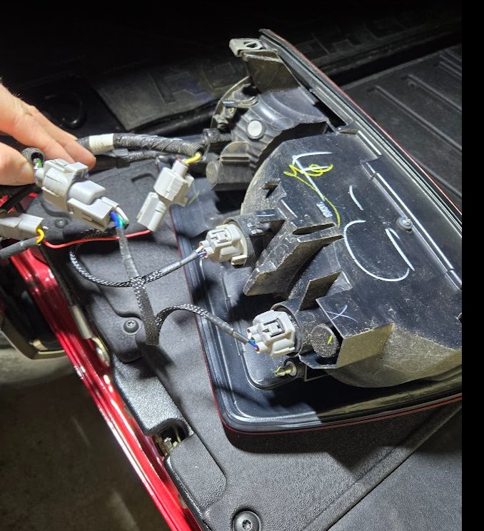

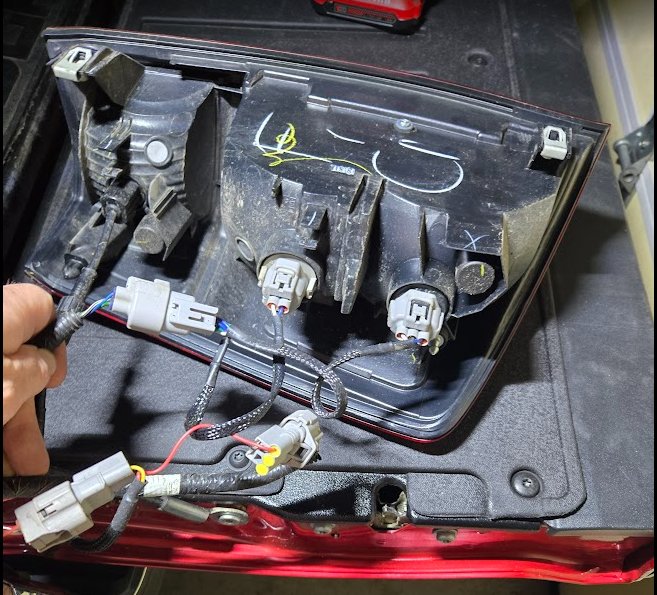

    I just took mine apart for the pictures, your top running light still has the factory wiring, all factory wiring should be plugged into part of the vtail harness...
    Let me know if you need anymore pics before I put it back together...

    I think I figured it out. My top bulb goes blinky blinky, not middle bulb, switched a couple wires, and bam! User error.

    Just saw this, thanks for stepping up big time. While you were doing that, I figured that out, really appreciate you.
