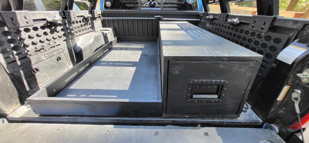

    Finished installing my bed rack and custom drawer/slide.

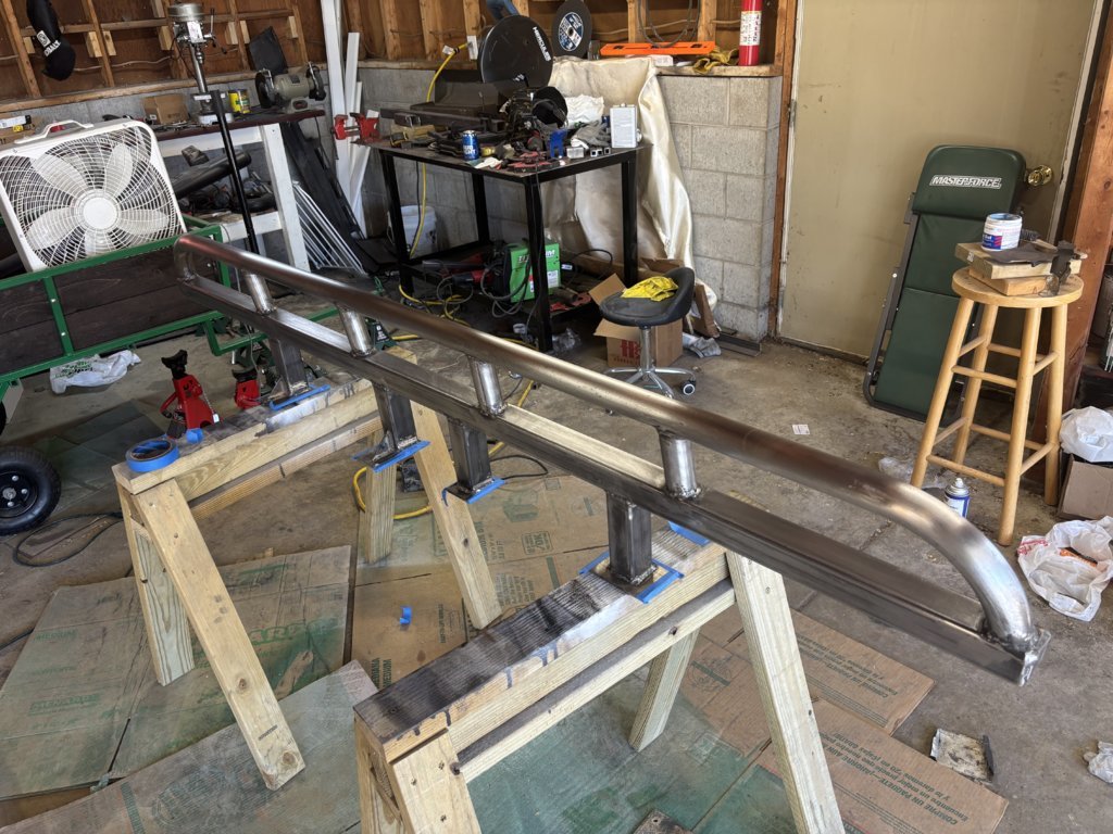

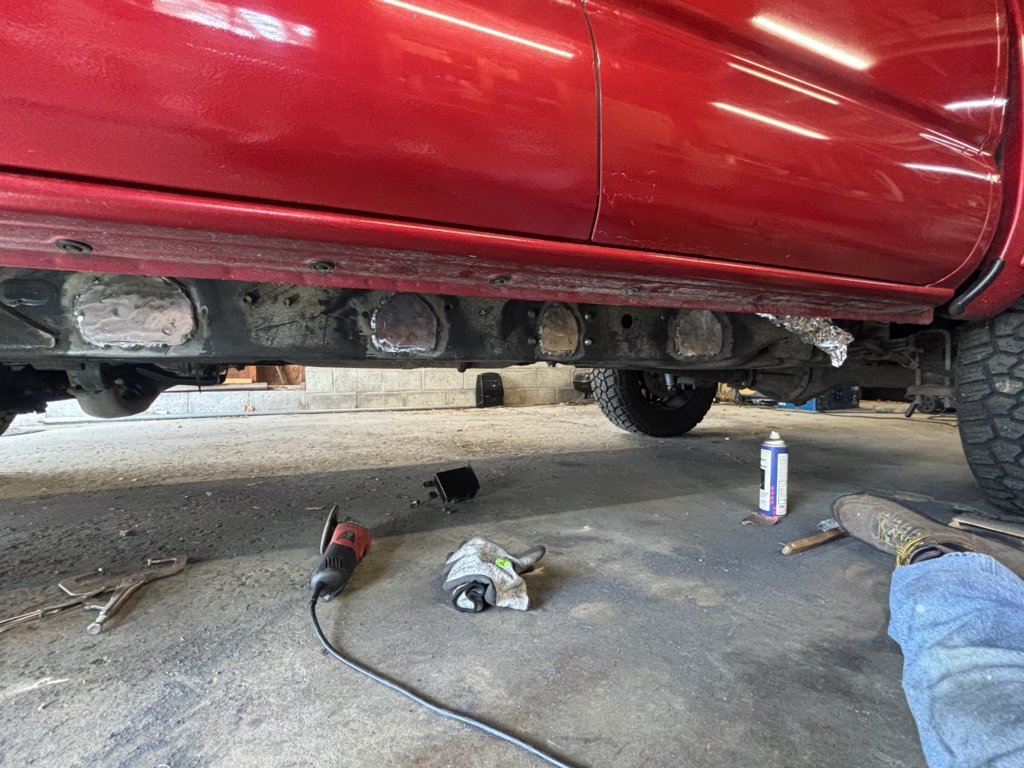

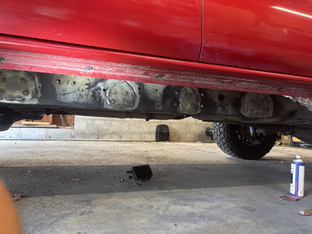

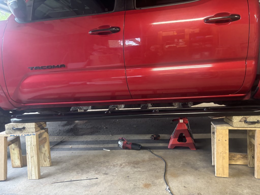

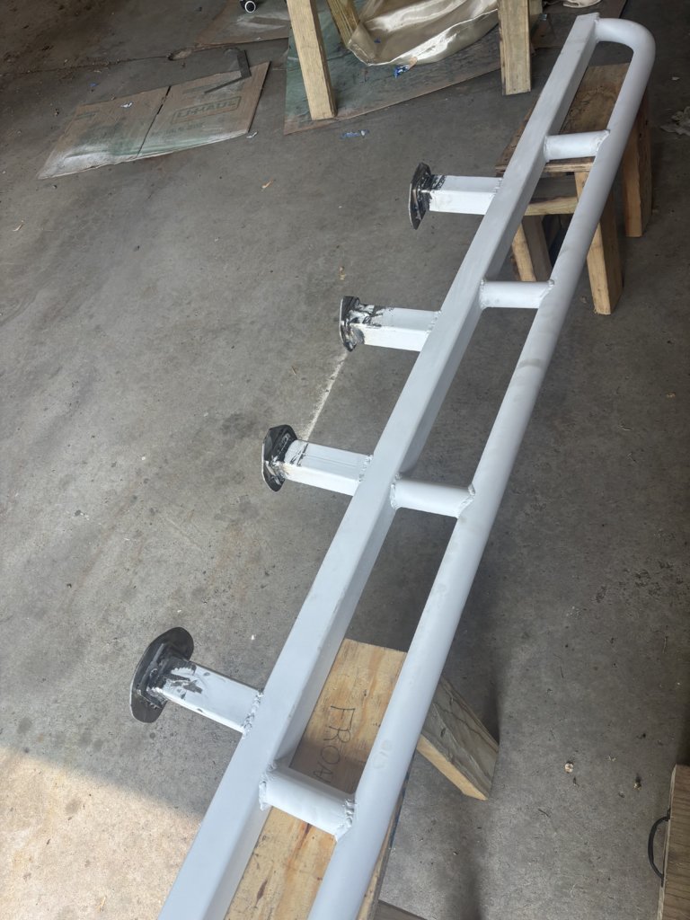

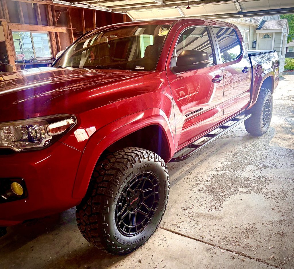

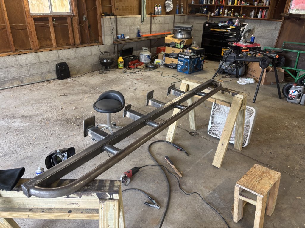

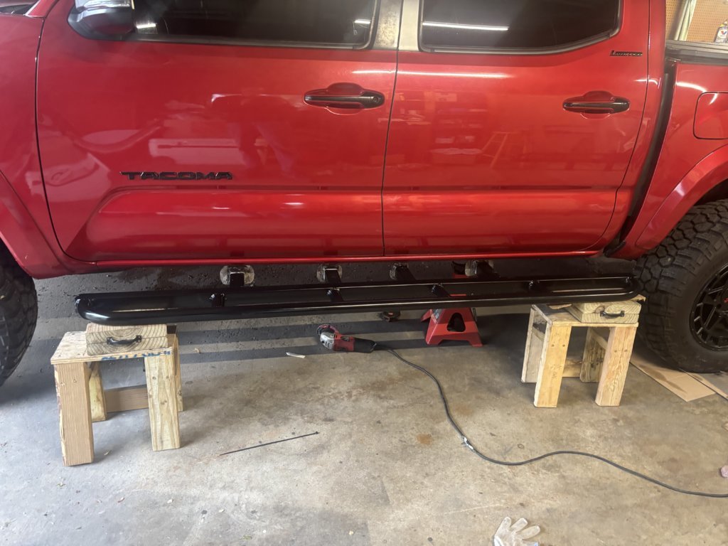

    Fabricated some rock sliders. It was a fun but quite lengthy project.
    Here is the project from beginning to end:
    I had a fab shop bend the 1.75 tubing
    then picked up the square tubing and 3/16 plates (welding them on)
    I went with four gussets. Welding these up was the easy part. The titanium 125 flux core mig welder from Harbor freight made it a breeze. Especially with the blue Demon wire.
    Since I wanted them at 5°, I decide to build these stools at the exact height and angle that I needed to make The fit up easier.
    Here I attachedthe plates on my frame and cut and welded the square tubing, tacking everything together, so I would have no issues with fit up later. This way I did not have to pull a single measurement, besides measuring the distance from my frame to the slider which was 6 inches.
    my original intentionhere was to weld the 3/16 plate to my frame. But as you’ll see later, I cut these down and ended up welding 1/8 plates to my frame to weld these 3/16 plates to. I didn’t feel comfortable running the welder at the 3/16 setting and welding it to my 1/8 frame. And also I decided not to do vertical welds on my frame, so I had the plates cut in a triangular shape which I rounded all the corners
    then welded them to my frame in the exact spot that they needed to beIMG_2745.jpg
    I used plug welds as well as stitch perimeter welds to attach the plates to the frame. Then ground down everything nice and smooth.
    Already having the sliders sanded, primed, and then painted, I was ready to weld them on.
    The stools made this part pretty easy. I chose to use some automotive sealer on the top of the plates since I could not weld them also sealing Between all stitch welds.IMG_2742.jpg
    I applied it quite thickly so I’m gonna have to wait before I can prime and paint all welded areas.
    I spent a little over $400 on the steel that I needed. And another hundred bucks on primer and paint along with some welding supplies. so about 500 bucks in all. Not bad. I will not be doing any rock crawling though just hitting some Michigan trails. I did bend up my side steps last year, so that’s why I made these. They should perform very well.
