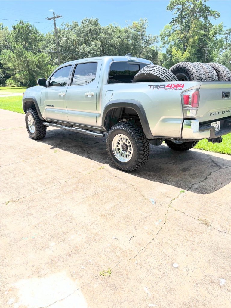

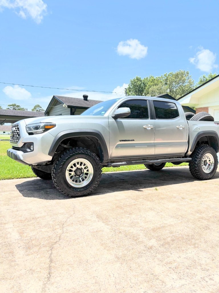

    I installed my lift last weekend, Icon Stage 8. Coil over pre-load to max and RXT leaf springs on option 3.
    Just had the tires & wheels mounted today. Icon Anza wrapped in Geolander M/Ts. 275/70r17.
    I’m wondering if the tires look proportionally too small, but I’ll see if it grows on me. I have 30 days to decide.

    How much weight do you carry in the bed? Option 3 is a bit much for an empty bed.

    @pinche_wedo I concur with this ☝️
    The truck looks great but I do think the tires would look more proportional if the rear wasn’t as high. Although if you need that for cargo and/or a camper of sorts then I totally get it.

    yeah, I’m feeling it. Switching up soon.

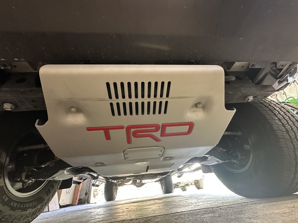

    Toyota 4th of July sale. $327 with tax and shipped to the dealer. Got a chance to install it today. I’m sure there are better steel skids available but for the mild off roading down gravel roads mainly, it works for me.

    Welcome to TW, truck looks good, but I agree, little to much space between the tire and bed finder...

    There may be better ones, but none are better looking than yours.

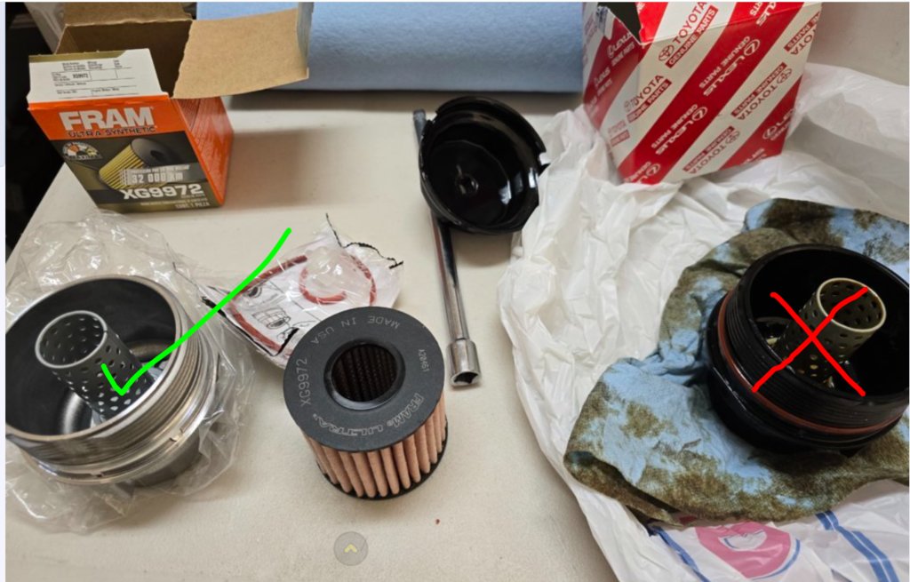

    About that vacuum, I just noticed that the plastic filter housing was hard to unscrew, maybe because of expansion and when removing it the engine was always warmed up to operating temps, which is pretty hot according to my fingertip. And each oil change I swear, seemed like that housing got tighter and tighter, and harder and harder to get off.
    So anyway, to avert a disaster, I replaced my plastic with the metal housing at my 75k oil change, I'll let you know at the 80k change if the housing comes off easier than the plastic one when its at operating temps....
