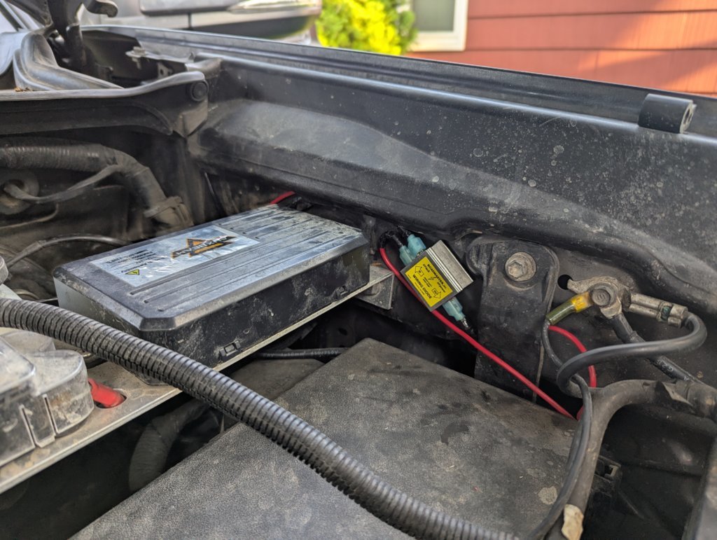

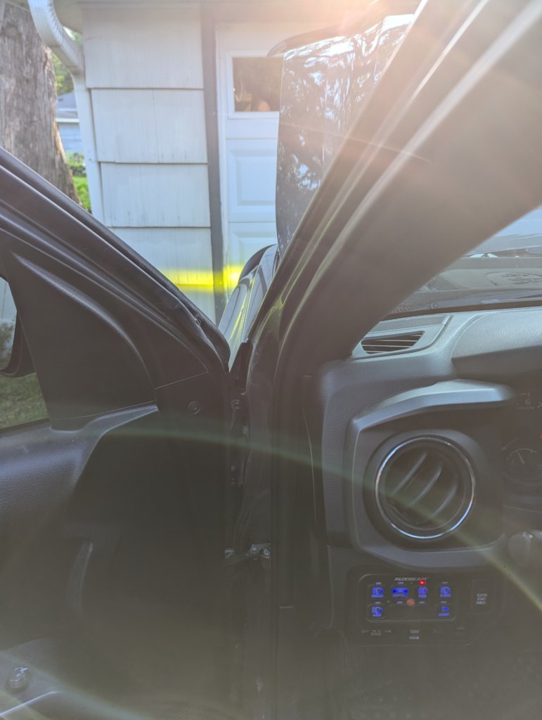

    Installed a truly 100% anytime fog light mod on my truck.
    Only $25 and a little bit of wiring.
    I spliced in a Roadmaster 790 Hy-Power Diode (second picture) into the fog light wiring right next to the radiator (third picture, hard to see since I forgot to take a picture before I wrapped it back up.) That way I can run them through the OEM controls or switch them independently through my AuxBeam controller without back feeding power through one of them.
    Now I can run my fogs with high beams or no head lights or anytime I feel like (first picture key on, auxbeam switched with all other lights off ((sorry about the sun flare in the picture, going for the JJ Abrams look))

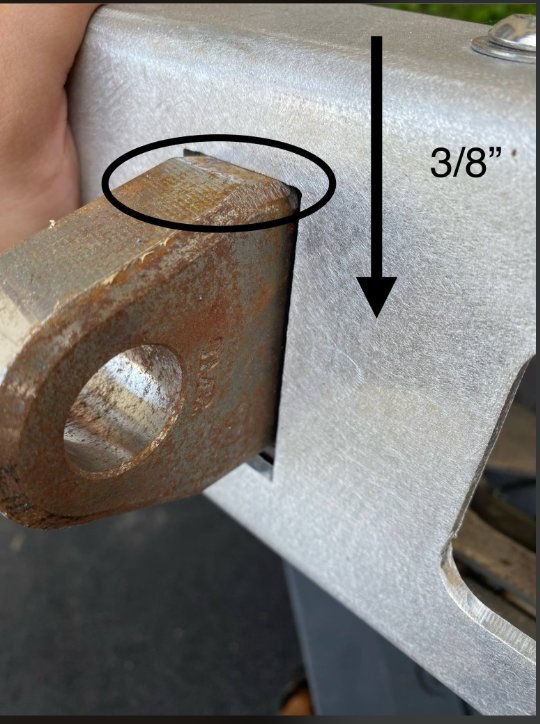

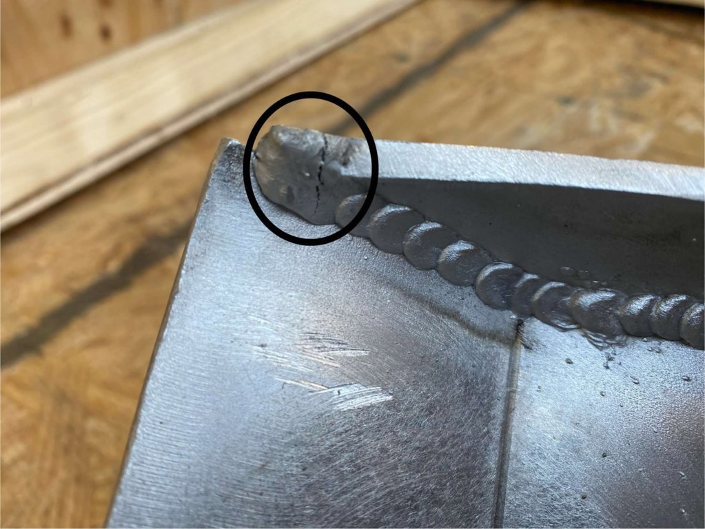

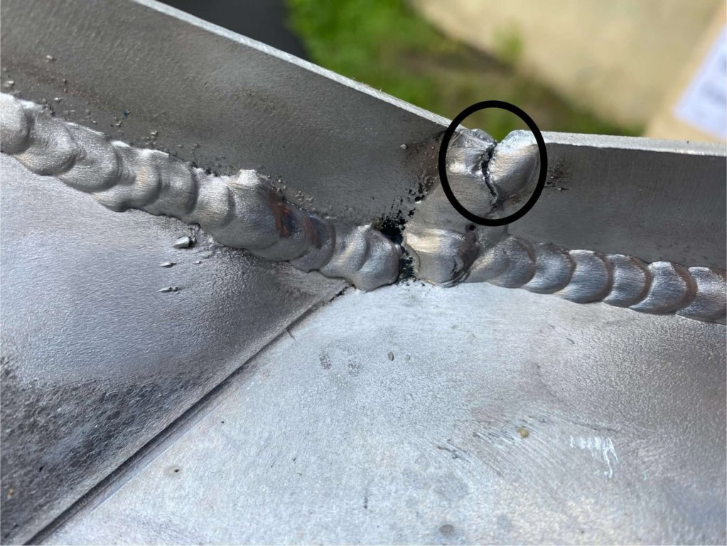

    I purchased a new Hefty Fabworks Banshee front bumper from facebook marketplace. For a pretty well know offroad fab shop, there is definitely some manufacturing issues. Several cracks in the aluminum welds. The recovery point openings are too small as well. I need to cut over 1/2" of material off the top to be able to fully bolt the faceplate on and have an even top-to-bottom gap. I am debating on getting this fixed or just painting and going on.

    I am just gonna say it, I would be scared to do much of anything with those welds you showed in the 1st 2 pics, they look like someone with zero training of any kind (not even a YT video) tried (and I mean tried) to weld that, the welds have no penetration to them... To me it just looks like a knock off by someone that has never welded before...

    The aluminum section is a faceplate that isn't structural to anything. It definitely isn't a knock-off. Unfortunately, i see this quality pretty frequently at work with aluminum fabricated pieces. Suppliers turn-and-burn. When i complain they usually replace it. Even though I'm not the original purchaser (it's still a new part, never installed), I am going to reach out to Hefty Fabworks. Aside from the welds, the facepiece wasn't even test fit because it can't even be bolted down all the way. In the least, they should know there are some quality control issues to address.
    there are some places were the bead didn't penetrate the base plate.

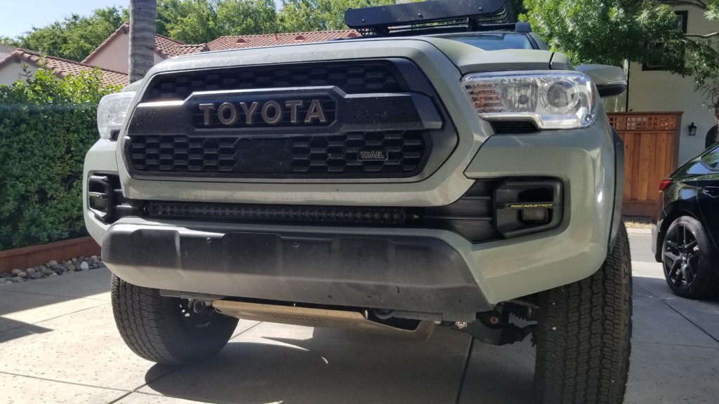

    Bag on Rough Country all you want but, they have been incredible with product support. Long story short, I have a 30" Black Series Light Bar in my lower grill. The first one showed up and looked fine. Had it on the truck for a month and every single screw hole in the lense had shattered/spawled from being over tightened duing assembly. Even the screws were stripped. They replaced it. No questions asked. The second one has been on the truck for a while and started condensing moisture. They sent a replacement. No questions asked. Pretty impressive customer service. Quality? Um...well...;)
    We will see how the third one does.

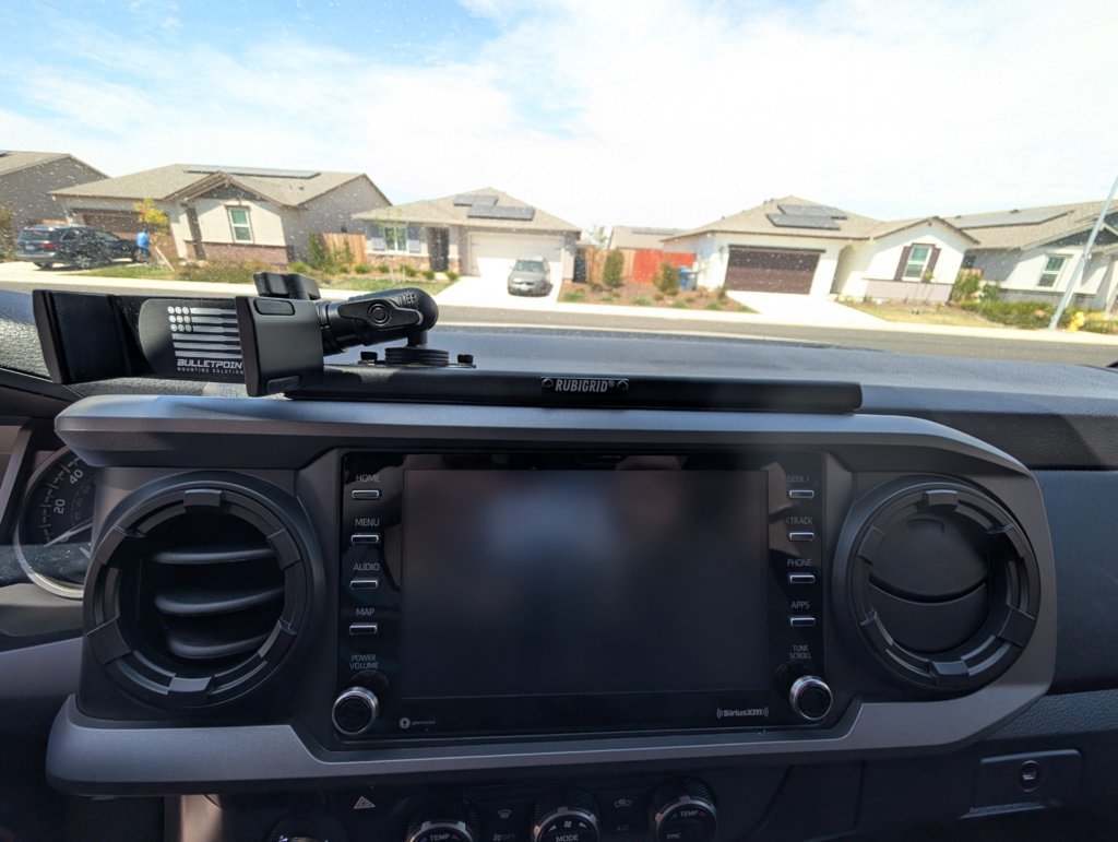

    Installed the Bulletpoint Mounting Solutions Rubigrid mount. Looks good so far and install was easy and straightforward.
