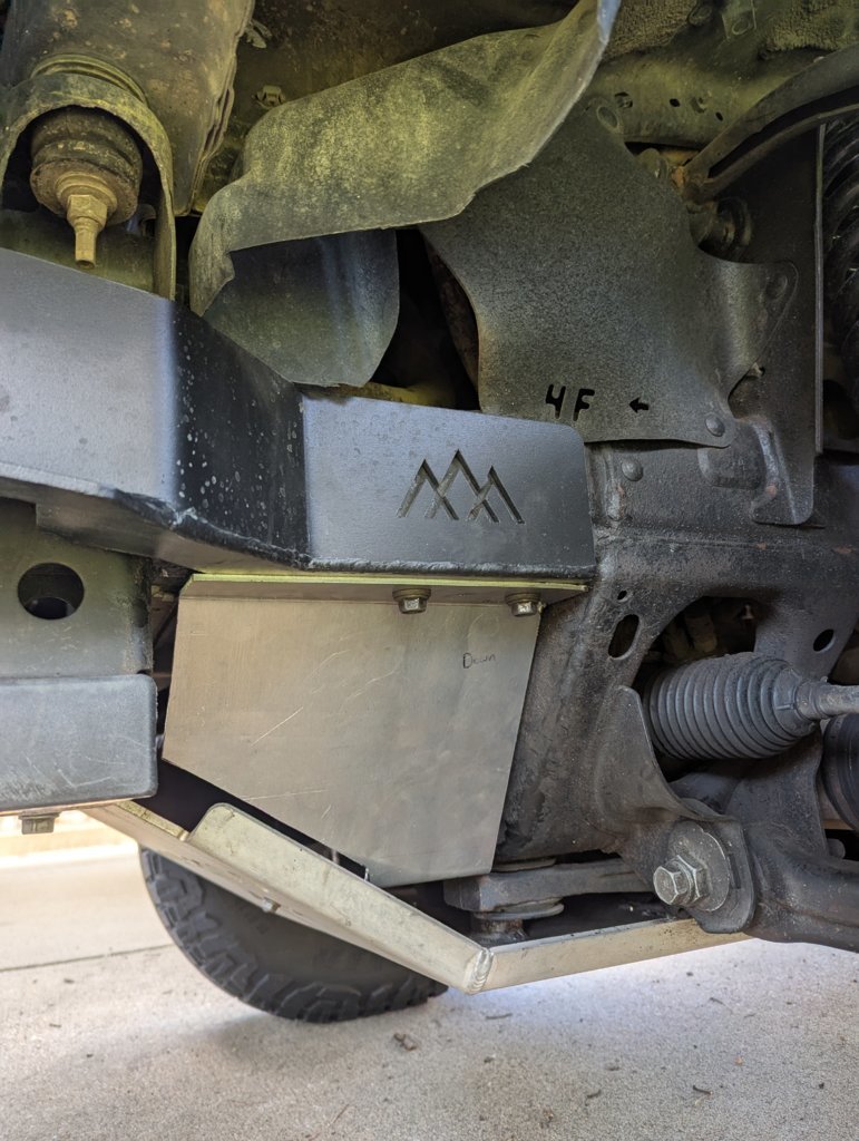

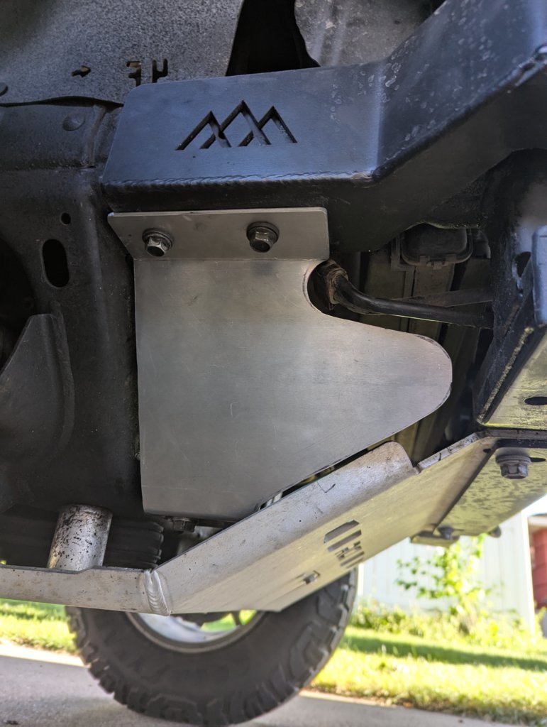

    After having my AC crap out on me I decided to make some splash guards, just in case the cause was from it constantly getting splashed.
    They were pretty easy to make out of some 1/8" 5052 aluminum I had laying around. They mount into the abandoned sway bar holes and into some nuts that were used by the oem engine splash guard, I think.
    MVP awards go to my Swag band saw table and hydraulic press brake, I don't know how I managed to do any fab work before getting those 2 tools.

    Looks great those tools help but angle grinder a vise and a hammer just not as easy to do. Should help with splashes for sure, but will it help longevity i think if you live in the salt belt it will be a common issue a/c clutch
