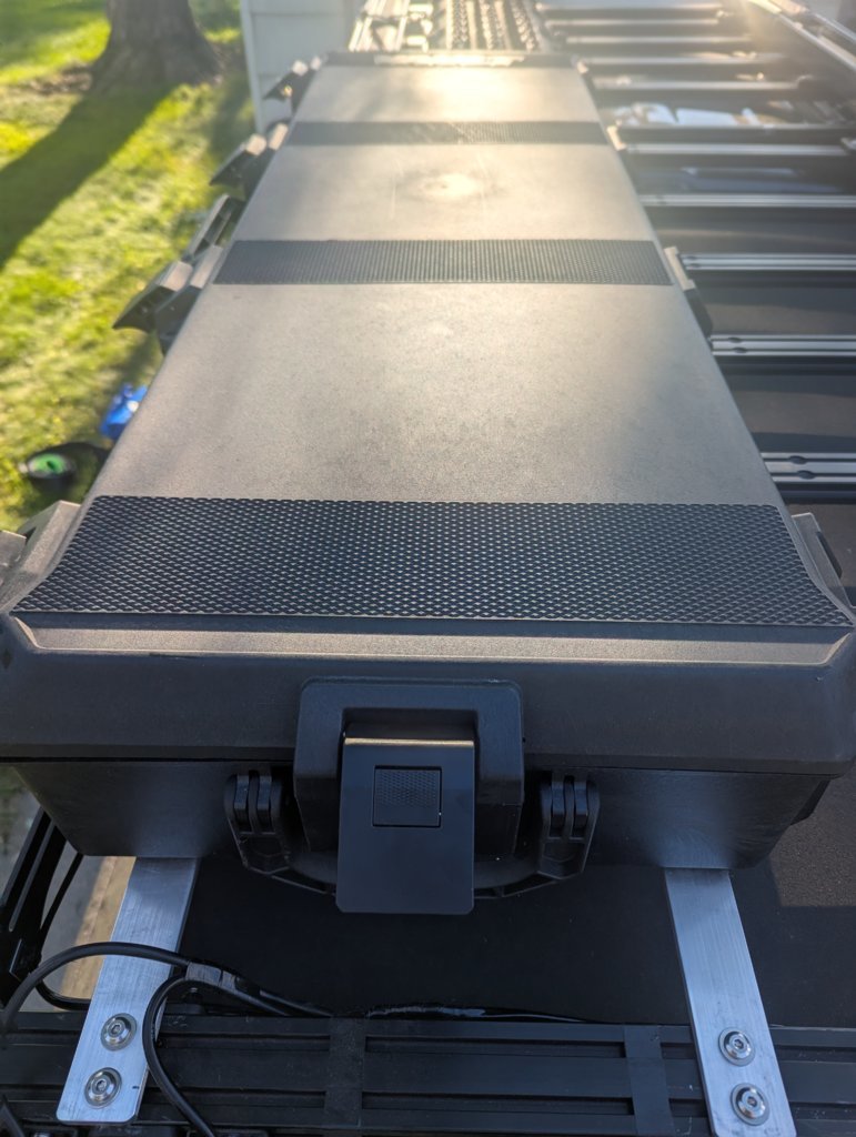

    Fixed an issue I noticed when off roading on my Texas trip.
    How I had my roof box mounted it isn't using any supported crossbars so it was flexing the rack side rails. I am surprised that with how hard I was hitting some bumps it didn't crack the Prinsu rack.
    So I ran some 1/4" aluminum bars the full length of the rack so hopefully now the rack won't flex under the weight of the box.

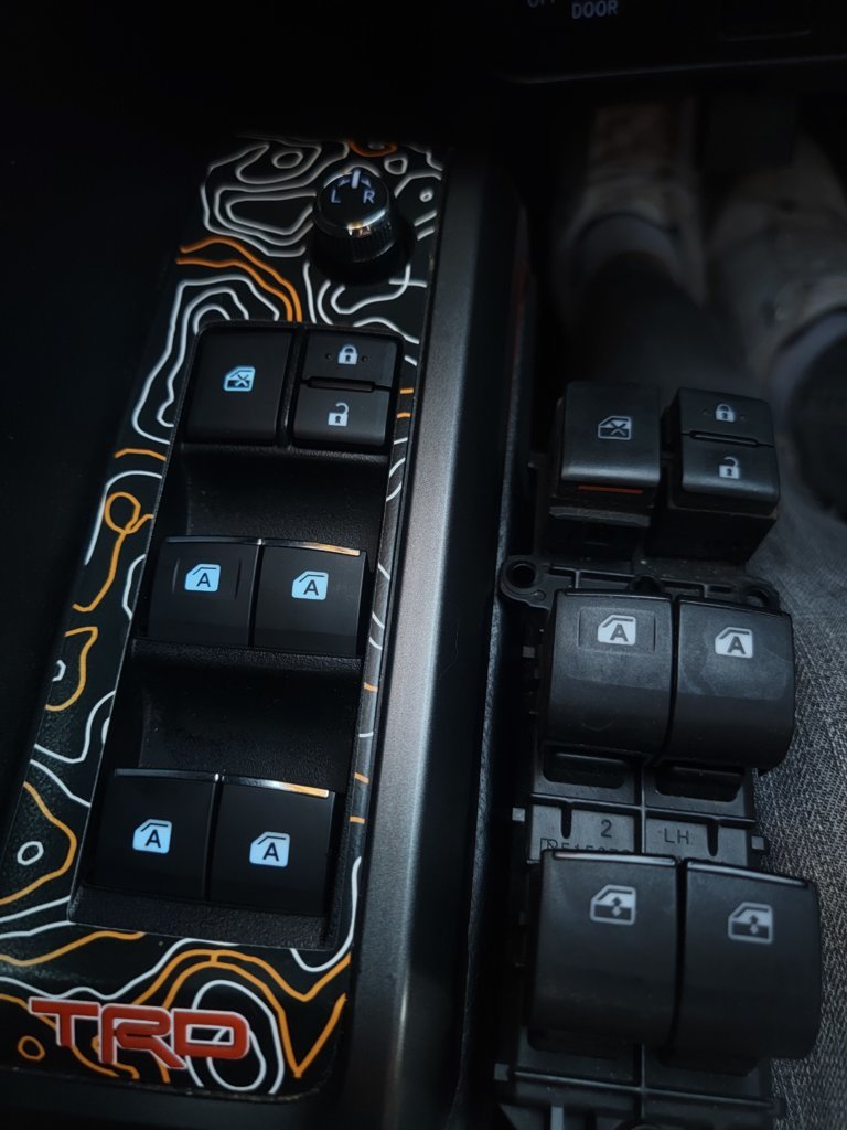

    Got it quick! And looks like I lucked out and got blue. I also THOROUGHLY enjoy the increase in haptic feel of them as well. I hated the fact the oem wasn't as haptic when trying to get it to that auto click. Almost always gotta hit it twice. Ha.
    Didn't think I'd be excited about this as much as I am. Definite :thumbsup: in my book for a cheap chinese aftermarket part, which is rare and usually the opposite when it comes to parts like this. As long as it lasts anyways. :rofl:
    The only other difference is the tiny trim pieces on the switches, are chrome. Where mine were black. Idc tho.

    For the back windows does it seem like the motor is still trying to roll up the window once it's up? I was thinking about getting these but I am very hesitant finding out how the rears don't have the pressure sensors. Wondering if it would burn out the motors after awhile.

    Just tested it. Pressure stays on for about 5-6 seconds then releases.

    The little I have read says the stopping ability is in the motor itself. If that is true I wonder if fromt motors with the safety would fit in the rear. I want to install this mod but my dog usually rides in back and really don't want to do it without the safety

    I only report what I know ... window assemblies that did not have the pressure sensors will not stop if under constant power. Enough for me to not waste money finding out that the rear windows are now hazards instead of "convenient". I have other ways to spend money.
