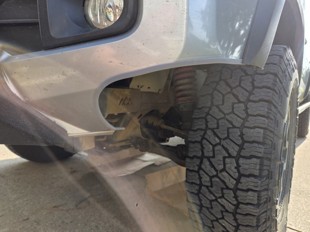

    Another view:
    I cut my curve quite a bit more open than most.

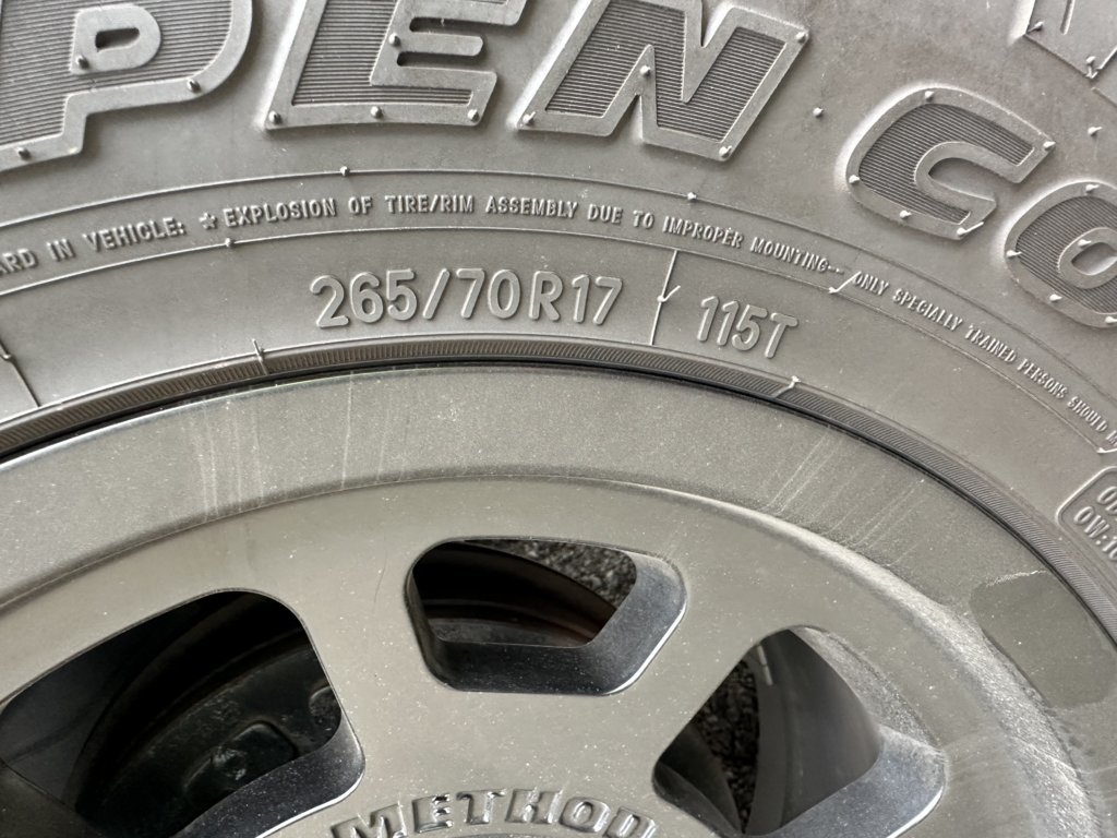

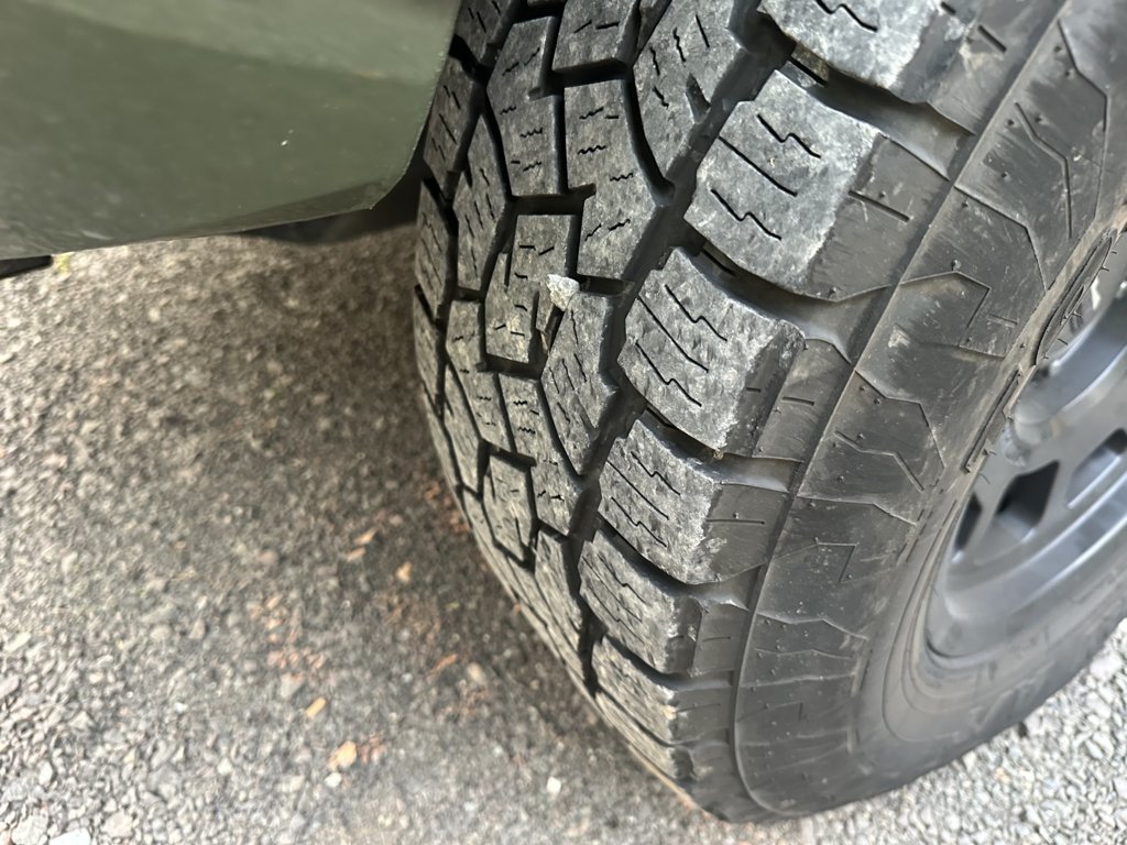

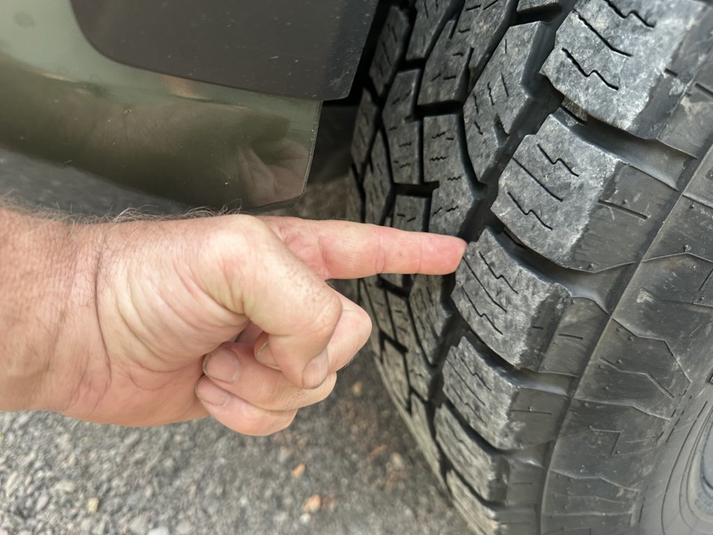

    K I need some sage advice from the folks here.
    I got almost 40k miles on my Toyota ATIII tires and they’ve performed flawlessly up until lately the rears will break loose when I stomp it to jump out into traffic. I think this is due to the middle lugs losing part of the siping. They have 8/32’s left on the treads and although that doesn’t seem like that big a deal, I drive on the assertive side. I demand a lot from my truck to get me where I need to go with no nonsense. Anyhoo, we got an El Nina winter coming up and I’m contemplating getting the BFG KO3’s I been wanting. Also, I live in Western Washington and it gets a lot of rain. These tires are great in the rain but they been losing tread since the half life and I don’t need any issues during my commutes. Or do I risk another winter on these?
    upload_2025-8-30_17-12-37.jpgupload_2025-8-30_17-12-49.jpgupload_2025-8-30_17-12-59.jpgupload_2025-8-30_17-13-14.jpgI know some will say WTF is your problem dude? There’s plenty of life left in those! Your right. But I’m a pain in the ass that gets something in my head and won’t let it go until I deal with it. I drive mostly highway and have always kept good rubber on my rigs so I can get home safely to my family. I usually change tires late summer or fall after the heat of the summer has worn them down. What say you?

    K03's do alright in the rain from my experience. Not wonderful, not terrible. If you hit deep puddles on the road they really suck, but I'd imagine most tires do at that point. They're much heavier than the Toyo At3's in 265/70/16 D range. Some downsides to that.
    edit: You've got 265/70/17. I think you can get C rated K03's. I'd recommend those.

    I’m looking at a set of C’s and they’re 46 # ea. around 4 # more than my Toyos but if they last as long as my experience with KO2’s I’m good with it.

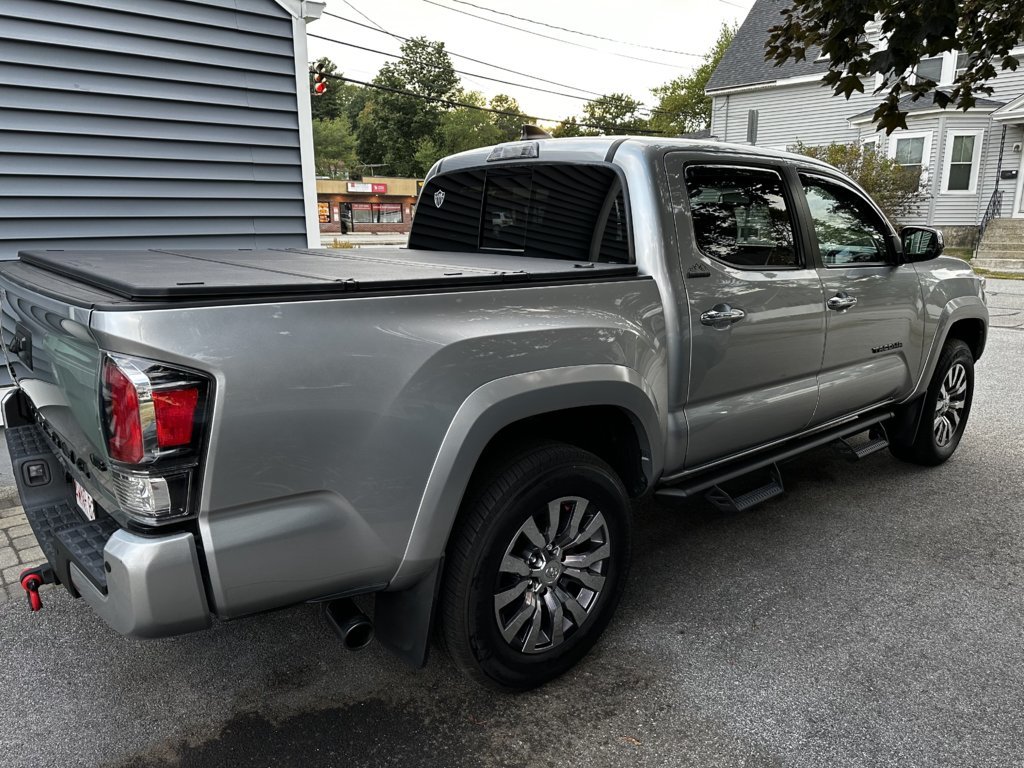

    Did a 15k oil change , Tire Rotation, Cleaned the Air and Cabin air filters, Washed , Waxed and interior details.IMG_4823.jpg IMG_4825.jpg

    What is the last 4 of the DOT number on them??
    To me, it has been safety 1st when it comes to tires, I always buy great wet weather tires, but if your tires are no longer doing what you ask of them, then the amount of tread left is moot...

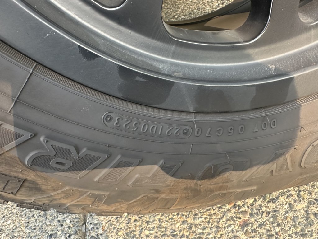

    upload_2025-8-30_17-45-34.jpgIm running 30 psi cold. Does the 0523 mean they were made in May of 23?

    Yes and no, production was the 5th week of the year of 2023... 1st 2 numbers are the week of the year, and as you guessed, the last 2 are the year... Well at least since 2000, 1999 and older ran a 3 digit instead of 4, you only new the week and the last number of the year, so a 059, could have been the 5th week of 1979 or 1989, or 1999...
    Your tires have not aged out, just lost it's traction somewhat...
