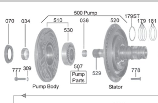

    Is there any reasonable way to fix a TH350 from not doing the converter leakdown to the pan? After half a week or so mine pukes ATF (I know I need to find the high leak (dipstick oring etc), but your post had me wondering about the main cause of the fluid leaking to the pan. Which causes it at times to delay going into reverse for a few seconds also we sat.

    The torque converter is draining back through the front pump and input shaft and overfilling the case, short of pulling the trans, and front pump and replacing the seals and bushings in the front pump and maybe even the torque converter, not much you can do about the drain back.. But if everything is good and not worn out or damaged, it still shouldn't leak externally..
    Clean the trans really good and then watch for things like the selector shaft seal, TV cable boot, filler tube O-ring, and pan gasket for the external leak, and in some rare cases the speedometer cable housing may be the external leak...
    Or just go out and start the vehicle in for a few seconds a couple times a week, You can start it in neutral and by the time you put it back in park, the converter will be full again...
    Like I had said, converter drain back is very common, just give it a minute before putting in gear and trying to drive off...
    Basically replace part number 034 (pump bushing), 036 (stator bushing) and 070 (front pump seal) for the converter drain back (slow down, not stop)...
