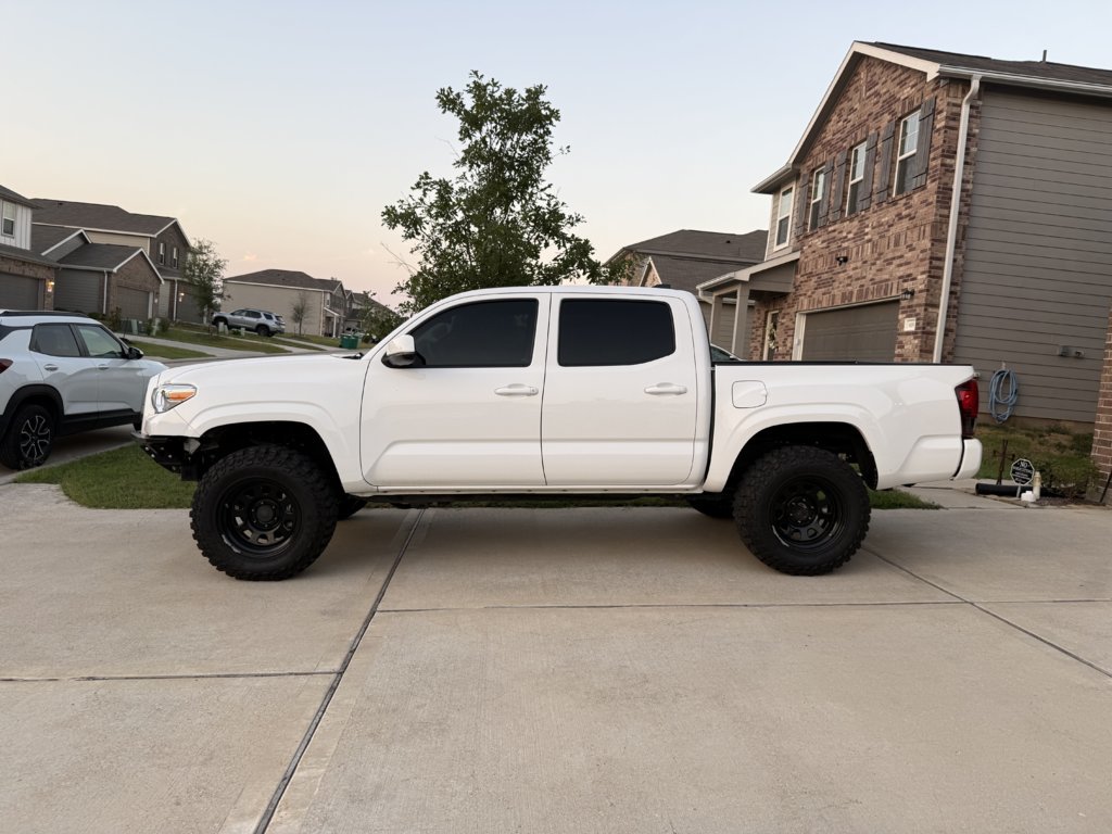

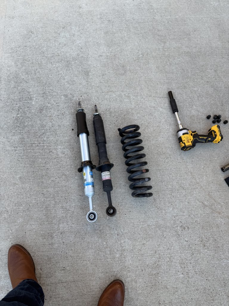

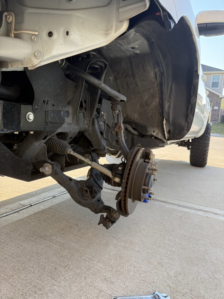

    Went ahead and put in 5100s on the third notch up front. Stock suspension otherwise.
    The front came up a little over 3/4 of an inch. Less than a 1/4 from being level with the rear. Sits exactly where I thought it would with the weight of the bumper.
    Tomorrow needs an alignment. The front suspension now definitely out performs the rear lol. I took it over a very rough road to make it settle.

    How's it look sitting on a level surface? Seems like the front is up higher now.

    Looks good. I generally don't comment on lifts, but this appears to have worked out nicely.

    my driveway is slanted pretty good. The rear is less than 1/4 inch higher than the front which “visually” makes it look dead nuts level. I do need a better photo on flat ground. I follow Thuren’s opinion on a leveled truck.

    I think it looks good, the photo is like a house of mirrors, though. The expansion joints in the concrete and homes not being level in the pic only serve to exaggerate the illusion.
