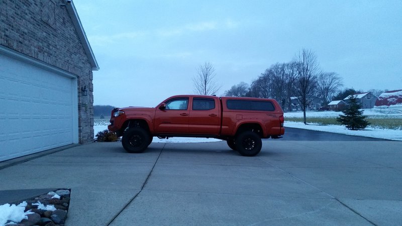

    What brand fog lights are you running? Great looking build man.

    Thanks man!! They are Baja Designs Squadron Sports
