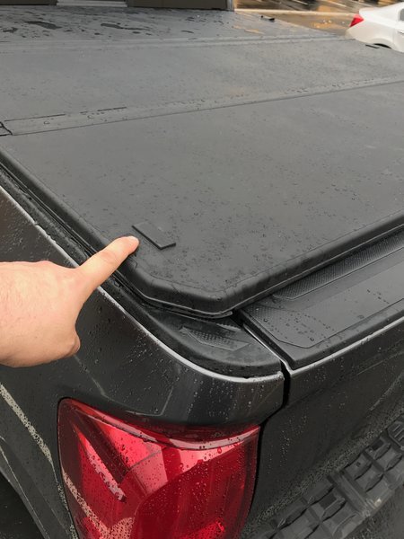

    on the top of the cover where the latches would be are "bumps". when the cover is down and still has some play firmly push down on those bump on either side with two hands (or 1 stong one) and you will hear another click. i close my cover pretty hard and it usually latches first time every time but when it doesnt that what you need to do. all covers are like this if you dont close them hard enough

    this is the "bump"

    You went all out in this rain to take a picture for @SouthtownTaco :thumbsup:
