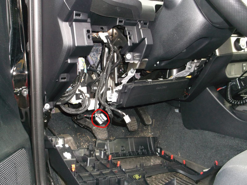

    The connector is back on the lower Left side of that switch panel area. I just reached back in there and found an unused connector taped to the wire harness. By the shape and number of wire connectors it had I figured it was the Cargo Light switch connector. I tapped Power for the Dashcam from the lower fuse panel and the Switch illumination wire from the Cargo light connector. I have to turn my Dashcam off when I enter my work location ( Military Installation) so I have a power switch on the dash so disable it when I need to.

    OK, here's what i have that might help. I found these images in another thread when I was looking for an illumination source wire. In the first image you can see three switch connectors hanging loose on the wire harness. The one on the left is the Cargo light switch connector.
    The second image is the back of the switches. The one on the Right of the panel is the Cargo Light switch so you can see how many pin openings (6) the Cargo light switch connector has. I used a power probe light to determine which was the illumination wire. Someone has said it is light green. I don't remember,so check to make sure which is the right wire.
    BTW, you don't need to take anything but the switch panel cover off to do this. These aren't my pictures. I just pulled the switch panel off and did all the connections from that small opening. Hope this helps.

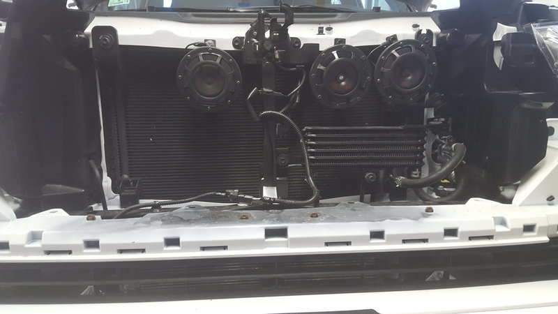

    Upgraded the horns. Took these off my last truck and I had one lying around so why not add it. I bought a set for my bike but could only fit one, thus the spare. If I get rid of the bike I will add it to the group.These horns are great for wondering texters. Also showing off my flat black painted radiator.
