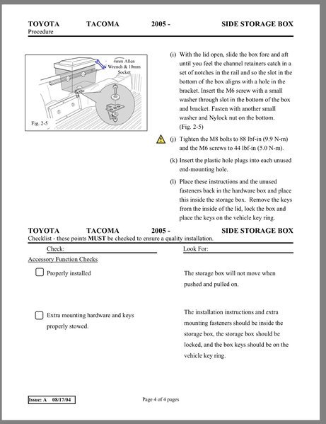

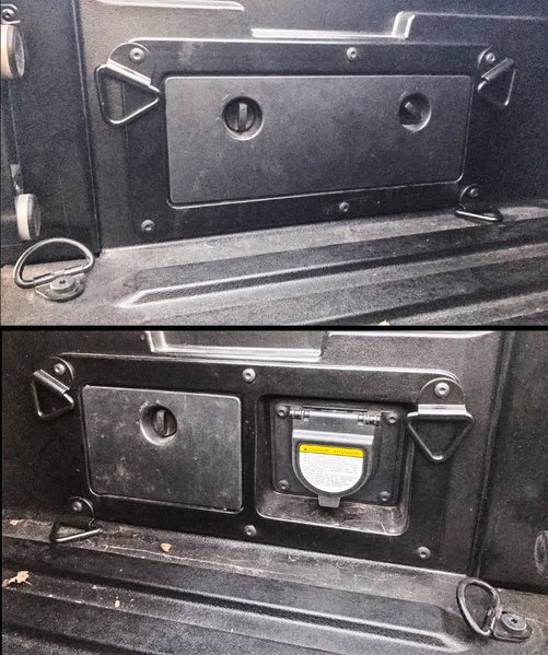

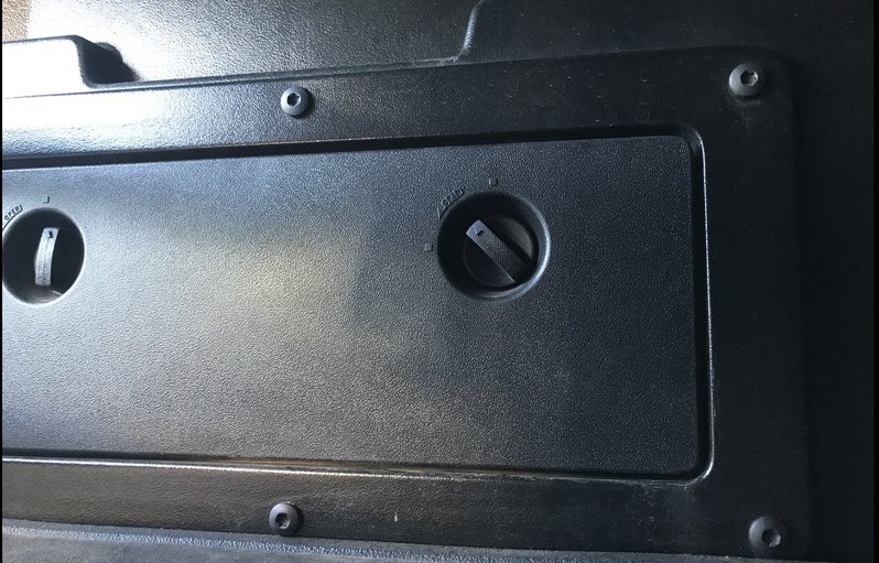

    While ago I installed some beefy Dodge (mopar) D-Rings on the truck bed. Applied the correct torque spec found on forum but can't recall but must have been 55 lbs.
    Im anycase, today got these 1/4" steel (SR12 2400#) D-Rings to install around storage box (4 each sides) located towards the tailgate. Anyone know what the torque spec is on these bolts?
    Thanks!
    https://www.ebay.com/itm/1116806199
    * Update #1:
    All these bolts losened with ease. I mean with incredible ease, didn't apply much pressure if any. Afterwards I just tightened these more than they were before. Will get a torque wrench later & look into exact torque spec later. Added the installed pics.
    My goal wih these is just to secure gas can or whatever stuff.
    Update #2: (page 3-4 screenshots attached)
    https://www.toyotapartsdeal.com/ins...574270072cb15_sidestoragebox'05tacomaissa.pdf
    In this 2005 Tacoma side storage install documentation, it says:
    On page 3 for removal, calls it M6 screw:
    >>>"(e) Remove top forward M6 screw of the vehicle bed side storage box frame and install bracket using the same screw that was removed. Snug the screw down but do not tighten completely. (Fig. 2-3) "
    On page 4:
    >>>"Tighten the M8 bolts to 88 lbf-in (9.9 N-m) and the M6 screws to 44 lbf-in (5.0 N-m). "
    So it looks like I need to tighten it to 44 lb torque spec.

    Use a torque wrench to loosen them. Start at 20 ft-lbs and increase setting 5 ft-lbs at a time until they loosen. If takes 40 ft-lbs to loosen then torque back to same.

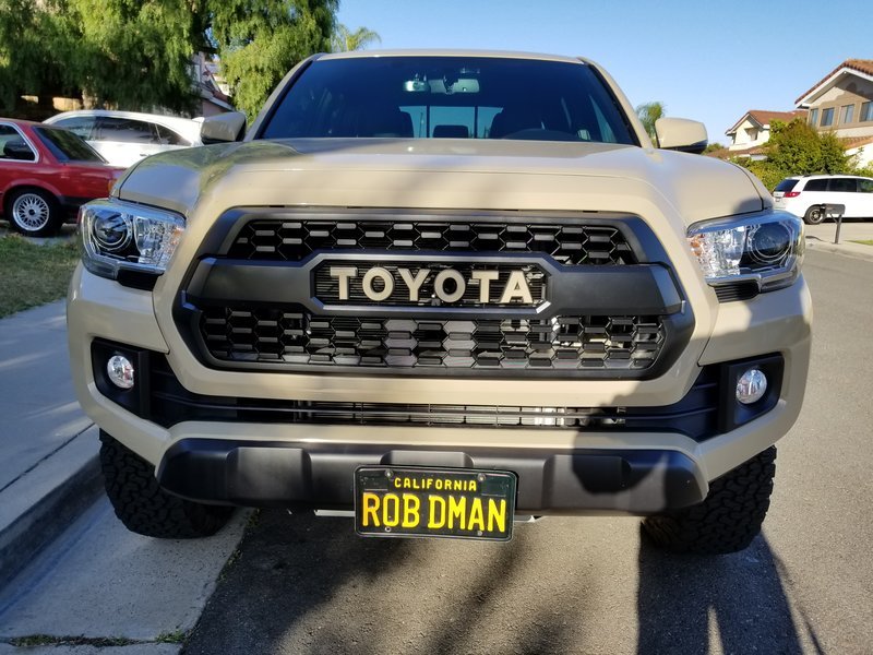

    a lot
    changed up the Plastidipped red letters to quicksand

    Thanks but all these bolts losened with ease. I mean with incredible ease, didn't apply much pressure if any. Afterwards I just tightened these more than they were before. Will get a torque wrench later & look into exact torque spec later.

    They might only have a 35 ft lb torque rating. I have seen others on tw that added rings in the same spots. Maybe search d rings in 3rd gen forum. Sorry assumed they were still attached. Could always go to dealer parts dept for torque specs.
