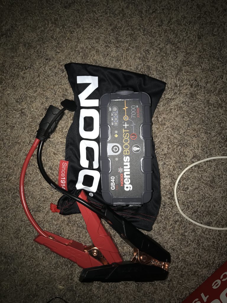

    I need to put one of these on my list. NOCO gb40 jump starter. You get that online? I'm assuming this would be great if you are out by yourself and need a jump for some reason.
