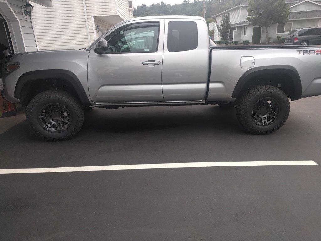

    2017 TRD ORAC
    OvTuned
    ome 887 coils on Bilsteins set at 0, 1/4 " top plate spacer on drivers , Headstrong progressive 3 leaf aal , rear Bilsteins

    What Load Rating are those tires? Would you recommend them? Thanks.
    Yes, might seem like a strange question since a lot of people run KO2s, I'm thinking of them as well, I'm just not sure if E1 rated tires will be a good choice for my DD. Then again, I would like to "rock crawl" a bit from time to time, so not sure if P rated tires will be quite ok with me airing them down. Btw, I have stock 16" rims, so no c1 option for me.
    Any suggestions from everyone are welcome.

    What's your hub to fender measurements for up front and rear?

    don't be surprised if my measurements are off by a hair , but roughly 23.75 " front/rear...the picture makes the truck look kind of squished. Before the coils I had 3rd gen Bilsteins on the 4th notch. The coils and aal's are just right for me .

    So you're almost leveled with 887s? Hmm. I figured the 888s would do that. Must be cuz you have AC I'm guessing

    your truck is bad ass!
