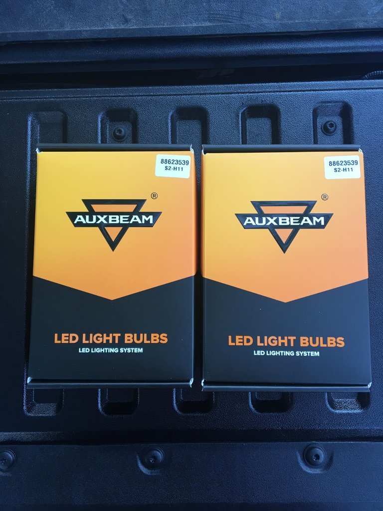

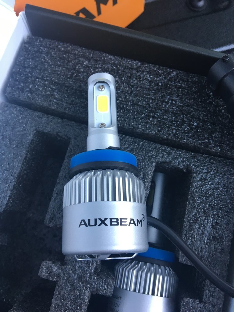

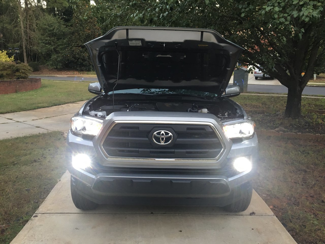

    Did these fit seamlessly in the DRL/fog light housing? Just a swap of the bulbs?

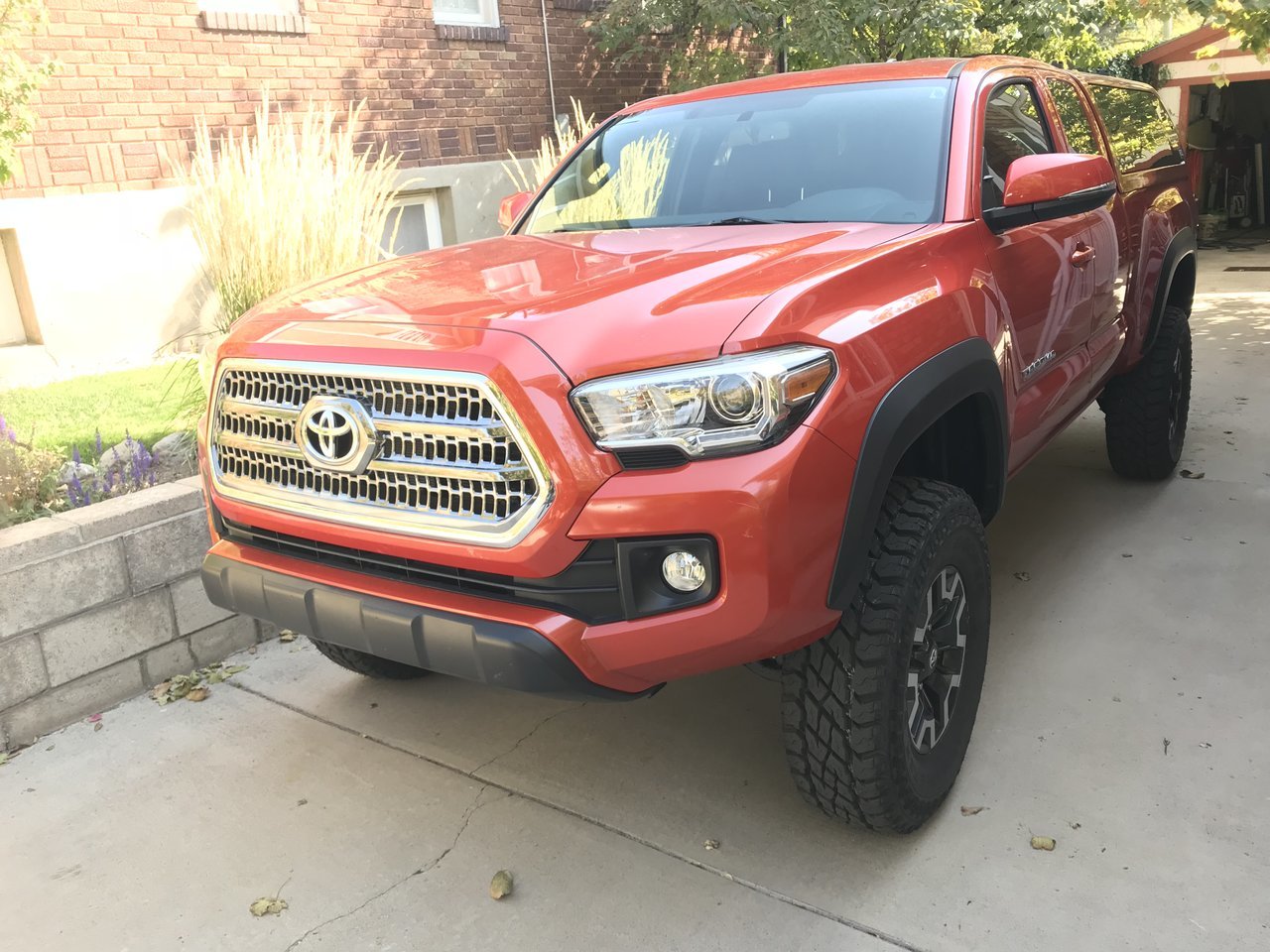

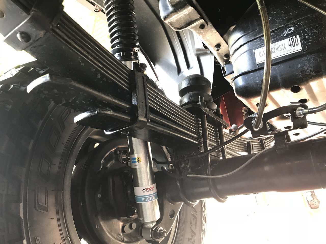

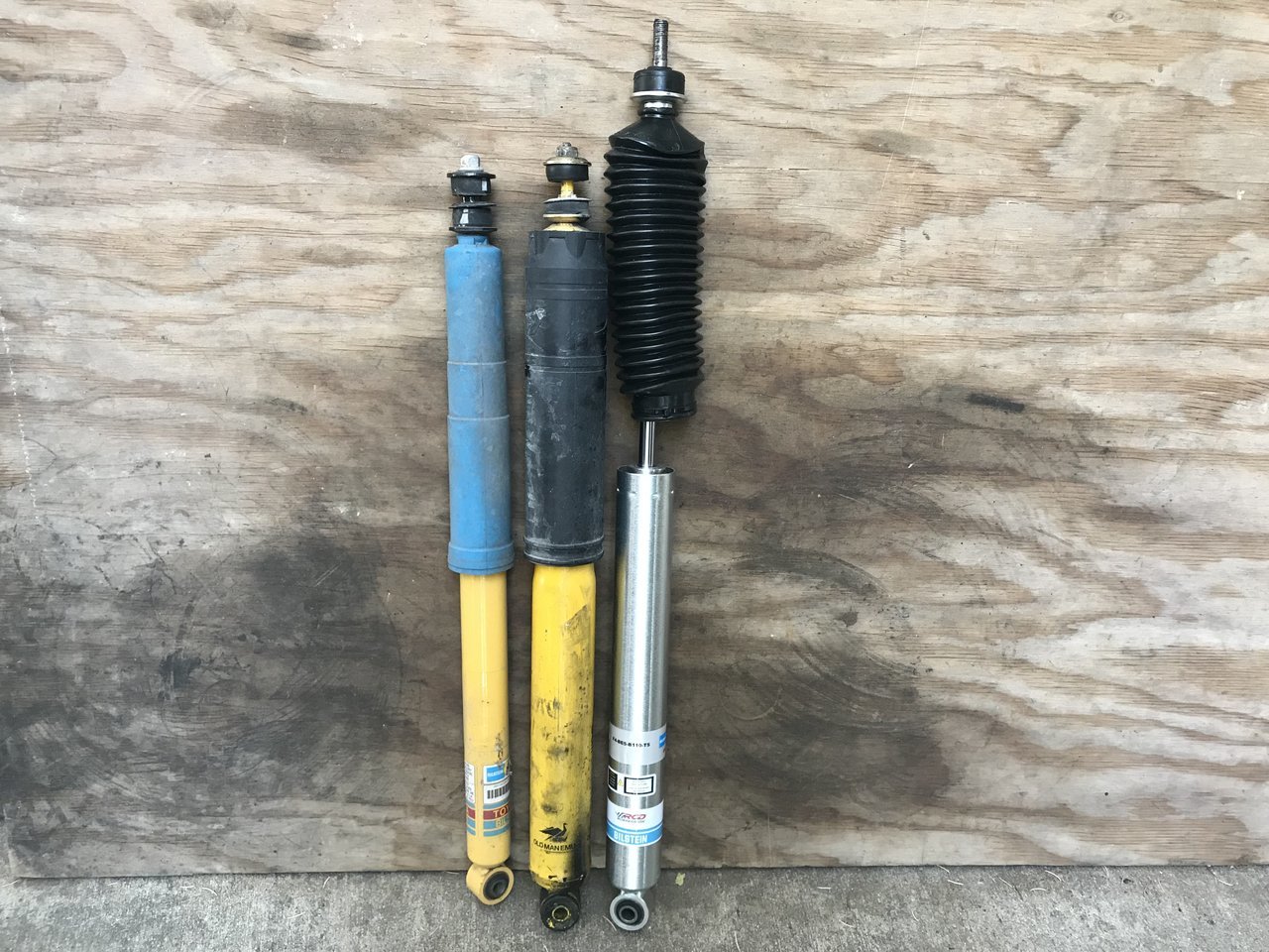

    Two things today.
    Got tires and alignment And took off my rear OME shocks and replaced with Bilstein 4 inch longer ones. 0F7363A5-CAB8-4487-ADEB-E2AEFABEEF50.jpg 164B6EC3-36D7-401A-B8D1-C319AB6DCC58.jpg CB97E91F-60F8-4CA4-BB88-7569CAED507B.jpg

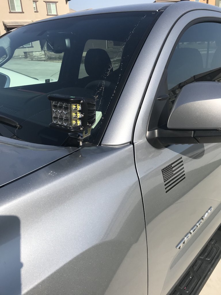

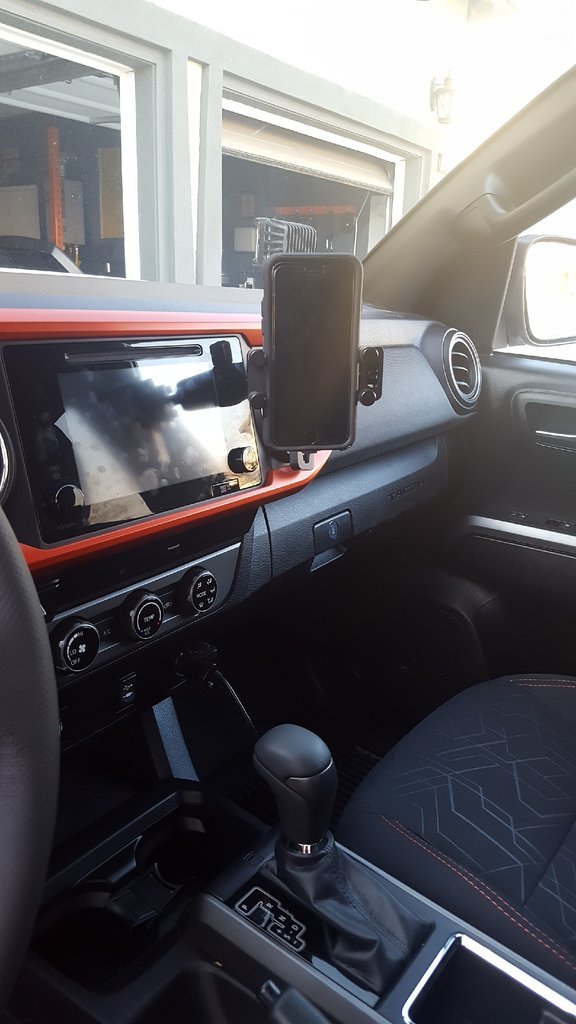

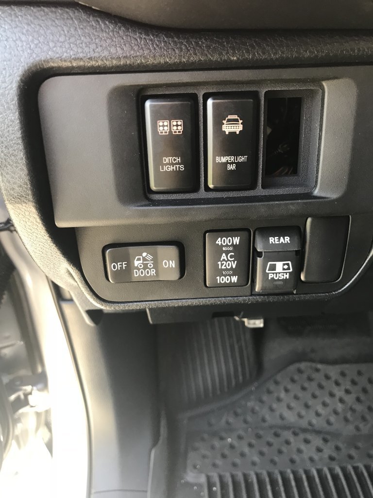

    Hondo garage cell/cb mike mount, ditch lights, bumper led bar

    Shapeways plate and Ch4x4 switches? All looks good.

    Thanks.
    Shapeways plate yes that plate is awesome. The switches are from caliraisedled but i do have an arb compressor switch on order for that blank spot from ch4x4

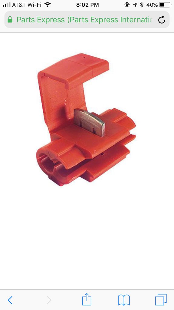

    Don’t be scared. Get a low amp draw led strip. Mine pulls like 1.3 amps. It has a positive and a negative wire. The negative can attach straight to negative battery post or to frame by the battery. Mine has a black cable coming off the negative battery post going to the frame like 2 inches away on inside of front right fender that I plan on using. The positive wire(usually red) can connect to the positive wire on the drivers side park light. There are two wires to the park light. One is a solid color and the other is a white with a black strip which I’m assuming is the ground since the left side parking lot also has a white with black strip and a different colored solid wire. I’m going to use a “suitcase” connector for that connection. You just rest the existing parking lot wire( the solid one) inside the connecter then insert the red wire to the led light. Then you close the top and it pushed a piece of metal into both wires forming them together. No splicing or cutting is needed.

    Yeah they fit perfectly.
